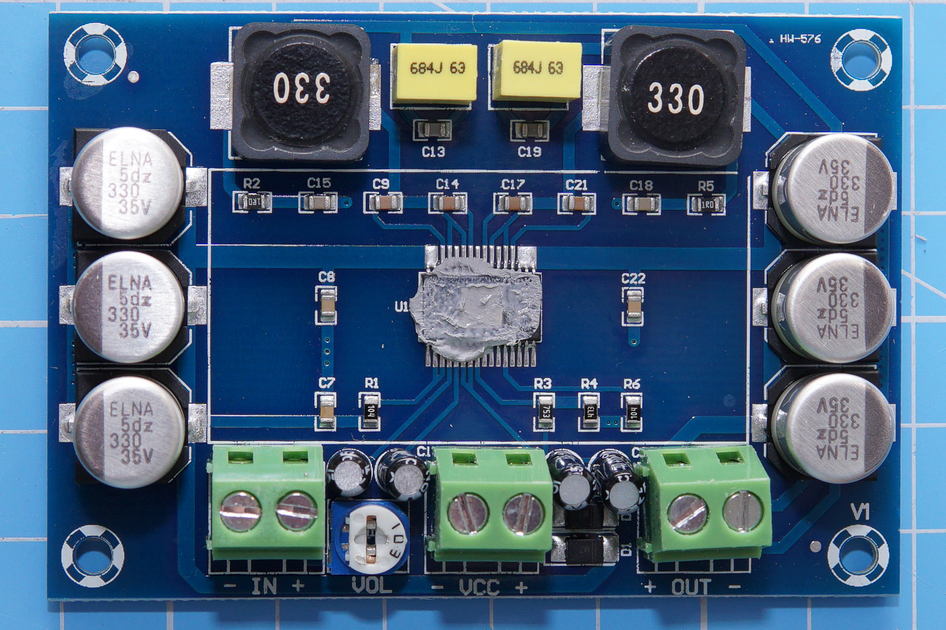

My filter & three of £3.37 amp modules arrived today, much sooner than I was expecting! The thermal adhesive on one of the amp modules failed & the heatsink was loose, so I'll have to reattach that. The solid capacitors are labelled 'Elna' but somehow I doubt they're legit considering the price...
The Sanwu ones have got two screws holding the heatsink on but they are another couple of quid. The screw terminals for audio input look more convenient on these though.
Lots of hiss on these, even after removing the trim on the input 🙁 Suppose I shouldn't've expected much better for the price of a beer, are the more expensive units better in this regard?

If you've got one of those 2.1 pre-amp boards on the way, they help a lot. Also knocking the gain down to 20dB. Have a look at those resistors under the heatsink. There's one on the bottom left and three on the right. If you have a look at section 7.3.1 in the datasheet http://www.ti.com/lit/ds/symlink/tpa3118d2.pdf, see if you can find out what the gain is set to. I had to remove one resistor to get 20dB gain on the Sanwu ones. If you look very closely at the resistors they might have three digits for the values.

I've not tried the filter board yet, as I wanted to test the boards 'unadulterated' first! Luckily the SMD resistors do have legible markings on them, but it's too late where I am to puzzle out which one is which in relation to the datasheet tonight 🙂
It looks like 75k (R3 on this PCB, known as R2 on the datasheet) and 47k (R4 on this PCB, known as R1 on the datasheet), which is 36dB gain in Master mode. If you remove the 75k one it should work as 20dB Master.
This board doesn't look too bad to mod, there's a lot more room between the SMD resistors compared to the Sanwu one. A quick dab with my soldering iron got the SMD resistor off. Soldering another resistor on the Sanwu would be far trickier, but on this board you've got it looks easier. No need for any resistors to go on if 20dB is alright though.
I would say try the filter board first. Should be easy to do with the bare ends from the filter board connector cables into the screw terminals. I had to solder mine onto the underside of the Sanwu PCB.
