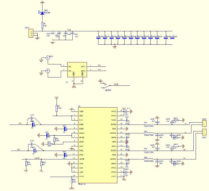

I fix the amplifier by myself. The problem is that the coils are not properly positioned. I have the scheme of Brezze Audio TPA3116d2 amp. But since I did not know where to start. First, I changed all the filters at the output with the same values, but I put original WIMA capacitors,as well as at the entrance. I put on entrance 0.1 400v but I could not find the 4.7 400v to buy, only 4,7 250v. Can someone explain why is this capacitor 400v and which values ​​can put in place of the original.

Can you show me the schematic where to throw the inductor?
Do you think you could change some more changes to the scheme. If you could explain to me, why change and what is the result. How should I best understood. thanks

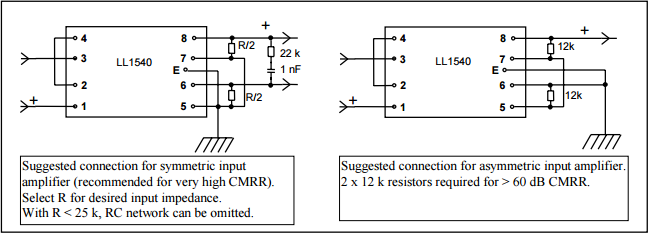

The other thing I plan to try is an RC network between either RCA+ and RCA GND, or between amp input signal+ and signal-. These are hinted at in both the Jensen DS, and also the Lundahl LL1540 datasheet. (Again, I'm not sure what the terms input and output actually mean.)

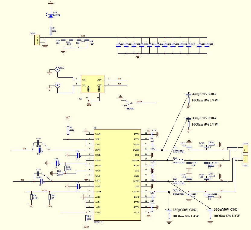

It is replacing LL1, LL2, LL3, and LL4 for inductors and LC32, LC28, LC26, and LC21 for the capacitors. There is a chance that the capacitors and even the inductors are already 22uH and 680pf. Check before replacing.
First thing to do if you want to change the stock amp is to do the "bootstrap snubber" mod which is connecting 4 sets of 330pf 50V C0G capacitor and 10ohm 5% 1/4W resistor as shown in the attachment.
The other is to replace the big electrolytic round capacitors with something with low ESR such as Panasonic's SEPF series capacitors or the like.
These two changes will improve sound quality.

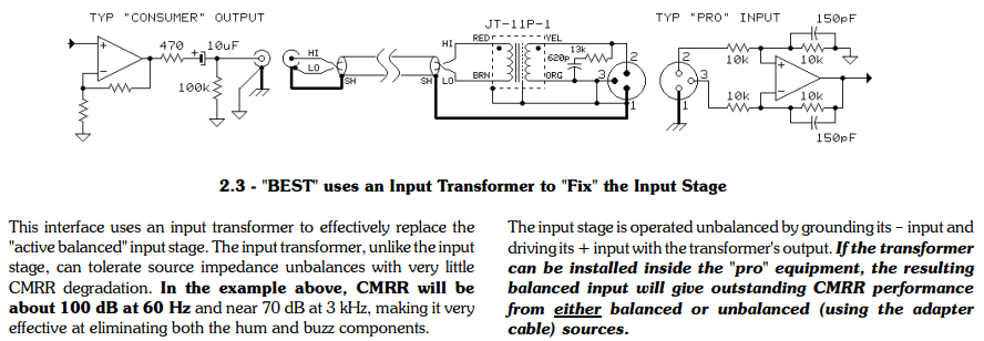

Jesen JT-11P-1 w/DUG-1 continued...
Perhaps I'm a glutton for punishment, but I just swapped those transformers out for a pair of Jensen JT-11P-1 transformers, datasheet here. Now I'm back to having a constant hiss/hum. 😱
I was overlooking some useful documentation on the Jensen website. Their Schematics page and Applicatin Notes page have lots of useful documents.
I found this discussion here on diyAudio, talking more generally about the same application (using transformers for unbalanced to balanced conversion).
One person in that thread suggested the implementation in AS-003, as I alluded to above.
But also suggested was AS060, attached below.
With the Edcors, I was frustrated with a lack of documentation. With the Jensens, I have the opposite problem: too much information! Usually too much info is better than too little, but I lack the knowledge to actually know which docs are relevant here! 😕
Hi Matt,
I'd try this:
Red = RCA+
Brown = RCA GND
Black = chassis ground
White = chassis ground
Yellow = amp input signal+
Orange = amp input signal-
I wonder if your issue has been that the amp chassis has been connected to the transformer case through physical contact, and/or that connecting the black wire to signal ground has coupled noise into the signal path.
Try this and let me know how it goes.

Red = RCA+
Brown = RCA GND
Hi Sharpi31, thanks for the input! I thought I'd try exactly that next, as it doesn't require me to re-solder anything, so it's quick and easy. 🙂
Also, it's a natural path to implementing the schematic in AS060 I posted above, which is exactly what you say, plus 4k99 resistors on each amp input to chassis ground. (Meaning, also really easy to test!)
Good idea, something to check. Though I think it "shouldn't" be the case: the transformer (Antek AS-1220) is wrapped in non-conductive material, and rests on a rubber spacer. The amp boards are mounted on nylon standoffs. Still, wouldn't be the first time I fell victim to a major oversight.
Hopefully you'll be noise and hum free very soon 🙂
Why are you wanting to add the 4K99 resistors from each amp input to chassis ground? You can certainly add resistors from the amp inputs to signal ground to reduce the amplifier input impedance to the optimal level for the transformer (the datasheet suggests 10Kohm), but bear in mind that lowering the amp input impedance may cause issues with your passive volume control. I'd be tempted not to lower the amp input impedance with additional resistors, and instead add the damping network specified in the data sheet for loads >10Kohm.
I still worry that the passive pot before the transformers may cause issues. The transformer datasheet suggests that it's designed to be driven by a low impedance source (<600ohm) but it's possible/likely that the output impedance of your passive pot can be much higher (depending on volume level). I'd use a known low impedance source instead of the passive pot while you're troubleshooting, then swap the pot back in after all is working as it should.
The only reason for the 4k99 to chassis ground was because that's what they're doing in that AS060 document I mentioned above. But now that you mention it, I understand the purpose of those is just to lower impedance. So yes, I agree, those probably don't make any sense here. (If it's not obvious, I'm at a "paint by numbers" skill level here. 😉)
