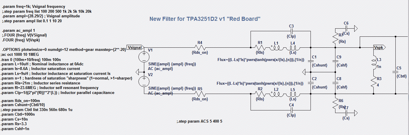

Because of another project i tried the DC-bias cap-modells TDK provide.

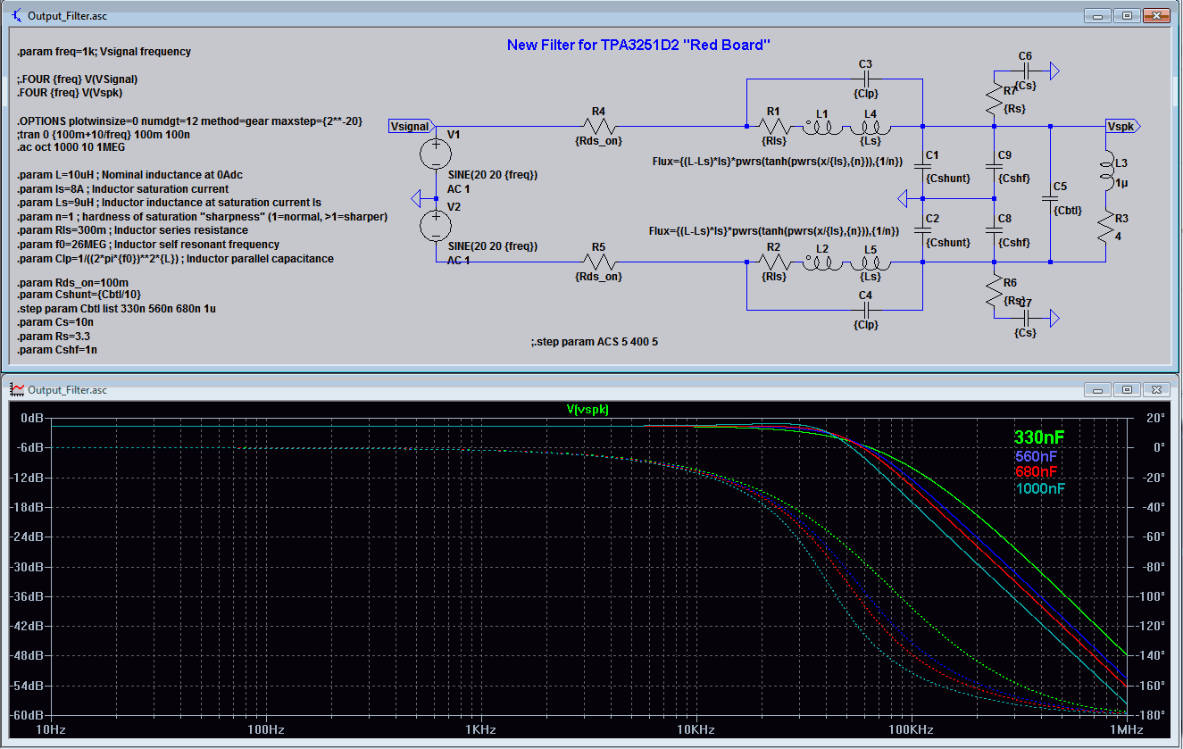

Simulation-setup:
attachment.php
CBTL is substituted with the TDK-capacitor modell. The results were:
attachment.php
This is for 1kHz.

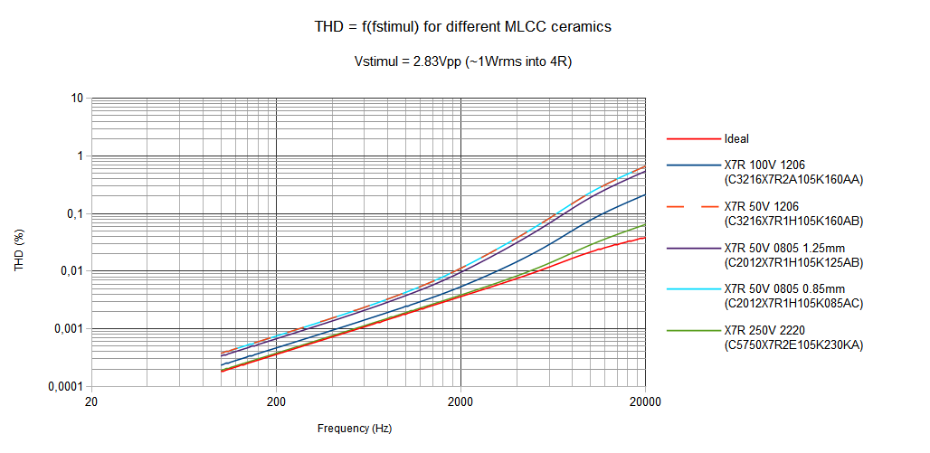

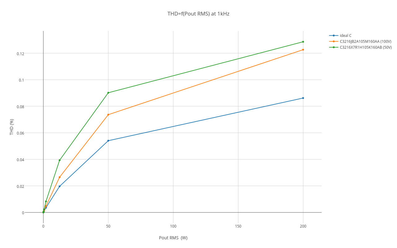

Using just the "ideal-C" will result in different THD as a function of nominal C-value:
attachment.php

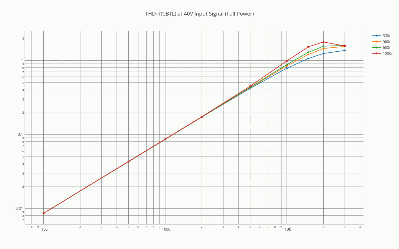

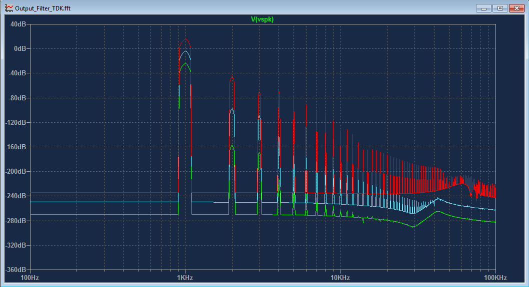

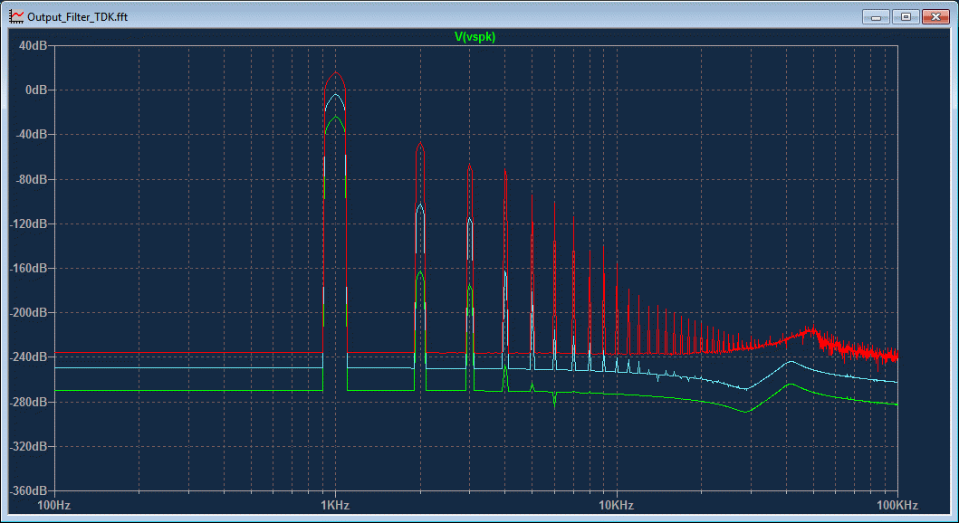

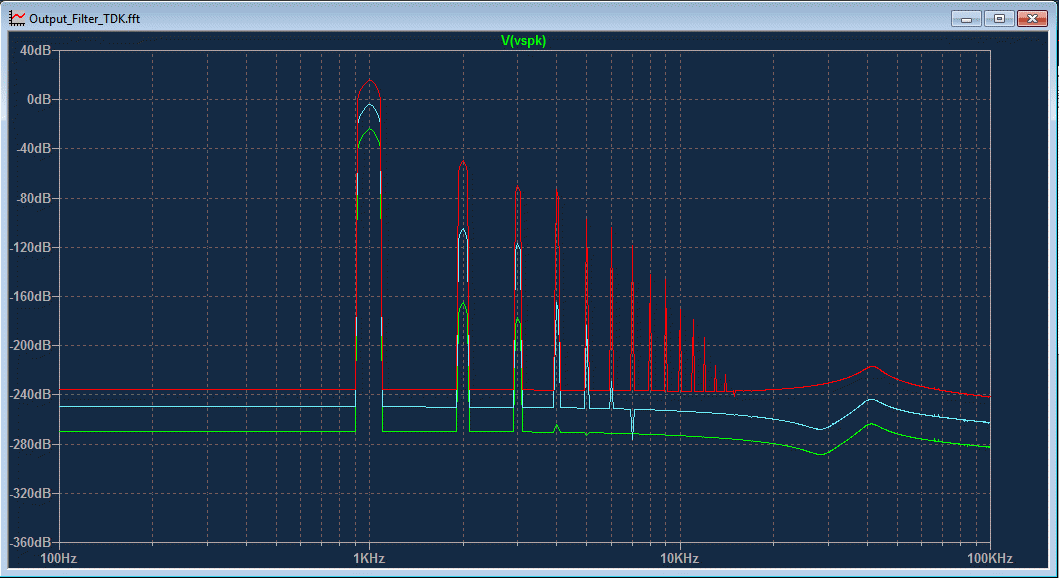

If i'm not completely wrong, the following FFT-plot shows the shift in corner-frequency as a function of dc-bias due to higher input amplitude. Signals are 0.1V (green), 1V (blue), 10V (red). Rload = 4R+47uH.
First, the "ideal C":
attachment.php
Now the 50V X7R 1206 TDK MLCC:
attachment.php
100V X7R 1206 TDK MLCC:
attachment.php

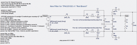

To round this up, here are the results for THD vs. frequency as a function of stimuli-amplitude. Additional THD is introduced by the inductors saturation - so THD performance is to be interpreted relative.
Inductor-parameters are based on "Coilcraft GA3416-CL" with
Lnom=10uH
Isat(10%)=8.6A
Lsat=9uH
Rdc=21mOhm
SRF=23.6Mhz
Test-Circuit:
attachment.php

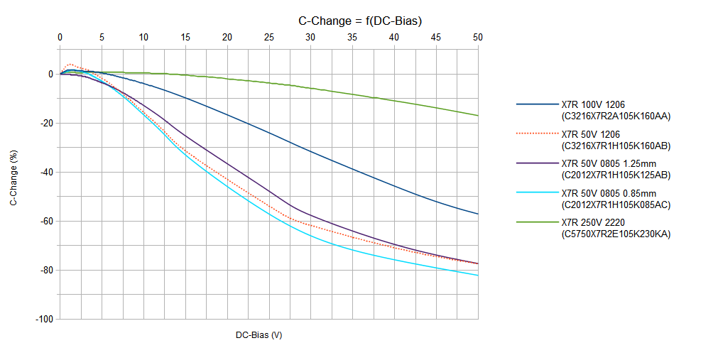

Capacitance change due to DC-Bias (Data provided by TDK):
attachment.php

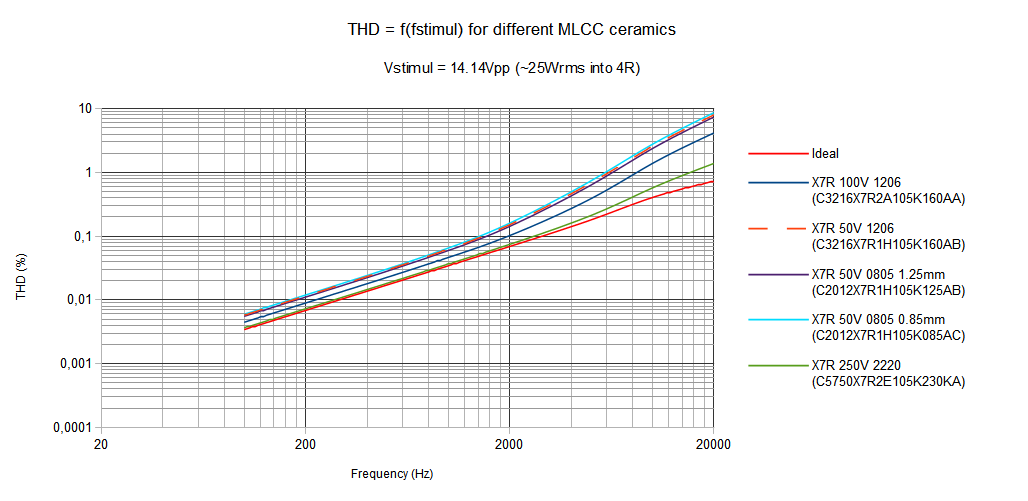

At ~1Wrms into 4R resistive load:
attachment.php
At ~25Wrms into 4R resistive load:
attachment.php
Not shown is the impact of speakers self inductance which makes everything more worse. 🙄
Conclusion: MLCC in output filters do work at the expense of increased THD at higher frequencies. Increasing footprint-volume and high-voltage rating helps to decrease THD.
Inductor saturation will additionally rise THD.
Any comments? 🙂

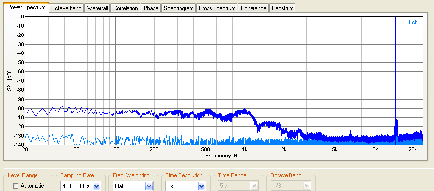

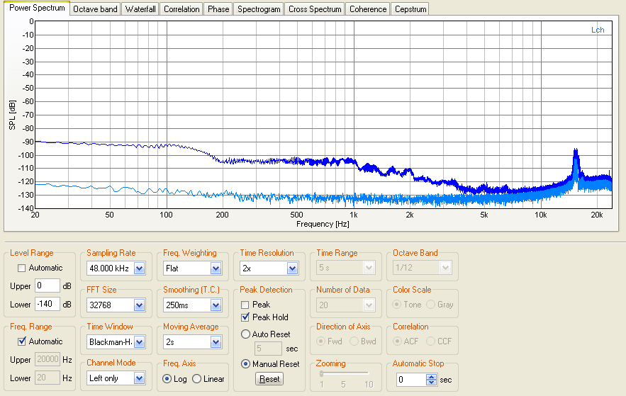

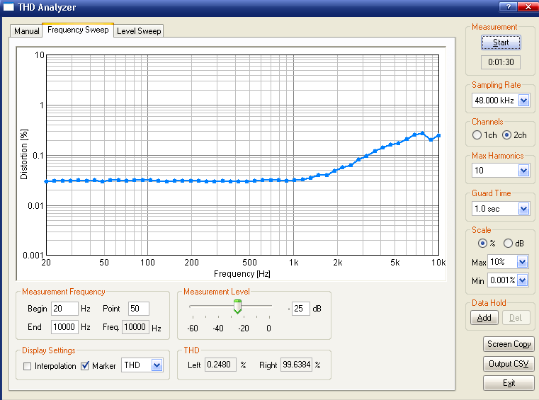

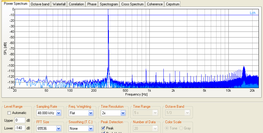

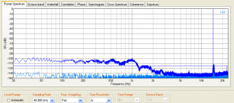

For inputfilter formed with ceramics classII distortion rises also towards 20hz, does that also happen in output?
Well, input is a different story. We haven't seen that rising THD with the TPA3132D2 board when measured performance but a bit of knock sensitivity.
These measurements where done with no load connected to compare the specs with the datasheet.

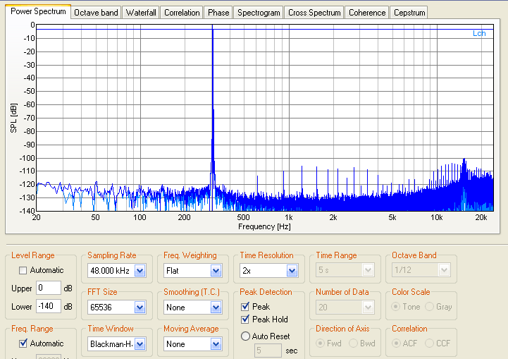

First with 1uF 25V 0805 No-Name X7R ceramic:
FFT 1kHz:
attachment.php
THD vs. frequency:
attachment.php
Knock sensitivity:
attachment.php
Compare this to a 2u2F 25V 0805 Murata MLCC:
FFT 1kHz:
attachment.php
Knock sensitivity:
attachment.php
Bit better (by ~15dB) below 200Hz (knock sensitivity), the question is, will you hear it? (-90dB) Guess not, the speaker itself is doing more THD at this frequencies.
The situations and input and output are a bit different for the caps regarding to current "pumping".
I'll see if i can get a better answer for you. From the simulations, there's no rise in THD at the ouput for low frequencies.
Edit:
The better answer:
Impedance at input and output is different. Where it is rather "high" at the input, it is pretty low at the output. That means, at the input fine characteristics dominate, like dielectric absorbtion, piezoceramic effects, nonlinearities. -> possible influence on low frequencies.
At the output, coarse characteristics dominate like inductance, inner loss due to high current flowing etc.. Relative influences are then only in the high frequencies.
Post-filter feedback would "correct" this.
