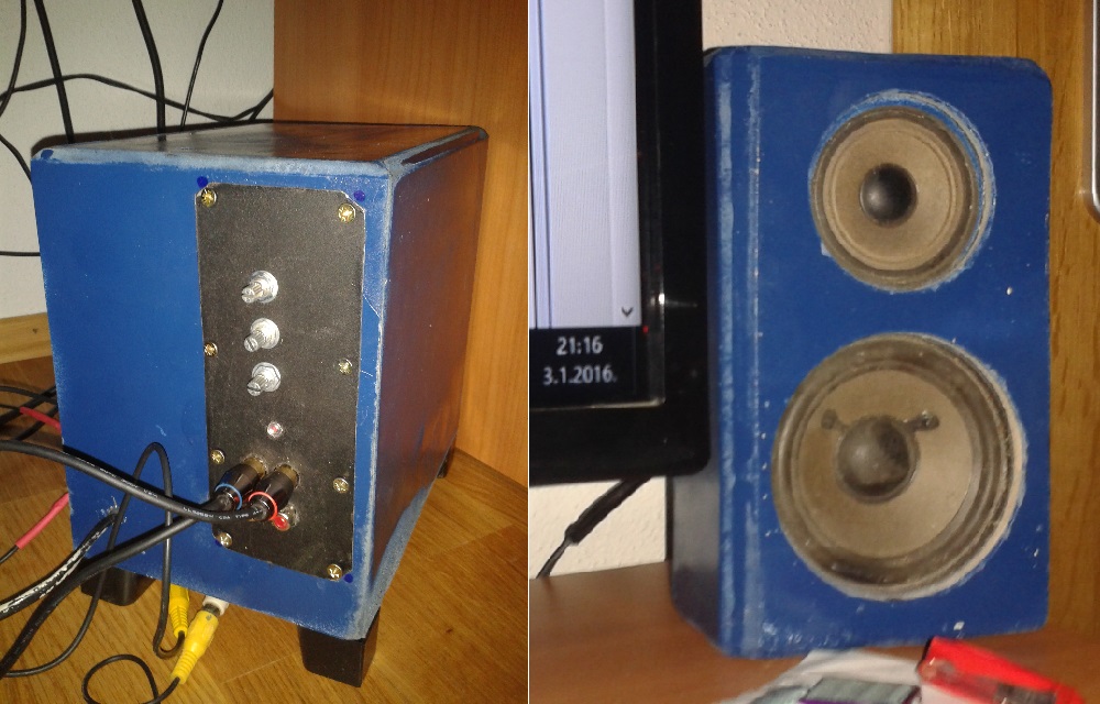

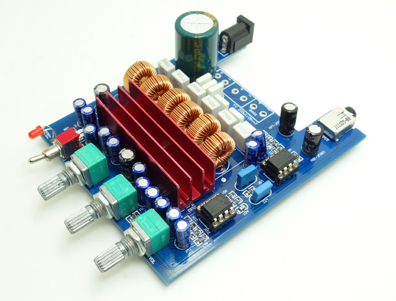

hi , i am using 19v good laptop psu with this board , i put it all in old logitech speaker box and is working fine. but i have problem when pots are in middle position it produces some quiet whining sound has anyone had this problem yet?
sorry if answered before.
