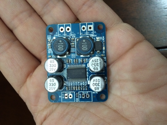

My order of these cute amps just arrived from Aliexpress. Nicely packaged in individual antistatic sealed bag and then bubble wrap.
Thanks to Bughemeiste for the tip.
http://www.aliexpress.com/item/TPA3...oard-1X60W-12V-24V-POWER-AMP/32553840789.html
They look very nicely made, pretty hiqh quality in appearance and layout is tight. Can't get small ceramic decoupler cap or bootstraps any closer. Looks to have a power LED even. Those inductors are pretty small though.
It is printed "Sanwu" on back so I guess we call this Sanwu Blue PBTL.
It is tiny and I can see how these are ideal for integrating internally inside a small speaker. You could stick it anywhere.
I expect them to sound great. 🙂
Hook up tomorrow...

Wow, even smaller than I expected!! Cute too. Looking forward to your comments on these "tiny" things.

I have been really sick past 2 weeks and finally had some energy to go hook them up. I made a nice 4 channel enclosure with 5 way banana binding posts and four RCA inputs. I soldered up speaker out wires to ea amp and RG-174 coax for line ins. It was almost done and I would have had sound today except I am completely out of hook up wire for the power inputs. I will have to order some spools before finishing this. This is going to be another active speaker amp box with a miniDSP so there is a little bit of room. These amps are really easy to hook up. I appreciate solder holes vs terminals when build on a permanent box.
