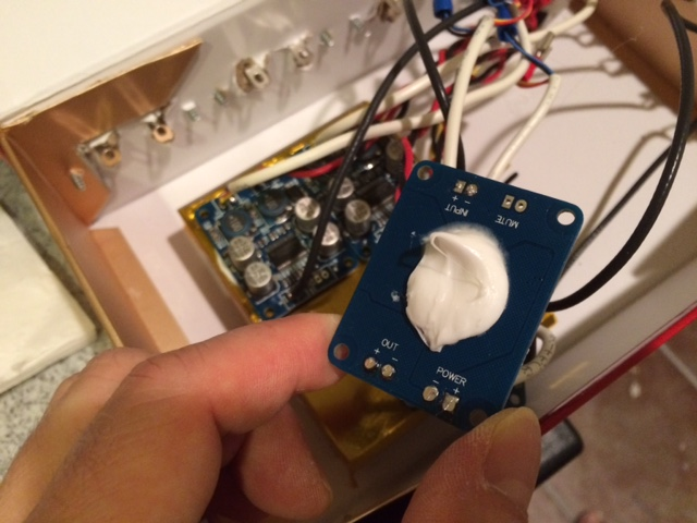

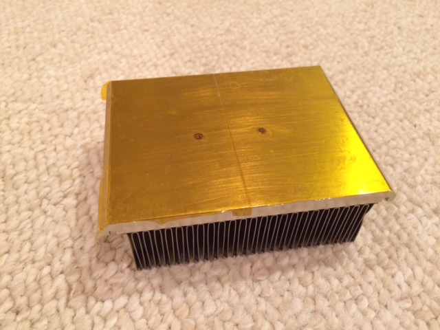

I happened to have a really nice solid copper Pentium CPU heat sink lying around. It is the perfect size match for the footprint of 4 of these Sanwu Blue PBTL amps. I put down a layer of Kapton tape to prevent shorts from solder pins on the bottom. Then added a dollup of RTV silicone. Pressed it in place on heatsink to squash the RTV flat and reduce thickness for higher heat transfer efficiency. Used a few dabs of hot melt glue on corners of PCB and heatsink to hold PCB in place while RTV silicone cures. The final completed amps mounted on this heatsink is way overkill (I think a 1/8in aluminum plate would have worked just fine. I just happened to have this heatsink and it looks cool.
Kapton tape cover:
Apply RTV silicone:

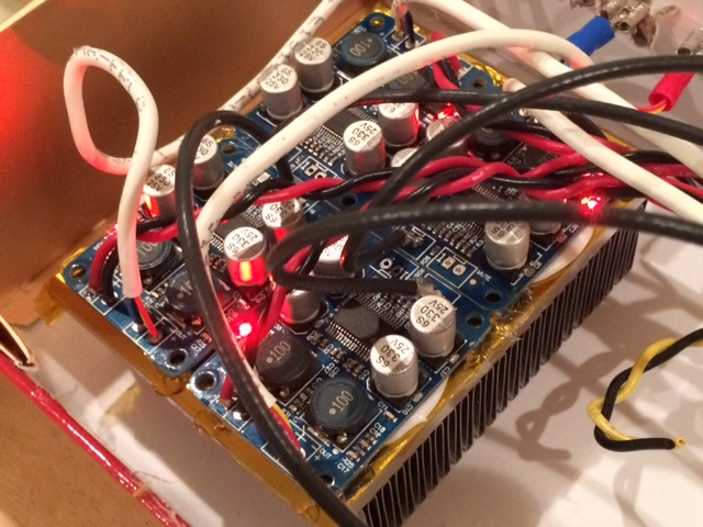

Completed amp with heatsink - almost looks like it was designed for it:
I then put the amp through the stress test using the 5ohm dummy load (50w power resistor). I connected the CD player as source this time rather 1kHz signal generator. I played some music at full volume on the headphone outs of the CD player and fed to the amp input. I measured between 17v and 19.5v on the load resistor and let it play for 5 minutes each again. The resistors got smoking hot, even the ceramic tile they were on was too hot to touch near where the resistors were placed. My fingertip touch test on the amp chip itself showed significantly lower temperature as I could leave my finger on the chip and it felt warm but not hot. I discovered that these amps generate sound - probably piezoelectric effect of all those ceramic caps. You can hear faint music playing from the amp board as all I had was the dummy load. Anyhow the amps were clocking in between 60w and 75w and could run all day with this heat sink I think.

Nice it is master. Why all the heatsinking? You are going to use them to bassEQ small speakers?
It's going to be my new portable 60w/ch active miniDSP rig. I want to have the head room to play loud transients. As it was before it felt too hot for sustained 60w. I also just happened to have this heatsink so it was handy.

How thick is the silicone layer between the board and the heatsink? From the pictures seen the thermal paths resistance is pretty much "not optimal". 😀
Nice build anyway.

I squashed the board down as much as possible so that's why so much oozed out. The thickness is probanly 1mm to 1.5mm. I know it's not optimal but it's better than relying on tiny bare board to act as heat sink. It does not have capability to dissipate 10% of 60w or 6w very well without this RTV to heatsink. The heatsink can be felt to be warm to the touch when amps are running at moderate power so heat transfer is occurring.
I had a thought and maybe just soldering a copper disc stub to the chip vias on the bottom and the connecting that to a conventional aluminum plate heat sink. The nice thing with RTV on entire board is that it helps remove heat from inductors too.
