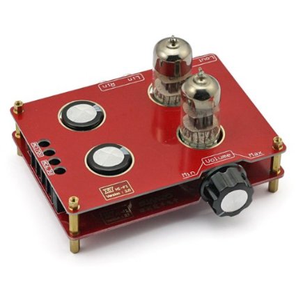

Pity that no one answered your question! I will do my best.
Yes, as with any straight power amplifier, you do have to control the volume somehow. You can do that with an external preamp, or just rig up a volume potentiometer.
I use one of these which is very easy to assemble. Especially if you only use one source or input.
http://www.amazon.com/SainSmart-Ass...=1453142485&sr=8-1&keywords=sain+smart+preamp
I've had very good luck with this two tube Guanzo/Sain Smart one, and it's really inexpensive. The tubes last forever and are easily available. Despite some naysayers on forums I think it sounds excellent.
Like any other amp and preamp situation, you would attach/connect this with RCA cables to the INPUT of each channel of the amplifier.
I'd be happy to help you if you need it.
Mark

Here's a picture of a marriage made in heaven - the Guanzo/Sain Smart paired with the dual chip/Astron. The Sain Smart is a giant killer ( $37 from Amazon ).
