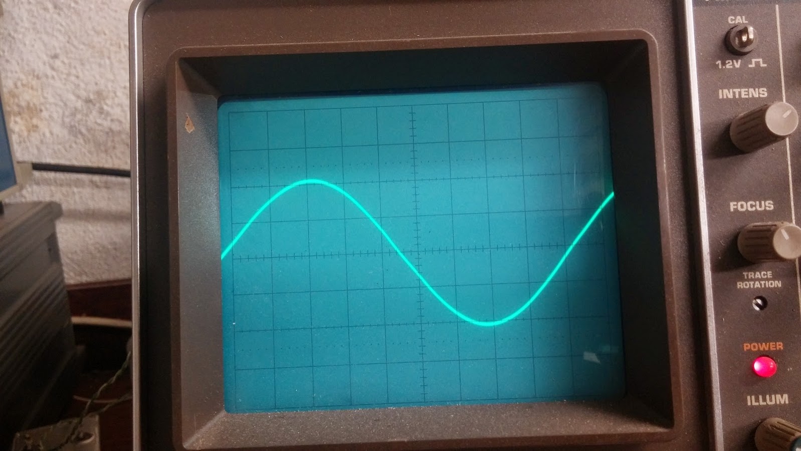

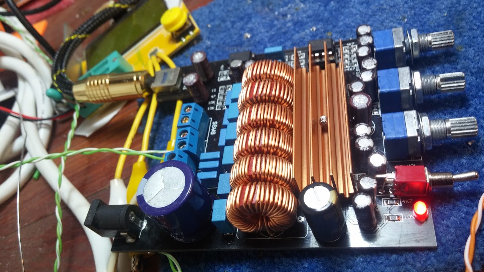

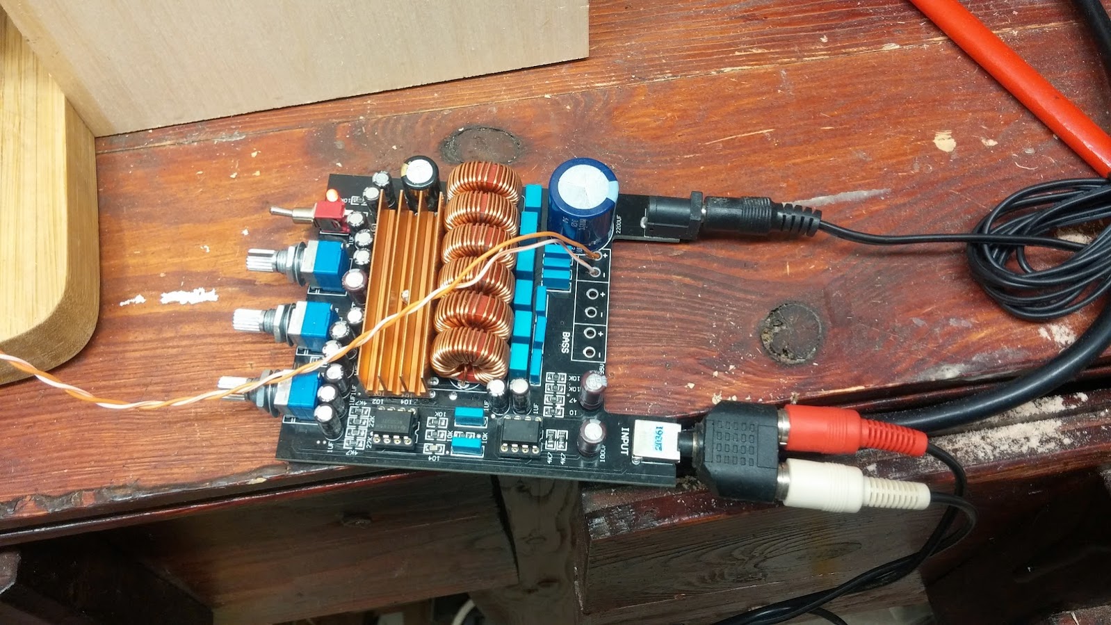

be careful, this amp make some noise, which depend on pot. values...it´s unusable...
Did you try plugging it into a wall socket somewhere else in the house?
Could it be ground loop?
Looks like you are in a workshop. If you have a bunch of electric power tools, etc.. plugged in, it may interfere and cause the noise.
Or, you got a bad board. Happens once a while.

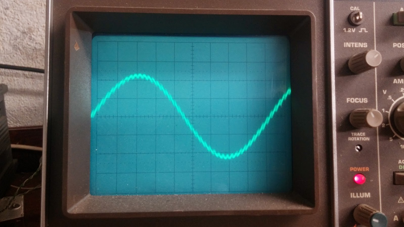

This is no ground loop hum...this is like digital hum... I tried few digital and analog PSU... is special, that hum depend on pot values (is not maximum value).. I´ll try make some measurement...

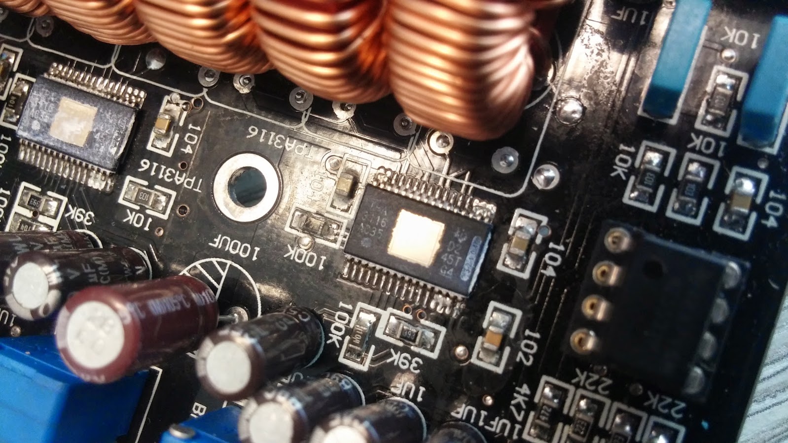

If this is a 2.1 board, there may be an issue with a bad spec on the clock sync between master and slave. As a result the sub slave is free running with no distinct clock pulse. Check resistor and cap values between pins 16 on master and slave.
Also check to see if you have bad connection with bootstrap caps. Sometimes legs get broken or close to broken off due to flex from heavy inductors pushing them in transport.

so, yesterday i did some measurement, but i was stopped by storm, which interrupted electricity... sine with full volume seems to be good, but in the half is there some kind of modulation... next, when i remove both preamp IO its still there.. sync between chips is OK, there is 10k resistor...
synch isn't ok if it is tried with 10k/1nF, should be 4k7/47pF according to TI september 2013, they just forget to update datasheet for some reason

let´s continue, I already changed sync 4k7/47pF, but without impact on output noise...what i observe, that noise is changing, when I touching coils...(there is no bad connection).. so I will order some different.. any suggestions for 2.1 ?
I don't know if touching laquered wire coil should be inaudible? Looking at picture I do get impression that bass amplifier is actually the master amp and the stereo channels are the slave on this board, so getting 400khz operation for stereo instead of 100khz could be an improvement. 32dB gainsetting needs 400mv for full output? The 5532's are only for filtering bass channel?
I don't know which exact schematic they using...there is some no simple problem and I will buy some different module...maybe when I will have more time I will continue with repair...
