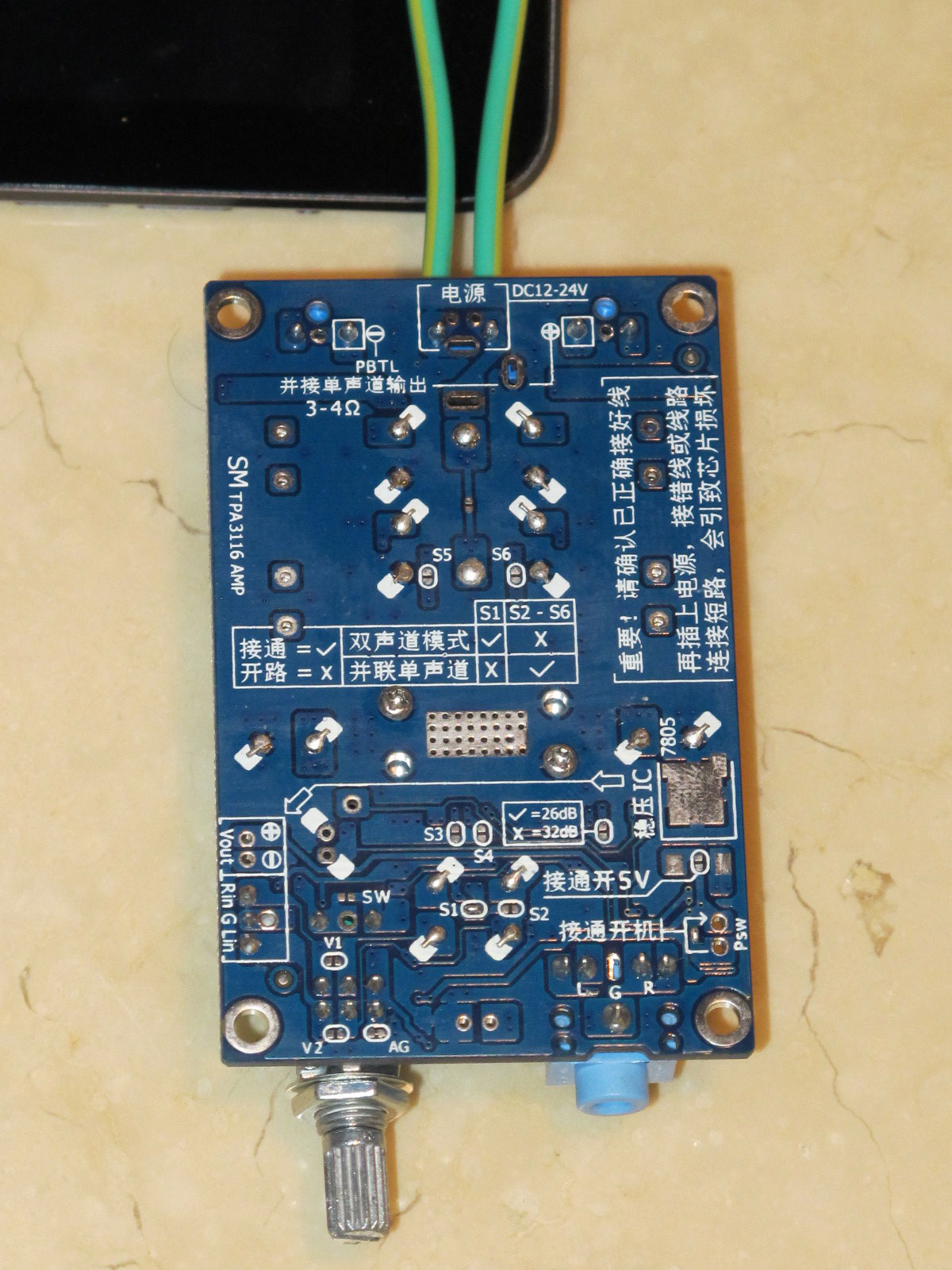

My board just arrived.
It is slightly different from yours, not by much though.
I hooked it up quickly, no pop, no hiss.
Xiongzhi's GSK JZ is supposed to be low esr, that is the green one in some pics. Boards seem produced with the black Xiongzhi GSK JH, who knows the chinese sellers might find that low esr too, but could also be cheapest general purpose capacitor they could find and that does make sense too. Then we assume Taiwan GSK are equal to Xiongzhi's GSK, both we don't have any data on LOL and China could even produce fake Xiongzhi GSK capacitors just because they produced the wrap foil and operator let it run for 1 minute longer to sell foil to his neighbour who produces GSK's in his living room, picking up capacitors from dumpcontainers near productionfacilities. It is like making an assumption not having any data on Feastrex speaker that it will be constant 4 ohms. Or having an unmarked "Panasonic" cap and saying lets pick FM datasheet to have data to use. It will tell you FM capacitor is indeed ok, like the CapXon could be ok, CapXon isn't mentioned too often on bad cap posts on the web.

I'm using my modified Blue/black board from yj. Ordered another one. I'm planning to use them in pbtl mode with differential input. I have a spare lambda dual 24v output smps at hand. Can I drive both mono boards with this one? According to smps specs max current output is 4.5A. If this approach is not logical I'll build a linear supply with dual secondary toroid xformer.
DJ le Roi; just from looking at the picture the high value inductors would indicate that the amp is designed for 8ohm+ speakers. Also I dont like that the power caps are that far from the amp chips and that close to the audio input side either. I would guess that the amp has a lot of hiss/white noise because of that. I guess you could use it of <87db speakers and for far field listening perhaps.. Sorry for my not so positive opinions cause it really is cheap!
