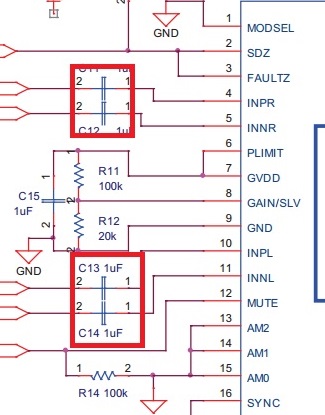

If rightside is bass amp that seems master on that 2.1 board, for synch they filter befor pcbtrace to slave then, so looks like they maybe got confused by datasheet gainsetting chapter??? I did switch these resistors soldering my first 3116 ampboard too but maybe that is reason I seem to see mixed master/slave gainsetting on your pic that might not be real LOL

I modded two YJ blue black board as a pbtl. Removed left caps and tied solder pads to ground. Replaced power caps with 220uf silmics.. Input caps are 1.5uf ESA. Both pcb has snubber mod.
When I power up the boards, there was a distorted sound. Disconnected immediately. I power up boards with 19v 6.3A laptop brick.
Before modding both boards was working properly. I checked my work step by step.. Couldn't find anything. Any idea?
