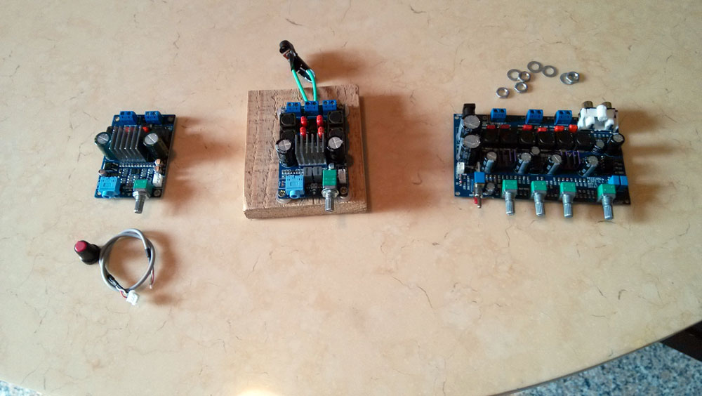

I received some new toys to play with today! 🙂
