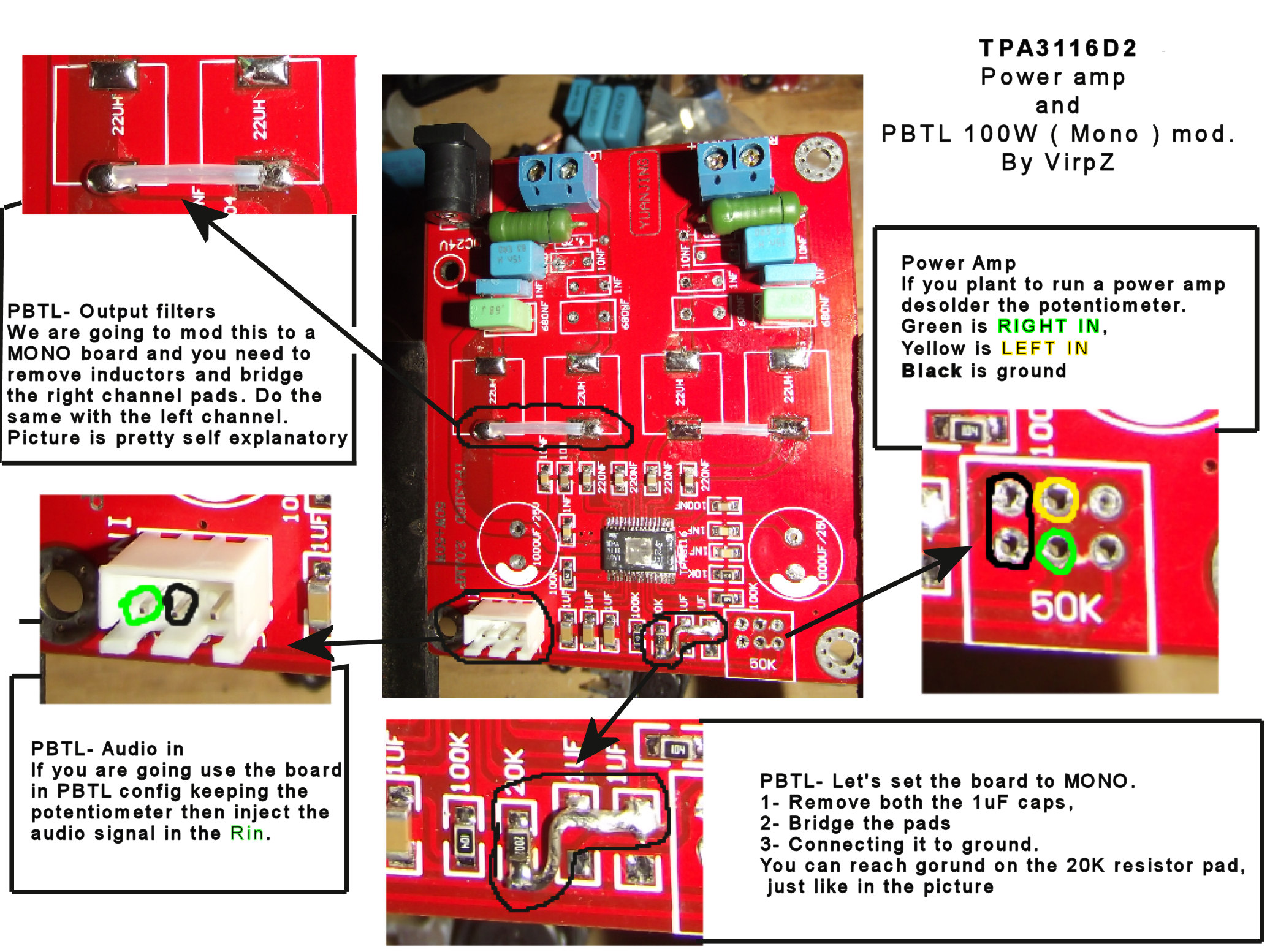

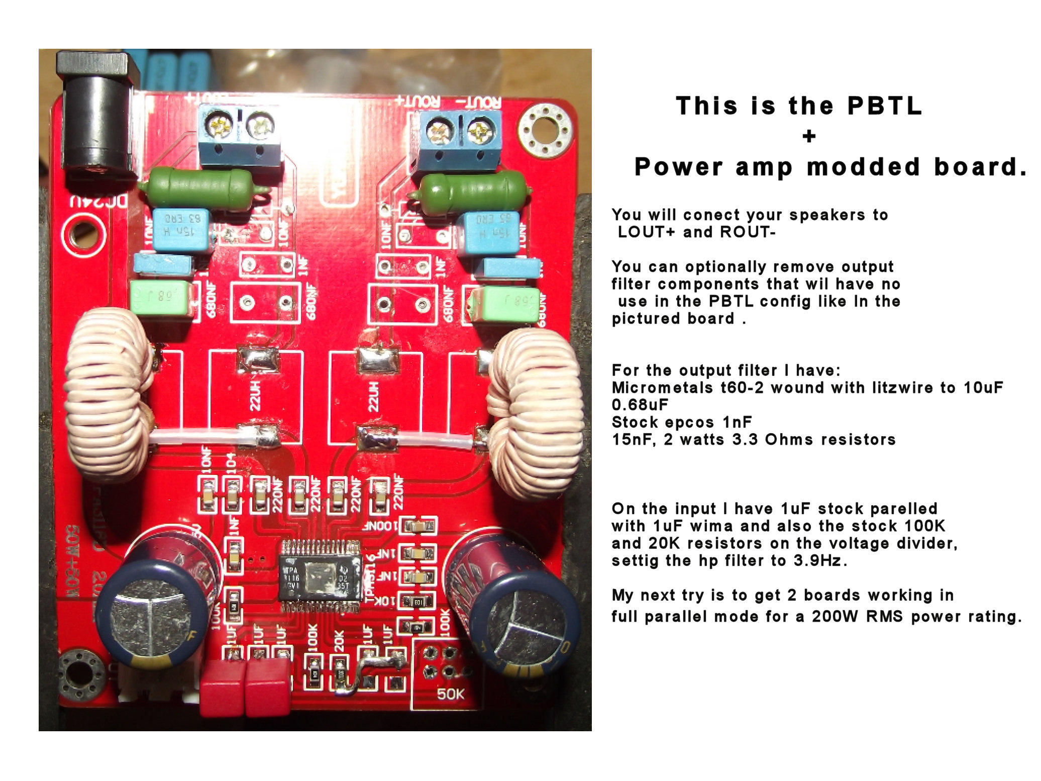

praise the lord!!!!
i got the pbtl-mode running.
i somehow wrecked the 20k-smd-resistor on the input side while soldering a bridge to it.
my unbelievable soldering skills make it possible to transform a 20k resistor into 1,5M.

I have seem many requests on how to put the tpa3116D2 to work in PBTL and so there you go.
Having in mind that with this board we don't have the proper reference for components I am open to any questions you may have.
