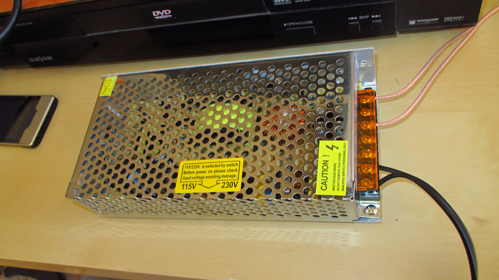

My amps haven't arrived yet, but the power supplies did! So, a short review.
These were being sold as "24V LED Switching Power Supply", usually found in Ebay, Aliexpress and other similar sites. The best price I found was on Aliexpress with seller discount, they cost a littler over USD 14 each, including >USD 2 for shipping (probably north american/european buyers will get even cheaper shipping).
They are rated 24V/5A. At this price, I don't think there is anything more cost effective for TPA3116 amplifiers.
Protected by a sheet of foam and a thin white cardboard box, both arrived with a small dent. One can be seen on the photo. I don't even blame the seller, as I am pretty sure this was due to brazilian post office poor handling: there is no care at all (if you ever send something valuable here, please spend a bit on a secure packaging).
Two sides of the case are perforated aluminum, and the other two are solid. The case is nice looking, many DIYers would like to use there on amplifier projects. And at this price, it is surprising to simply having a case. There is a amber-ish translucid plastic cover on the connection terminals (those being AC in, Earth, and two sets of outputs) which can be lifted. I think it's a good shorting protection, but it may be a hassle for lovers of oversized gauge/insulation wiring. Also, a green LED indicates power on, a 110-220V switch and a small pot regulates the output voltage. And it's lightweigth. If you think weight equals quality, you won't have peace of mind when using this.
I have not opened it, but the AC part comes with 2x 220uF/250V capacitors, and the output with 5x 470uF/35V Nichicon labeled capacitors-most likely fakes. In this regard, I am thinking about purchasing a few of those 10.000uF Nover capacitors, something between two to five per amplifier. Any advice?
And so I decided to measure and test them. Both turned on, so no DOA. I hope they turn out to be reliable. They make some noise when turning the potentiometer, I have no idea why. And for measurements:
Unit 1:
Low voltage: 15.5±0.1V
High voltage: 27.4±0.1V
Unit 2:
Low voltage: 16.7±0.1V
High voltage: 28.0±0.1V
Yes, quite poor consistency, regarding the extremes. Well, if you look at the rated 24V, it is good. Either way, it can be used for a myriad of projects, so this pot is quite handy.
They can be easily set to 26V, so you can get get the last bit of juice from the 3116. I don't know how safe the chip is against overvoltage, so some criteria is important. I've heard of SMPS going over the desired voltages under normal operation, so a safe margin could be important.
Just $0.02, but I hope the information helps.

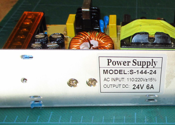

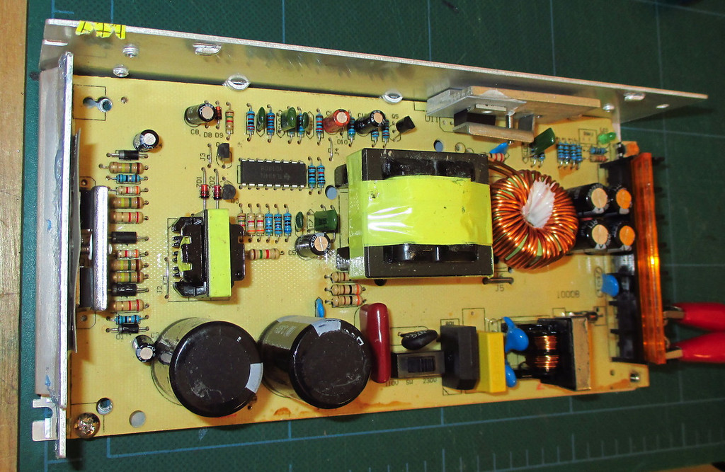

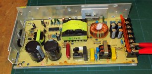

I have one of those as well.
Here are some pics of the internals.
Mine measured 15.9 - 27.2 VDC.
It came set for 230V so I had to flip the switch for 110V.
Wasn't expecting too much from it based on the parts and build quality but I tried it on a TPA3116 set at 24.5V and it actually sounded decent.

I've noticed it's a passive cooling system ye? Does it get any warm? I'm wondering if it can stay inside a subwoofer, it's vented though 🙂
Maybe adding more capacitance will set the over-current protection off.
Would be nice to have a soft-switch and some temperature protection to the psu+amp.
cheers

I have not used it in working conditions, so can't say for sure. It should get warm, but since it wouldn't be near output limits, hopefuly not too warm.
I don't know about a soft start, it's not that much capacitance. Time will tell, eventually.
Most likely it can be placed inside a box. But I prefer to keep electronics and speakers separated. Personal preference, really.

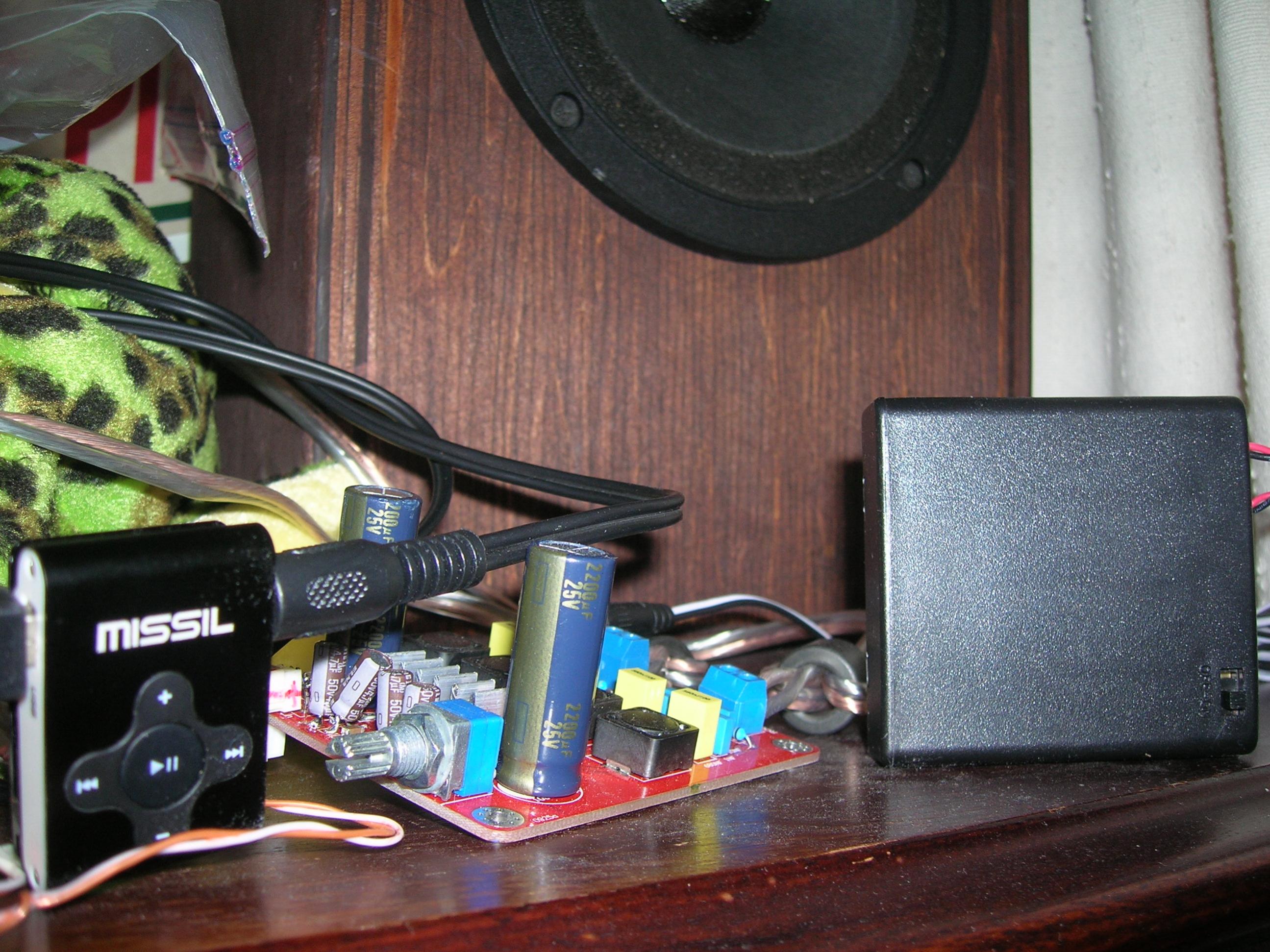

Great find at the local e store ... a 4x AA box with switch and wire! I'm good to go!😉
Yep, it runs off 4 rechargeables for ~6.5V (my 3110 didn't)... and runs for a while ... this one's been playing low volume Satriani 300kCBR off a Missle MP3 into some Audax PR170MOs for days! 😱

I'd ordered one of the basic 2 channel YuanJing TPA3116 amps nearly a month ago to check it out - though it took ages to arrive (while I was waiting I also ordered one of the TDA7297 amps because... at $6 why not?!).
Anyway, I have dropped it in my active system doing high frequency amp duties. Just running in the last hour so not much listening impressions yet but sounding good soo far!
