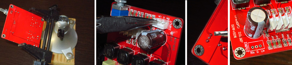

That 3 pin adaptor at the input was a pain in the butt to remove. I was trying to look for a connector for it but could not find any.
Here's a quick and easy way to remove this type of connector if you don't need to keep it in one piece. It takes less than a minute and works really well.
1. Stabilize the board with a vice or clamp.
2. Grab one of the pins on the top of the board with your needle nose pliers.
3. Heat the pin on the back side of the board with your soldering iron and gently remove the pin with the pliers.
4. rinse and repeat :)

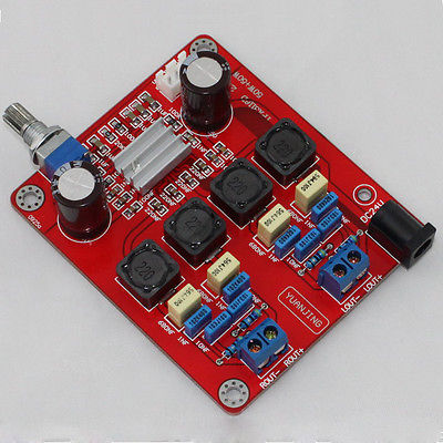

Hello everyone,
Well, my TPA3116 arrived today. Just like the one in the attached photo.
Sounds great, even with a less than optimal 1.5 amp (it calls for 2 amp) 24VDC supply! (My 2 amp Meanwell type supply is on loan at the moment to my brother-in-law.)
Question: If I were to purchase another Meanwell, could I, and should I get one even greater than 2 amps?

Thanks fellows!
Thanks for the confirmation Tubelab. I was thinking I could go higher than the 2 amps.
Lo Tse, thanks for the link to the FastTech site. I bought that power supply! I didn't even know about FastTech; so that's great.

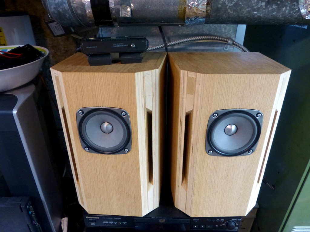

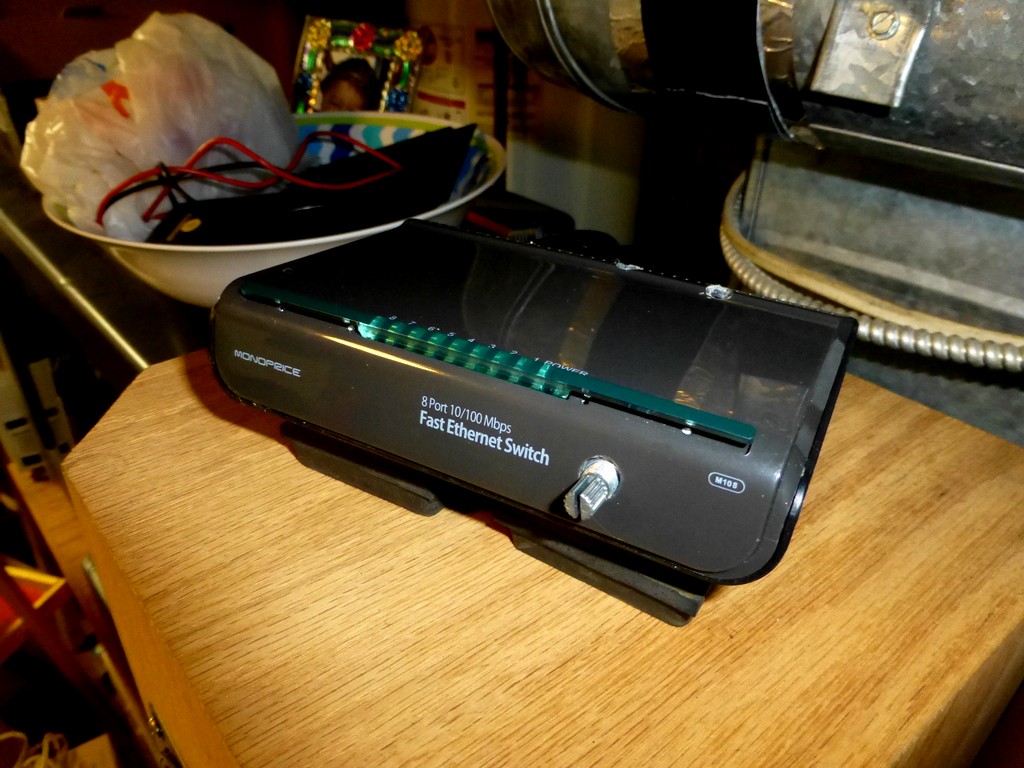

Ghetto Blastin' of a different kind

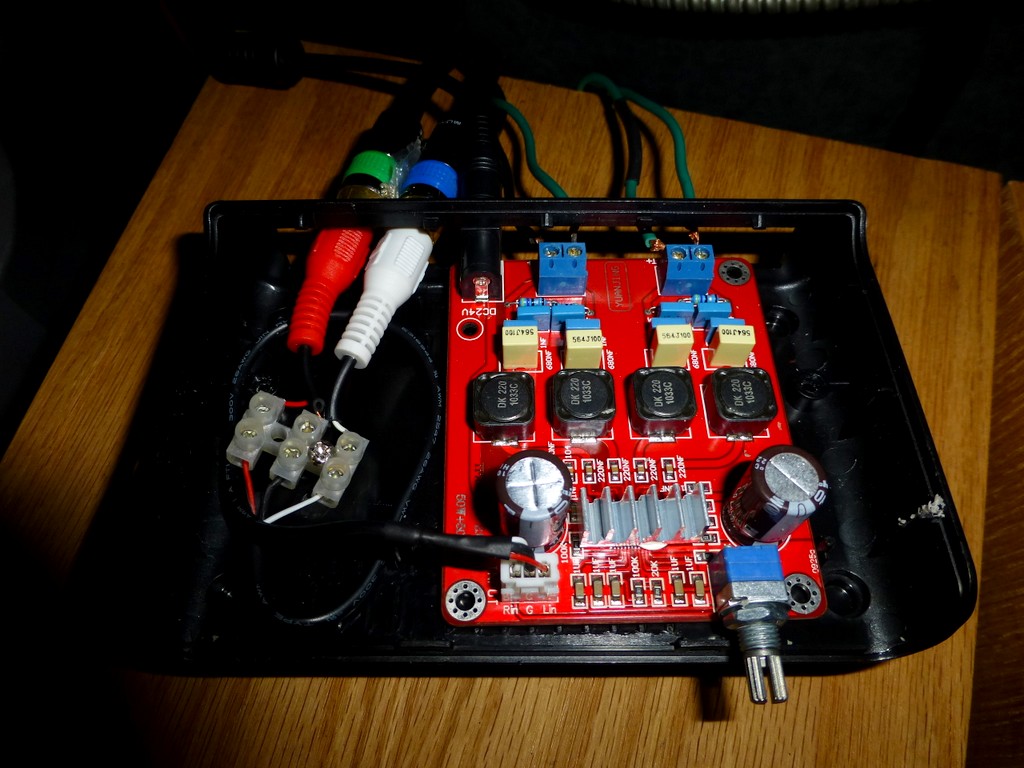

I couldn't stand waiting any longer and stuffed my 2-channel board inside a dead Monoprice Ethernet switch this morning. :D No soldering needed.
This thing sounds fantastic! Easily better than the TA2024 amps I've used with my Fonken-like basement speakers. 20V seems to sound a bit better than 12V.
Now if only I could feel ok about showing off this junk in the livable area of the house... :D
I gotta get me a real chassis.

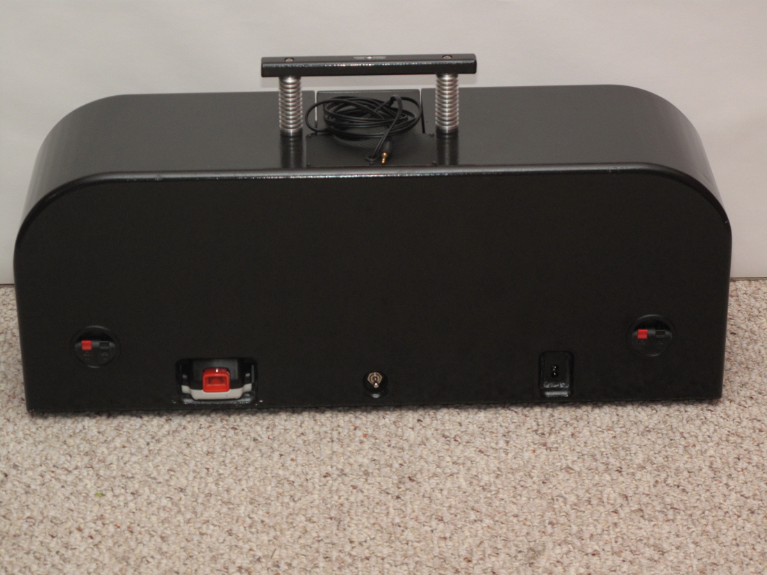

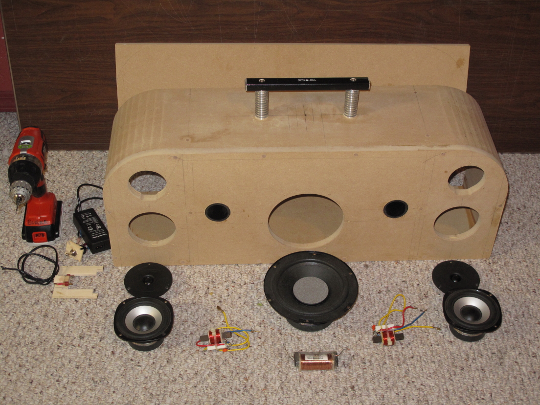

I hate to leave things hanging, so here is that finished boom box with that full chassis version I mentioned. Second attempt at kerfing. Turned out not to shabby... and sounds PDG! ;)

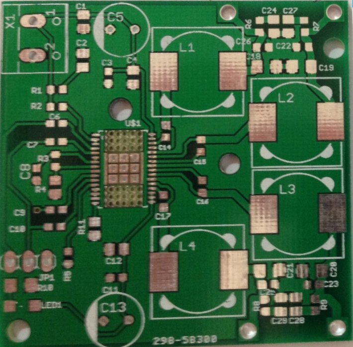

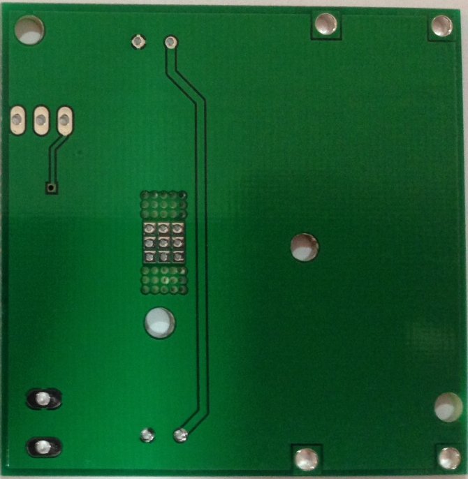

My boards arrived!!!
I just picked up my boards from the postman, I hope I can try them soon... And see if my design works well... Its my first pcb layout design... I hope it works well!!!...
As I said... Once I try it, if it works fine, I will upload the whole project info... Included a boom list, Eagle files and gerbers.
