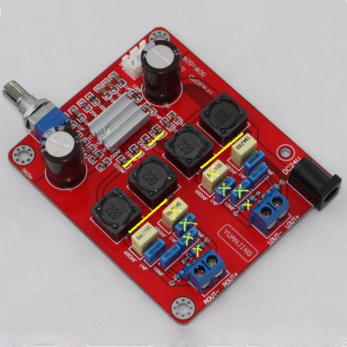

i don't get the pbtl-mode running.
this is what i tried:
took an old 3.5mm-connector.
soldered 10k resistors onto th r+ and l+.
connected r+ and l+ to have a mono output from my pc.
cut off the 4th pin of a 4-port-connector to have another fitting 3-pin-connector.
connected the l and the g together with the ground of the previously soldered mono-output.
when i try connect rout+ and rout- for the bridged out+ and the lout+ and lout- for the bridged (as shown in the datasheet) i only hear ****.
when i connect rout+ and lout- as the mono output of the amp it sounds good.
but i cannot really if it is pbtl'ed....
Are you connecting both L-in and L+in of the board to ground or both L-in and L+in of the IC to ground?
when asking how pbtl is entered with the yj-board everybody points towards the datasheet.
i try to ask the right question:
has anybody successfully pbtl'ed his yj-board and can provide info on how it is done?
Yes and I looked at the data sheet...very straightforward.
I would use different inductors than the one I originally used in the pix...they were starting to get warm.
I only tested it briefly with 8R speaker...sounded OK.

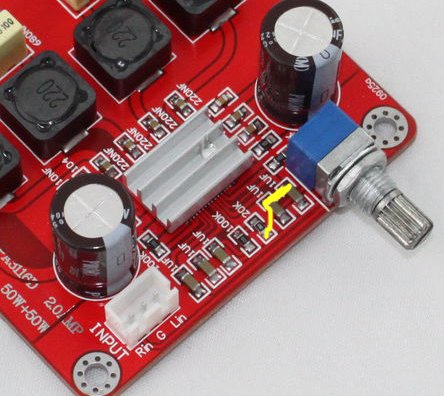

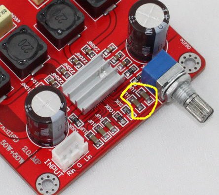

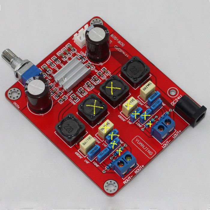

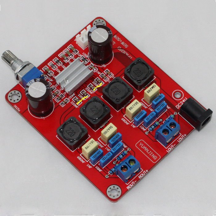

It seems that what you want it that someone tells you exactly what to do... When people tells you to look at the datasheet its because the answer of how to do it, its there...
I cant try it becouse I dont have any single TPA3116 YJ board, what I have its the 2.1 board, but I want it like that so, I wont mess with it... but following the datasheet I would say that, what you have to do is:
INPUT
1- Desolder the 1uF caps that you have just at the front of the IC beside the pot.
2- Solder the closest to the IC solder mask of the two capacitor you took away together, and then to the 20K resistor that its on the left.
3- Use Rin pin for the + and G for the - or ground, dont connect anything to Lin,
What you do with this its connect the INPL and INNL pins to ground to make the IC going PBTL. That would be the input side... then you have to modify the whole output side...
OUTPUT
1- Solder the inside 220nf caps to the outside ones like in the pic.
2- Remove the components with a yellow cross.
3- conect to LOUT+ the + of the speaker and ROUT- to the - of the speaker.
I think that would work.... please correct me if Im wrong.

"I think that would work.... please correct me if Im wrong. "
Yes, but...
The inductors should be replaced with ones rated for higher current.
Or
Do not remove the inductors and connect as shown in jpg.
