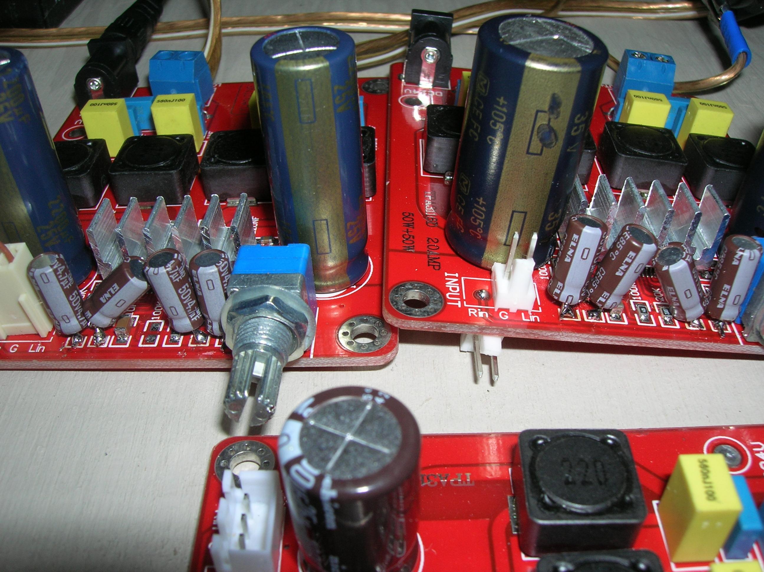

Replaced the PS caps with Pan FC 2200uf/25V (tweet) and 2200uf/35 (woof) and swapped the surface mount coupling caps with Silmic2 4.7uf (tweet) and 10uf (woof)
If Silmic2 are good enough for Nelson, they're good enough for me! ;)

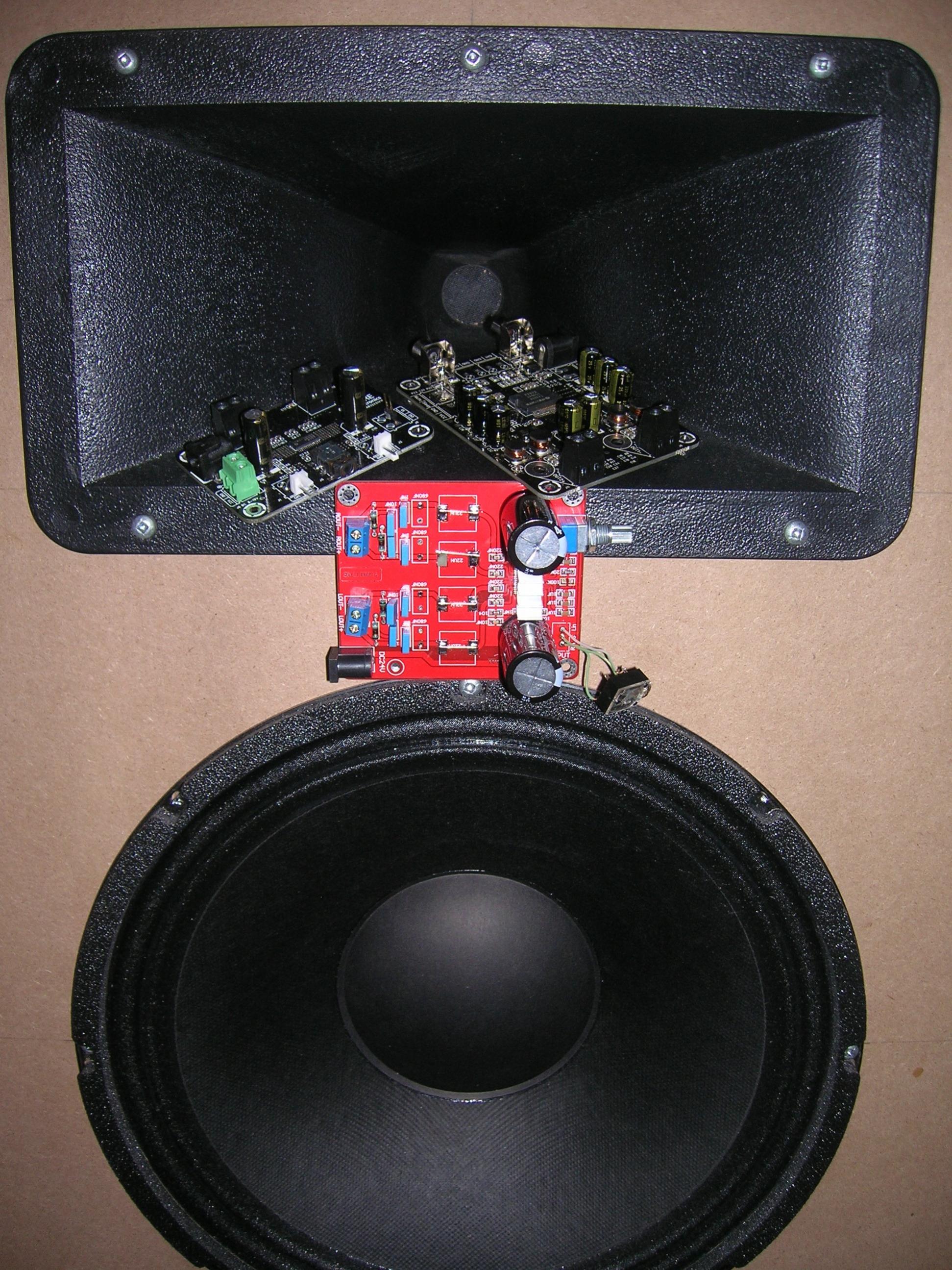

Having lots of fun with my miniDSP and the digi amps. The 3116 board is great because both gain setting resistors are available (not like the Sure 3110 with only one) and you can just remove the 100k (R1) to decrease the gain from 26 to 20 dB (and increase the input impedance from 15k to 60 k)
Davids and Goliath!
:cool:
I removed the 100k R1 on the tweet amp to reduce it to 20dB and left the woof amp at 26dB to take some of the gain compensation away from the DSP.
Just a bit of hiss with my ear to the PSD2002 on Wayne's 3Pi's (with horn >100dB!), but ... nothing at the listening chair! Nice! :shhh:

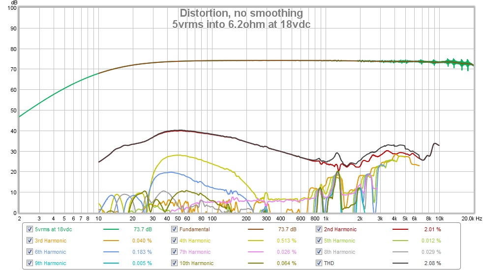

it's hard to measure the actual thd because the tpa3116 output is bridged. and since i don't have access to an isolated scope here's the rough and dirty measurement to the positive output, grounded to the board ground.
soundcard loopback:
powered by a cheap 0.7A 12v smps:
can't expect much. it is a cheap 12v adapter that comes with my wireless router.
board is a stock yuanjing tpa3116. probably not enough current causing clipping during test.
moving on to my dual tracking bench power supply. the images are probably self explanatory.
stopped at 8.3vrms since it's nearly clipping the soundcard input. changing the voltage divider will cause different distortion figures compared to the rest of the measurement.
i'm using 10:1 divider for all the results above.
8.3vrms into 6.2 ohm bridged is about 22w and the PS shows a current draw of more than 2A.
if anybody have any clever suggestion how to properly measure the THD of the bridged channel i'm all ears. doing a summing opamp is indeed a way, but i need to match the resistor and i need to build the circuit. i'm not that hardworking.
