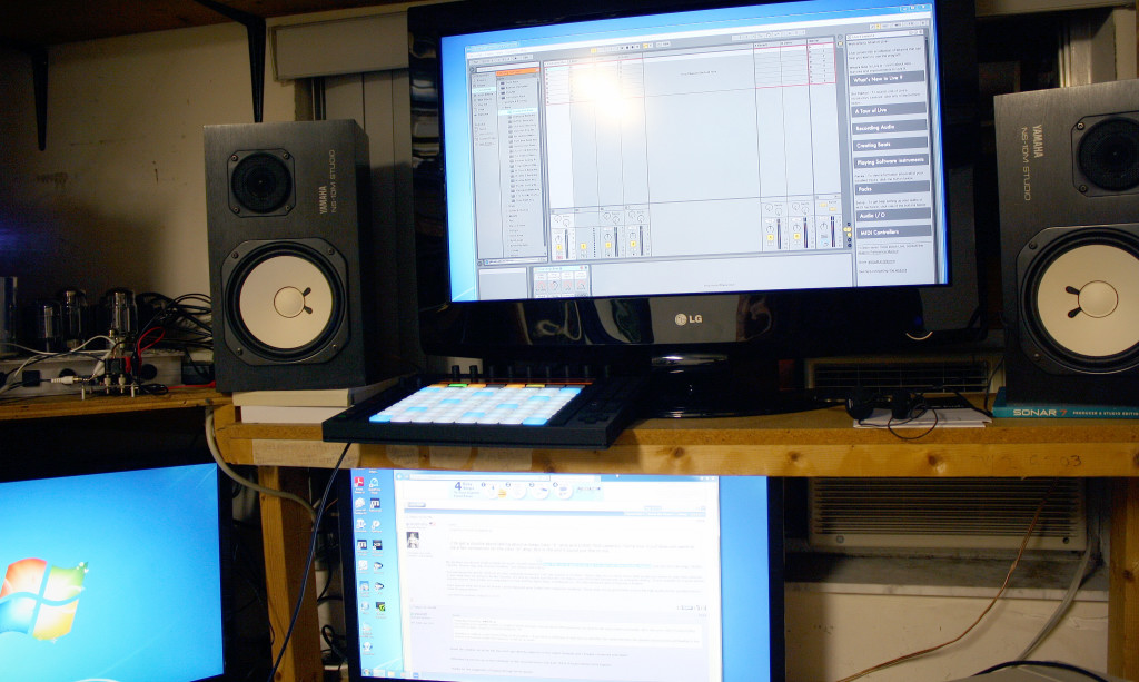

Obviously I have a bias to my old friend the SSE which has been connected into my studio/lab system for almost 8 years. The system has evolved over time, and dozens of amps have come and gone, but SSE number 1 (the first one ever made) has remained. I have a Technics turntable that I bought new in 1978, a Toshiba DVD player that also plays CD's, and a Haswell based PC that is a media center, recording studio, and DAW (Digital Audio Workstation) and a small Samson mixer to tie it all together and provide inputs for guitars and mics.
The Yamaha studio monitors have been here for 10+ years. There is a cheap Polk powered subwoofer (10 inch 50 watts) behind the computer monitor on the left pointed backwards at the corner of the room. This is done primarily to avoid rattling the monitor to death and the cheap sub seems to sound better this way. Loud EDM will cause the sub to distort before the SSE. The Yamahas die at about 80 Hz, so the sub is set to go from 100 Hz down to "32 Hz". I am in the process of rearranging the studio/lab so the FH3 horn speakers are not present here yet, nor are the DIY "loudboxes" that I use for playing guitar.
I use a mediocre laptop for a mobile DAW, along with a Lepai 2020 T amp and the pair of loudboxes all run from a boat battery. Two weeks ago I had this system set up at an outdoor ham radio show connected to a Roland keyboard. I have plans to build a portable DJ/DAW "boombox" that runs on battery power for these situations. A friend from work came by and told me that he had several TI evaluation boards that I could play with so I went to see him. I got to test a TI 3116 board, and saw it make big power in the lab at work, but didn't hear it. I had to give that one back, but I did get a 3100 board to take home.

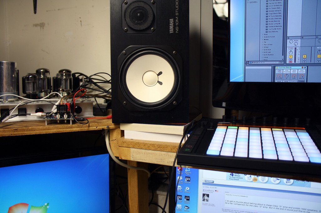

So what should I do????? Well I think I should compare it to the SSE!

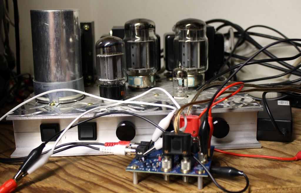

I disconnected the SSE and wired the TI 3100 board in its place leaving everything else the same. I had to flip the "phase" switch on the sub to make it work. I tried powering the board from a Sorensen bench power supply that can be adjusted from 0 to 25 volts and will put out up to 5 amps. I also tried the 19 volt laptop brick from the mediocre HP laptop rated for 3.5 amps.
The SSE runs triode wired KT88's for about 8 WPC. It weighs about 20 pounds and draws about 120 watts to make 16 watts of audio. It burns those 120 watts all the time, even when no music is playing. The TI board makes more power if you turn up the B+ voltage. I liked it best with the power supply maxed at 25 volts. It idles at less than a watt of power consumption, and consumes about 10% more power than it puts out. The SSE measures at about 1% distortion at 5 watts. The TI board measures 0.11%.
Listening tests at low volume levels didn't reveal a clear winner. The amps sounded quite similar, with an edge to the 3100 in the dynamics, and an edge to the SSE in detail and realism. When the volume was cranked the 3100 was quite obvious when it clipped. The SSE is subtle. You can see the clipping on the scope before you can hear it. Even though the 3100 has more than twice the power of the SSE, they both become too distorted to listen to at about the same acoustical level. For most music, I would chose the SSE, for EDM, techno, and some loud rock, the chip amp might be a batter choice.

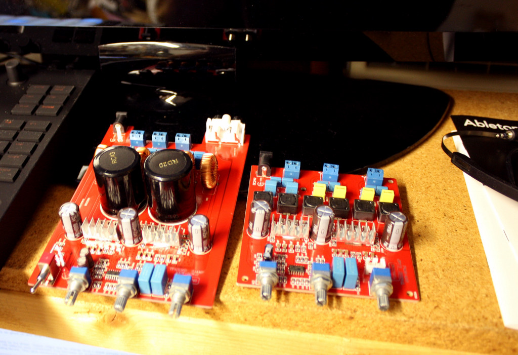

For now, I am going to leave the 3100 in place, because I have two different YuanJing 3116 boards waiting for a suitable power supply. They will get tested next.

I ran out of time last night, but I was going to say that the 3100 board sounds much better, and distorts less when fed by the linear power supply, even when it is set to the 19.2 volts that the laptop brick puts out.
The laptop brick has hard current limiting, and possibly foldback, so that when you ask it for over 3.2 amps even for a millisecond, its voltage output drops. The recovery time once the overload is removed can be 10's of milliseconds. Most SMPS's do this by design to protect themselves. The big old linear supply has a fat capacitor across it's output, so for short intervals it can put out even more than it's 5 amp rating.
I have a MeanWell 156 watt unit on order for the 3116 boards. The 3116 board can put out 200 watts, so it will need at least 225 watts to operate at full power. This can be acomplished by putting a large cap across it's output, since you don't need full power continuously. Some SMPS's will refuse to start up into a large cap. Some experimentation will be needed.
The "BoomStation" that I want to build will never need this much power when used on battery power, or with its internal speakers, but it will be capable of playing through external speakers on AC power, hence the need for small efficient audio amps.
