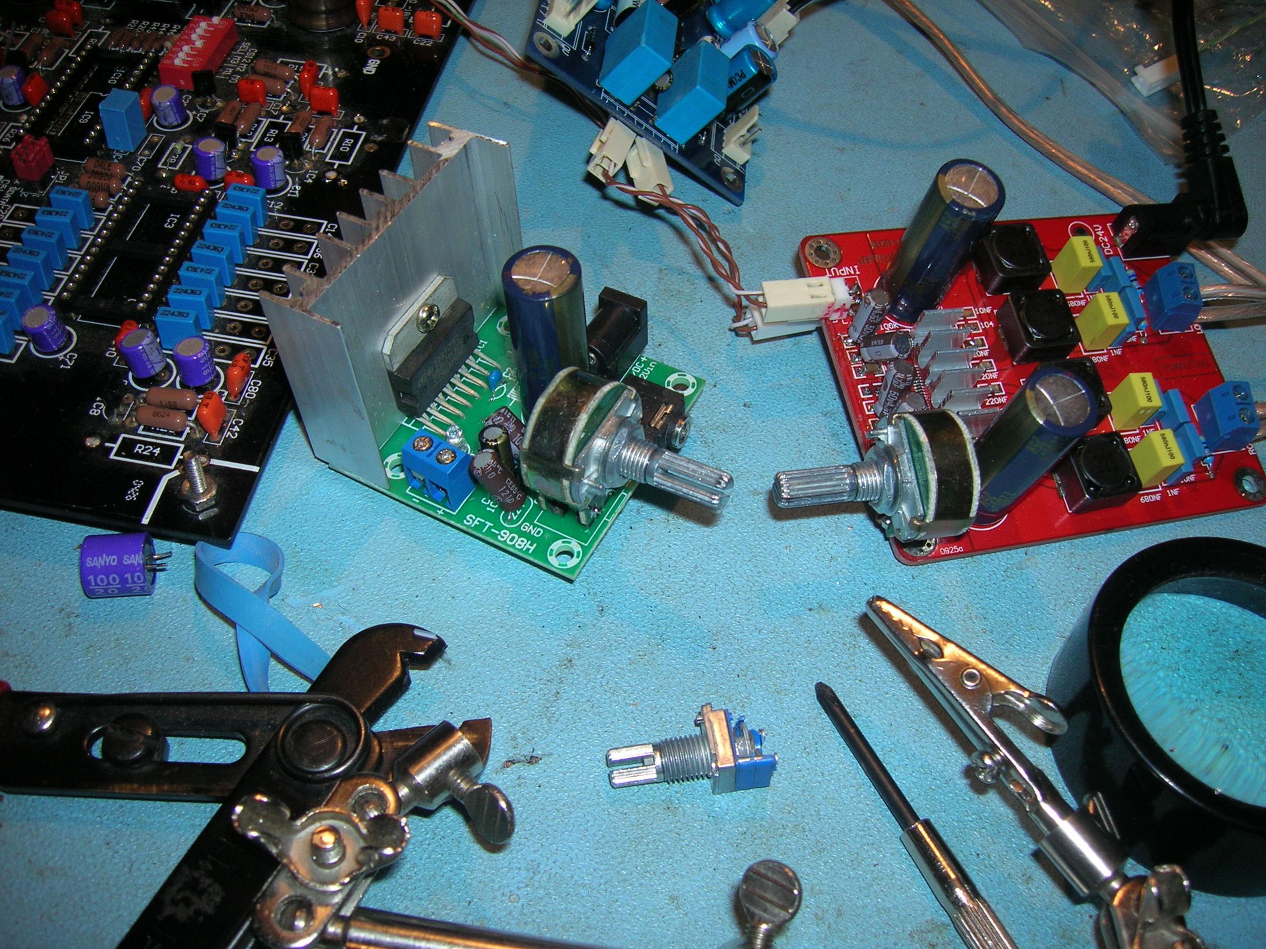

Wow, they are paying REAL close attention to this thread...
Two amp enter, one amp leaves!
Wow, they are paying REAL close attention to this thread...![]()
