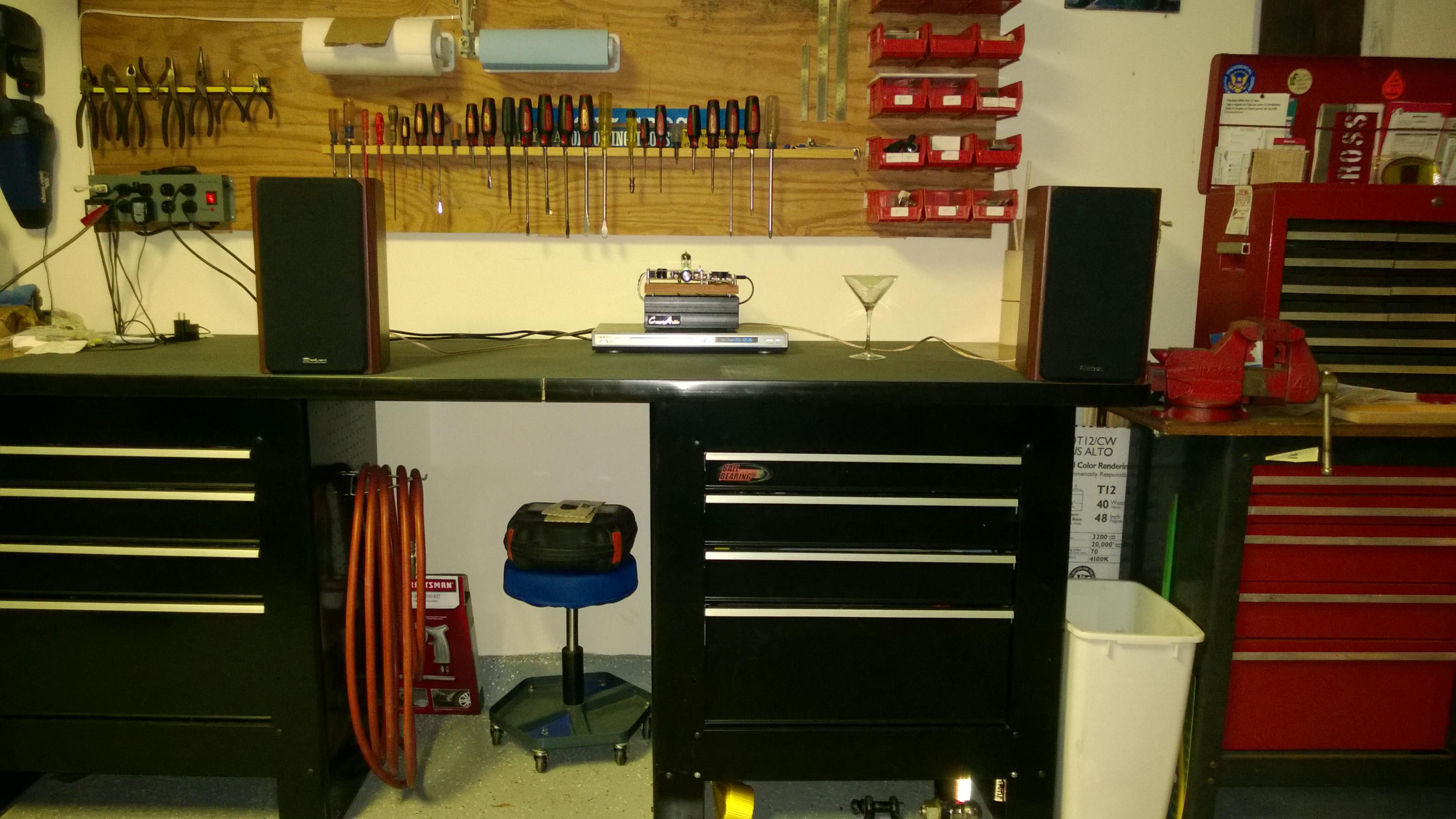

It works!

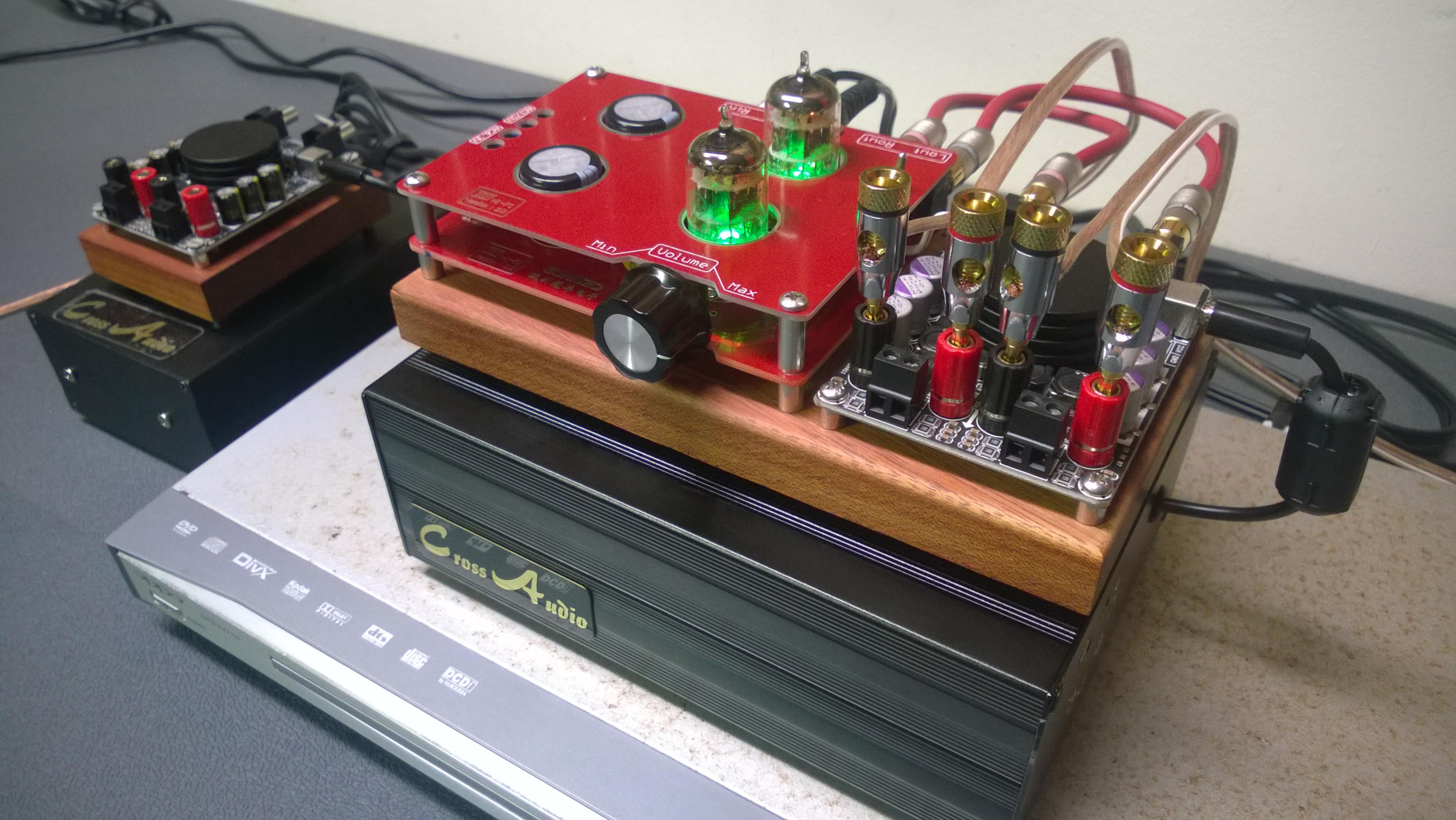

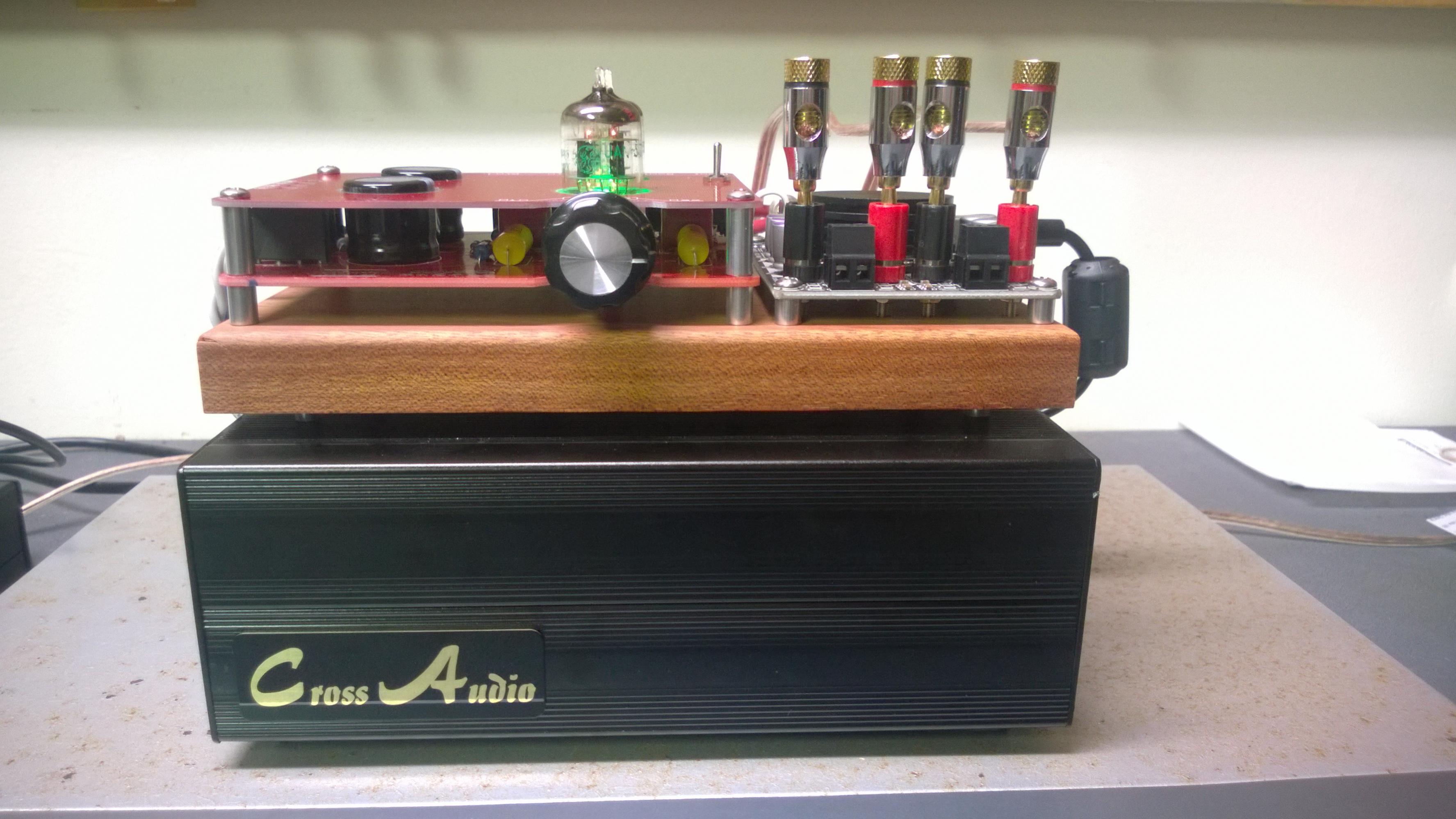

I love the open, breadboard look. Very cool. What tubes are you using?
Thanks.

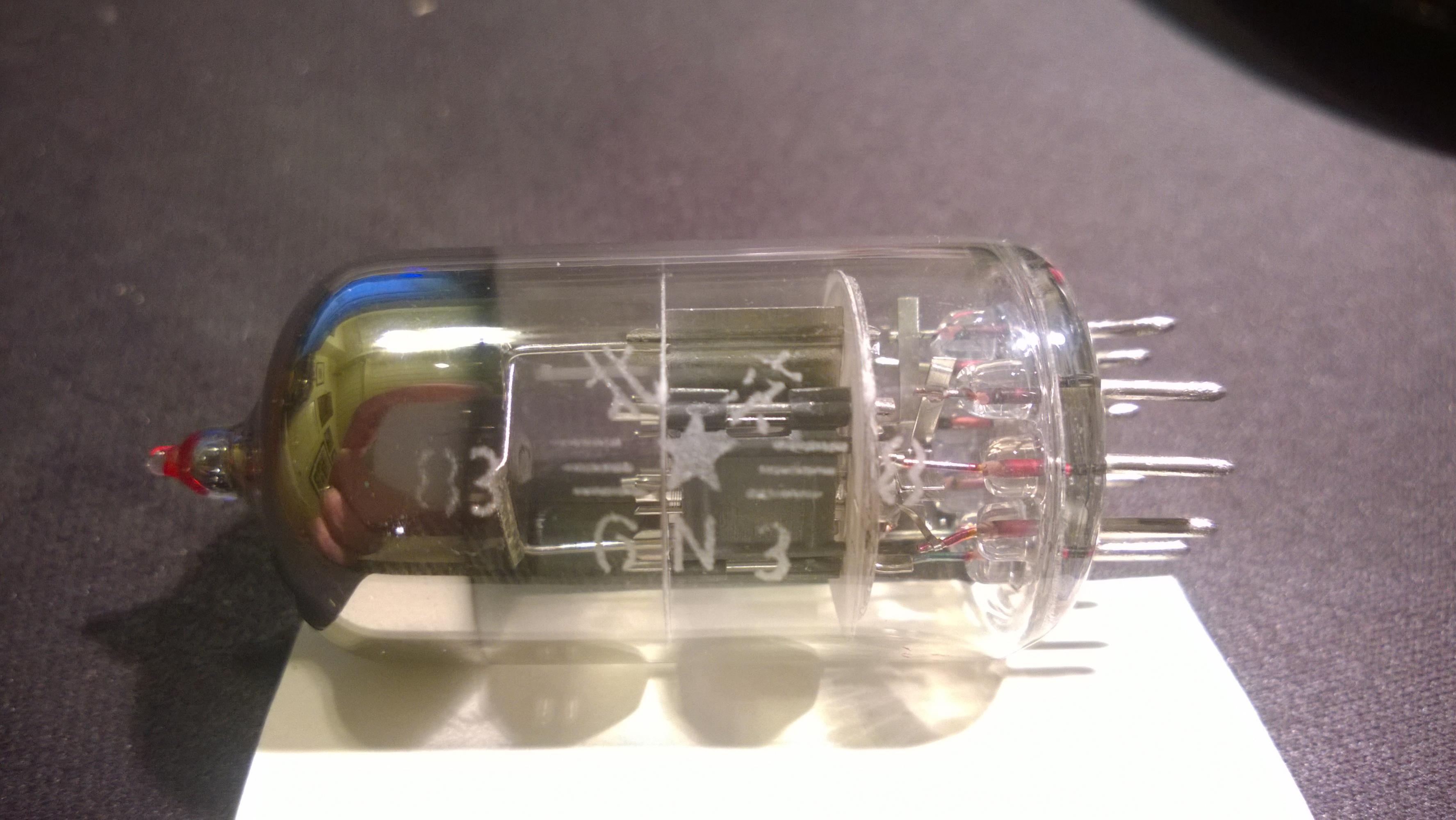

JAN-GE-5670W (NOS) Bulk Stock from thetubestore.com. They weren't very expensive, but they do sound more tube-like than the stock 6N3s, pictured below.
Do you have any other recommendations for these tubes?

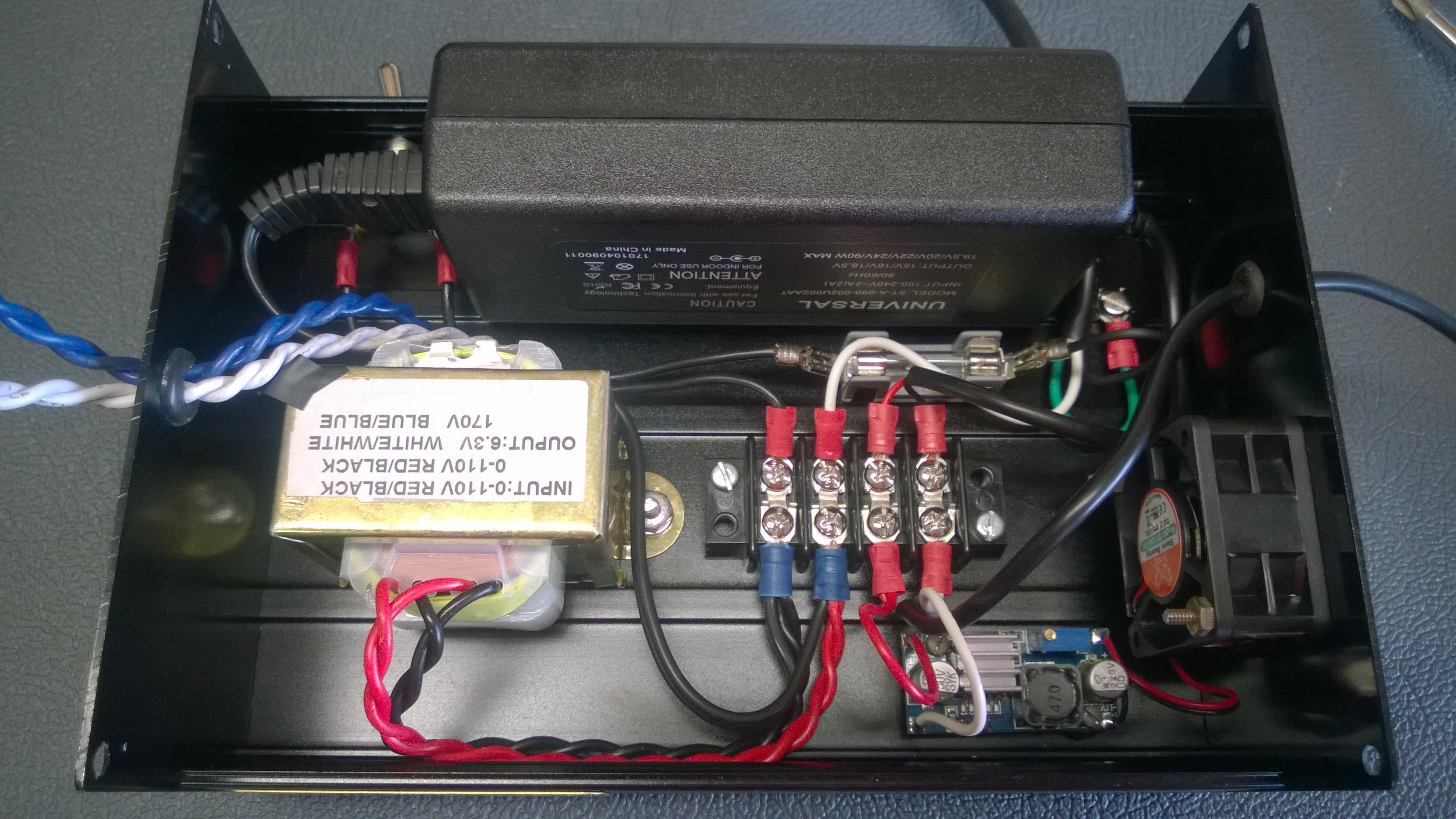

I just found this out for myself. I am getting distortion with my 13.8v Astron power supply at loud but not excessive volumes. You can really hear it with sustained horn and woodwind notes. I just tried the same songs with a 19v laptop brick (all I have at the moment) and the distortion disappears. So there is something to this, and I guess I should have listened to people earlier in this thread who said 19-22 volts is the sweet spot. I guess some who are using nice 13.8v power supplies have really efficient speakers, so maybe it doesn't come into play for them. My speakers are 95db.
However, though there is more distortion, the bottom end and soundstaging is much better with the Astron. So unless someone can recommend a PS in the 19-24volt range that has the best of the Astron but without the distortion, I may have to move back to my Marantz integrated😡

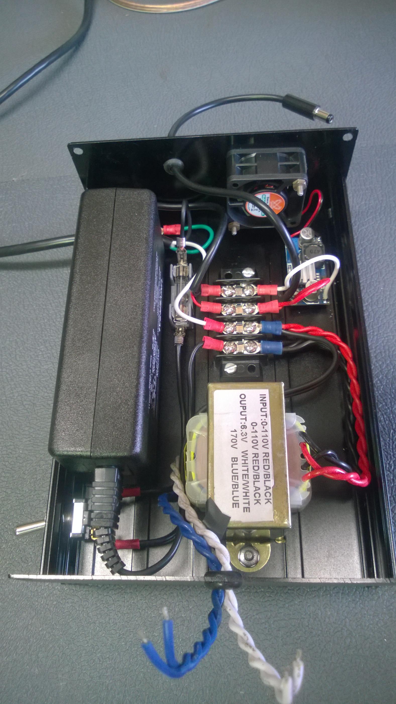

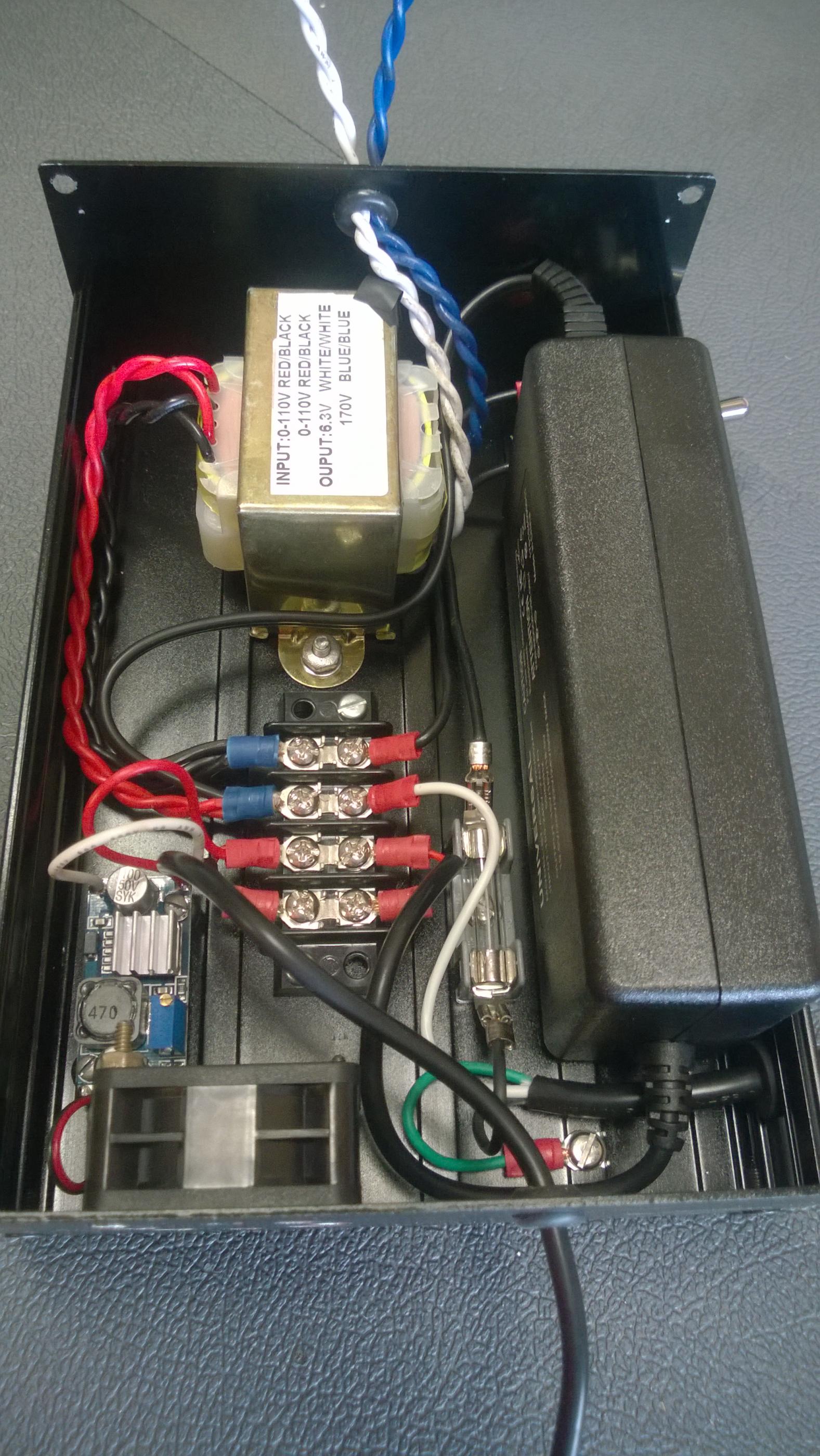

Try a sealed lead acid battery at 18v nominal (actually 19.4v when fully charged). Hook up three 6v batteries in series. Fuse each battery for safety.
The best of both worlds soundwise.
The only downside is having to keep the battery charged.

When or at what voltage level do you charge again? In theory, you could let it run down quite a bit, right? I have a nice 12v 5a SLA lying around. Should I just get a 6v and use the two together or is it better to have the three 6v in series?
I try to recharge when the 3 pack of 6v SLA batteries hits 18v or lower. If the goal is maximum battery life, you don't want to let it run down much. But even with small 7AH batteries, this typically gives me 12 hours of play time with the very efficient 3116 amp.
I wouldn't suggest an old 12v and a new 6v in series. They would be unmatched in too many ways.
It's best to use perfectly matched batteries when in series, to avoid all kinds of problems, especially in recharging when the charging currents may not be equalized and one battery ends up hogging the charge. Of course, you could charge the 3 batteries separately, that becomes more complicated and time consuming. I bought 3 brand new 6v identical batteries and can charge them all together as a pack, saving time.
No other power supply of any kind that I've tried, analog or switching, sounds as good as the battery pack. Obviously they put out pure DC without any contamination whatsoever, and they are isolated from the noisy AC line.
You can buy 3 6v batteries at 7AH for under $30, and the 18v charger for about the same. The charger I use is designed for the Minomoto scooter (18v version, not 24v version).
It works!
They look great. How does the 3116 sound with that little tube pre. I've been thinking of ordering one.

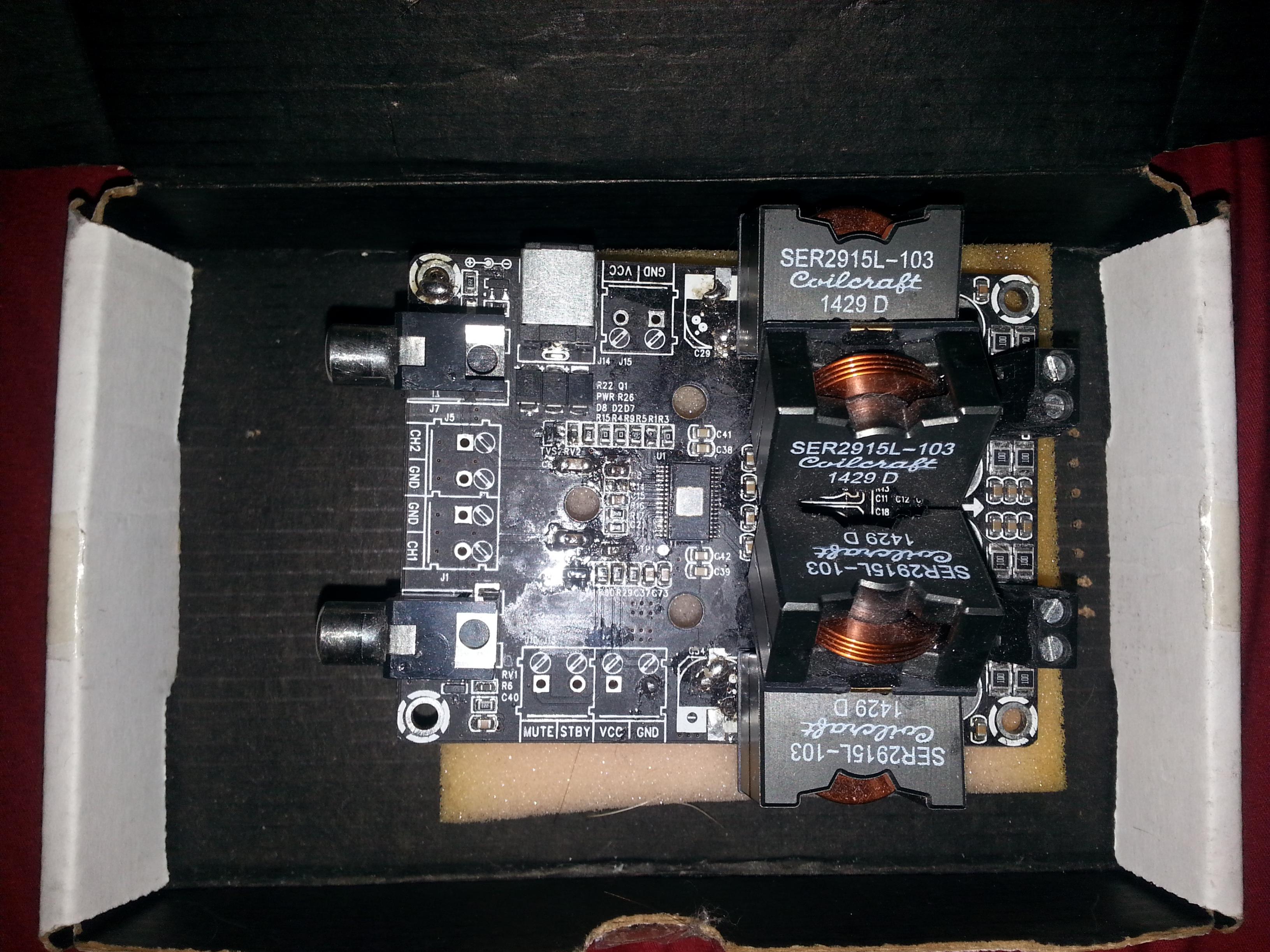

Sure 3116
Replace the six caps with the nichicon 330 uf 25v part RNU1E331MDN1PH Replace 4 inductors with coil craft SER2915L-103KL.
Do you happen to have a pic of how you fit those big SER2915 inductors on the Sure board?
Thanks!
I use the same tubes in my three tube version and like them a lot but would like to do some tube rolling soon. I've read a lot on upgrades but have yet to see a consensus on what is the best. This is what someone posted on another site that I think many would agree with:
1st class,
WE396A (D getter)
WE2C51 (D getter)
Bendix 6385
Tesla 6CC42
2nd class,
WE396A/2C51 (O getter)
Tung-sol 2C51 (1950s, D getter)
Raytheon CK5670 (1950s, D getter)
* Raytheon CRP 5670 windmill getter
RCA 5670 (1950s, D/Plate 2 supporting rod getter)
* RCA Command Series 5670
GE 5670 (3 mica structure, mostly 5 stars tube)
3rd class, (after 1960s)
GE 5670
RCA 5670
Tung-sol 5670
Sylvania 2C51
Sylvania 5670 (sometimes marked Mullard)
RTC 5670
Philips 2C51
4th class,
Russian and Chinese 6N3P, -E, -EB, -EV
Thanks!
