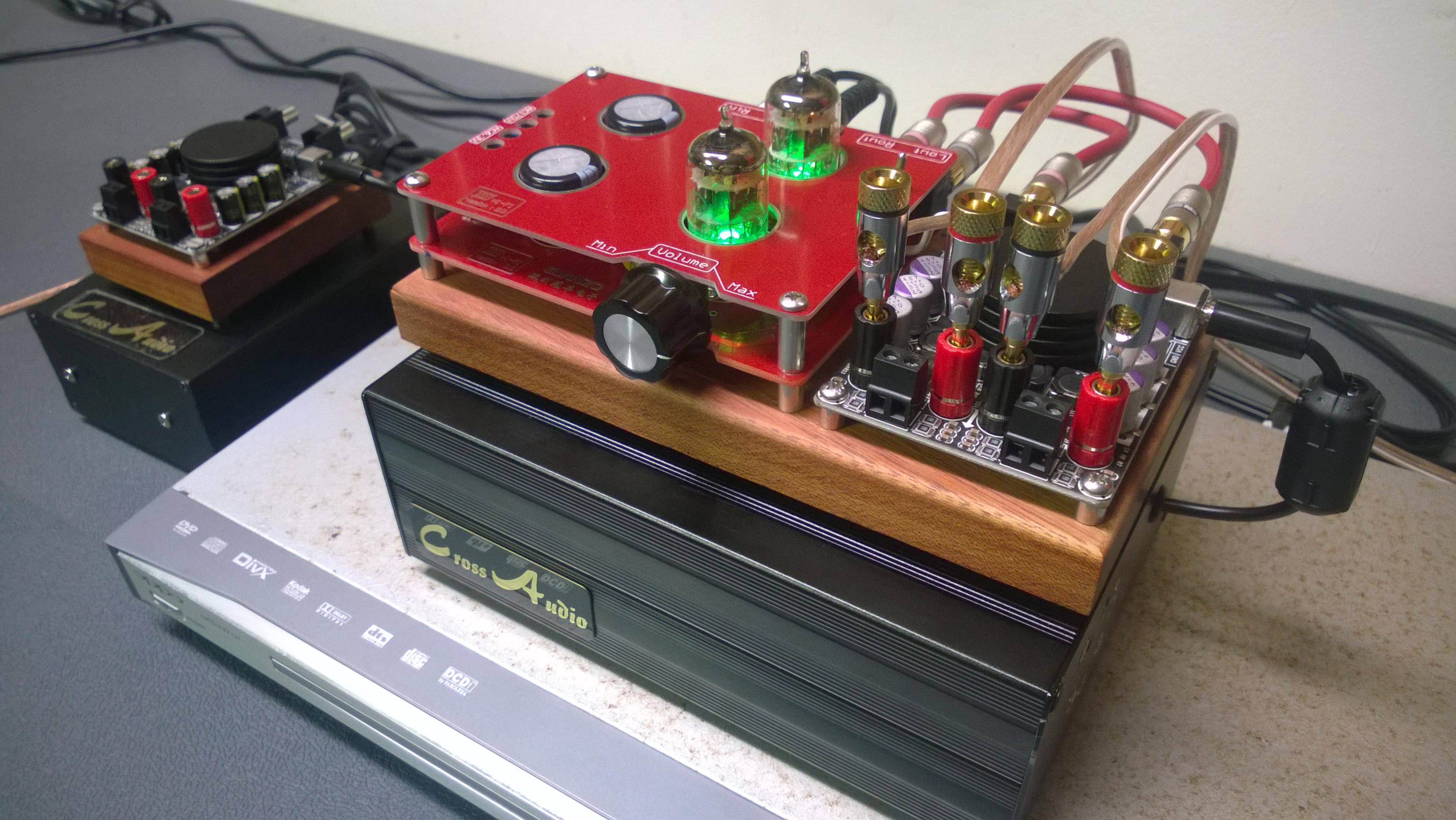

I'm setting up my switch boxes so I can A/B the Sure boards with and without the OSCON cap mod, and with the little tube preamp I got.

Bridge rectifiers in output Sure3116 will guide the oscillation voltage spikes that occur without speakers connected towards the PVCC capacitors. Post#1 tells us these could burn 50V filmcapacitors in open output instantly, TI confirms in next posts. The 25V Oscons are far weaker than any 50V filmcapacitor, they might not burn, but get damaged for sure I would say.
So what happens every time you switch speakers here???

When you switch the speakers out, switch a dummy load in.
Not sure how fast you have to do that to prevent damage.
A TPA3116 isn't a free energy machine, it won't charge your PVCC capacitors to a high enough level to threaten their voltage ratings while running off those same capacitors.

Probably faster than 2.5µs to be sure.
Just use a make-before-break switch, problem solved.

So you mean 50V MKP or MKT filmcapacitor does burn but a 25V Oscon doesn't ? Surge voltage for those filmcaps is in hundreds ?? of volts usually, for Oscon ~30V ??????

The output protection diodes are to protect the output filter caps although I would have expected a fast or schottkey type to be used.

No need. You want fast/schottky for situations like clamping an inductor in a SMPS, but in this scenario, the output capacitor limits the dv/dt so an ordinary silicon rectifier is OK.The output protection diodes are to protect the output filter caps although I would have expected a fast or schottkey type to be used.
Two different caps for two different applications.So you mean 50V MKP or MKT filmcapacitor does burn but a 25V Oscon doesn't ? Surge voltage for those filmcaps is in hundreds ?? of volts usually, for Oscon ~30V ??????
Output: use film capacitors.
PVCC decoupling: use Oscon + ceramic. Film caps big enough to have enough uF for the job have too much ESL for the job.
Sorry you miss the point here.
If you couple output to pvcc capacitors like Sure3116 with bridge rectifiers and we know 50V filmcaps that are less sensitive to overvoltage than Oscons, that those 50V filmcaps burn instantly and that TI isn't surprised at that, what will happen to 25V Oscons that do not have surge voltage margin? I would say at least you damage them every time you disconnect speakers and output without load oscillates.
I was thinking more of the resonance frequency of L and C.
10uH and 0.68uF is about 610KHz.
Driving an L-C circuit with a step function will cause ringing.
Add tolerance of L and C and you could have a resonance close to the switching frequency...then you get voltage gain.
Yes there is also some damping R-C on the output but why take a chance.
