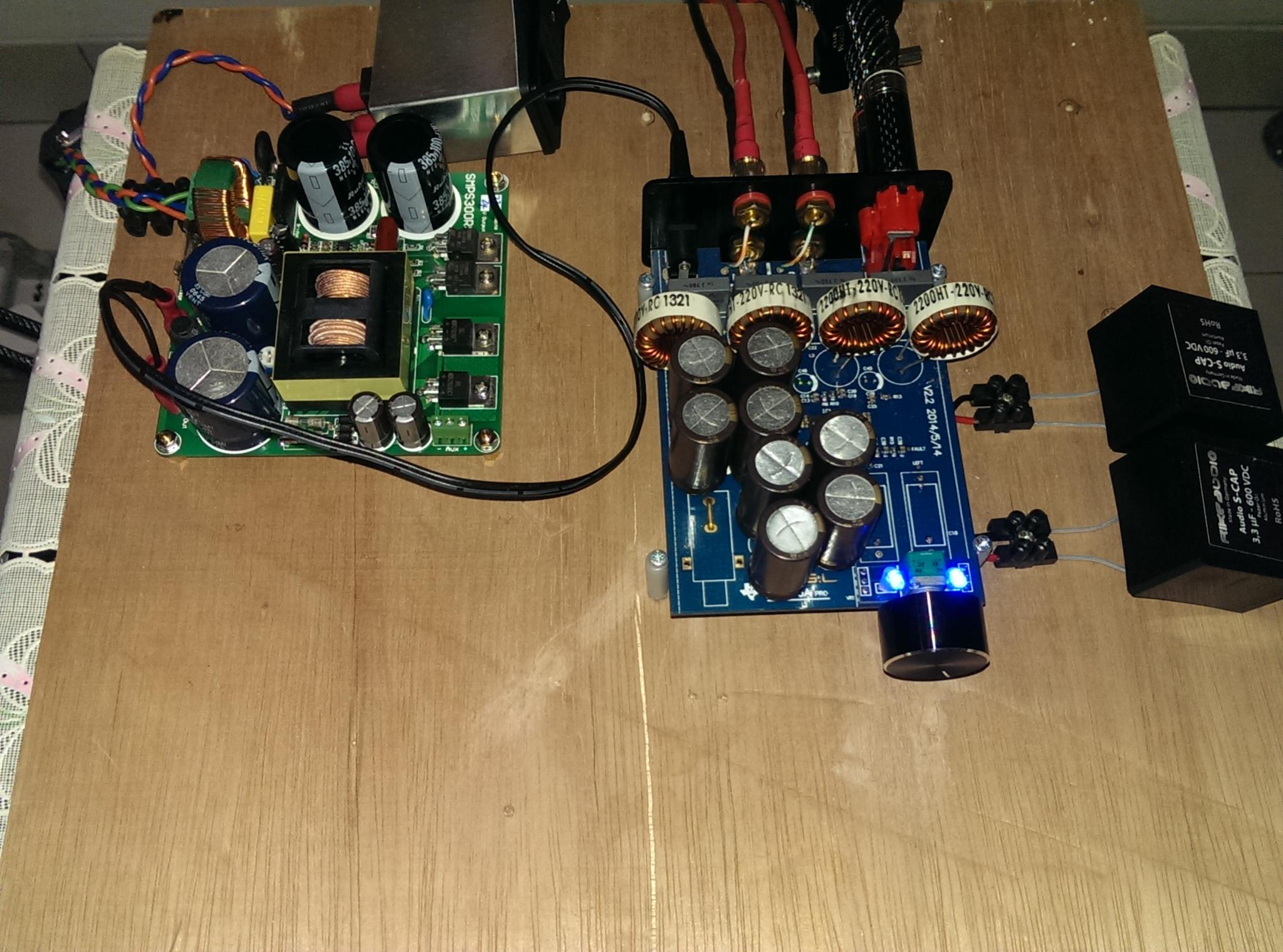

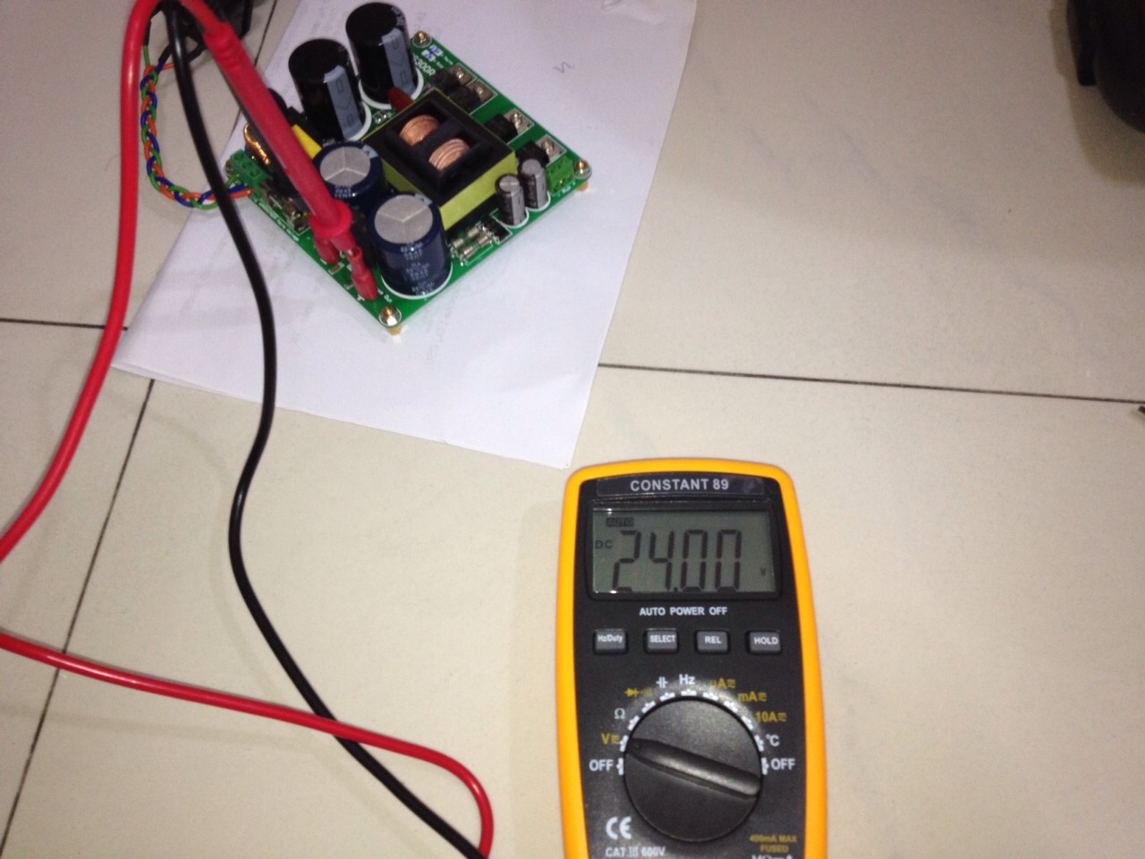

The more you go up in Amps it doubles or triples unless its debugged.
The one I got in from China today, had them debug it down to 55mv, that other one was 76mv. Im at 24V 5A. It sounds better then the linear psu at 14v.
Go figure...
