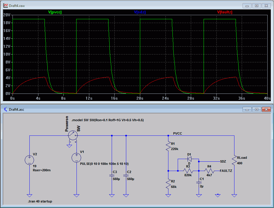

Thinking of, that the TPA3116/3118/3132 all got the same internal core, i'd point to another mute-delay-circuit with fast mute on power off.
It is calculated for PVCC=8V minimum. If you rise your minimum allowed PVCC, timing constants can be decreased, i.e. setting a lower margin for Vh.
This circuit doesn't use the mute-pin at all.
R4 could be as low as 800Ohm within the current setup to maintain <=5mA sinking current into FAULTZ at a fault event.
