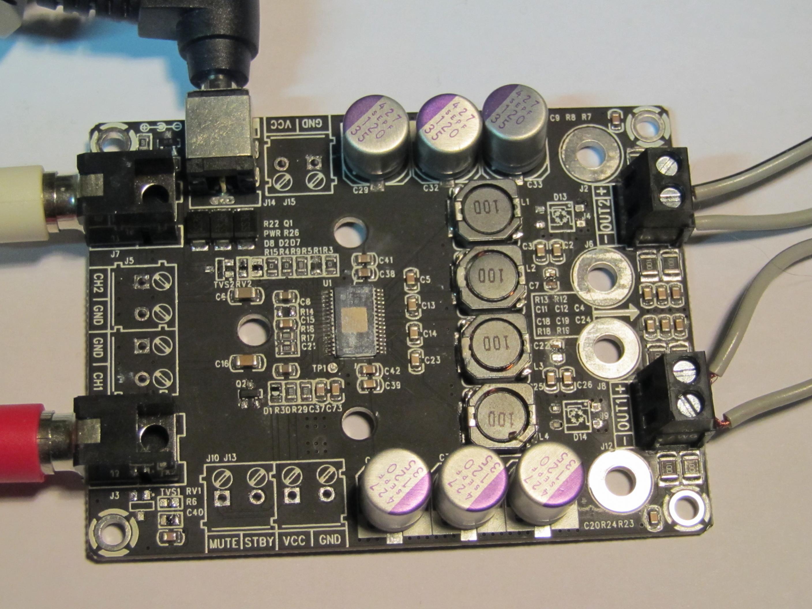

So I performed some modding on Sure 3116 board in hopes of getting rid of the annoying turn off pop.
First I removed the suspicious double diodes (marked TVS1 & TSV2) and some other component connected to inputs (RV1, RV2 and two resistors). Not much happened, turn off pop was still there.
Next was time to remove C7 and C22 from output side as recommended by irribeo. Finally I'm going to turn the board to PBTL-mode, so shorting outputs would have rendered these caps useless anyway. A little SQ improvement might have been perceived on high freqs.
Following same principle as with caps I removed bridge rectifiers. Sound didn't change, at least not to worst.
Finally added Oscons. Turn off pop got just a little smaller. 😕 I guess also dynamics where improved.
After all this torture board still has the turn off pop. There is no turn on pop and never was (lucky me). Any ideas how to get rid off the turn off pop without using a switch on mute or SDZ pins?

A turn off pop is expected, turn off crack Sure seems different, filmcaps on input also don't change that, is it just different because decoupling is so much different (decoupling seems inspired by higher (hundreds) Mhz designs) ?
What about this mod ?

no problems with lowered gain also less hiss, you don't mention ampboard but if 3116 2.0 just remove left, usually 100k resistor, you don't need to change right resistor to 5.6k.
without input/open input poweramp has more noise
