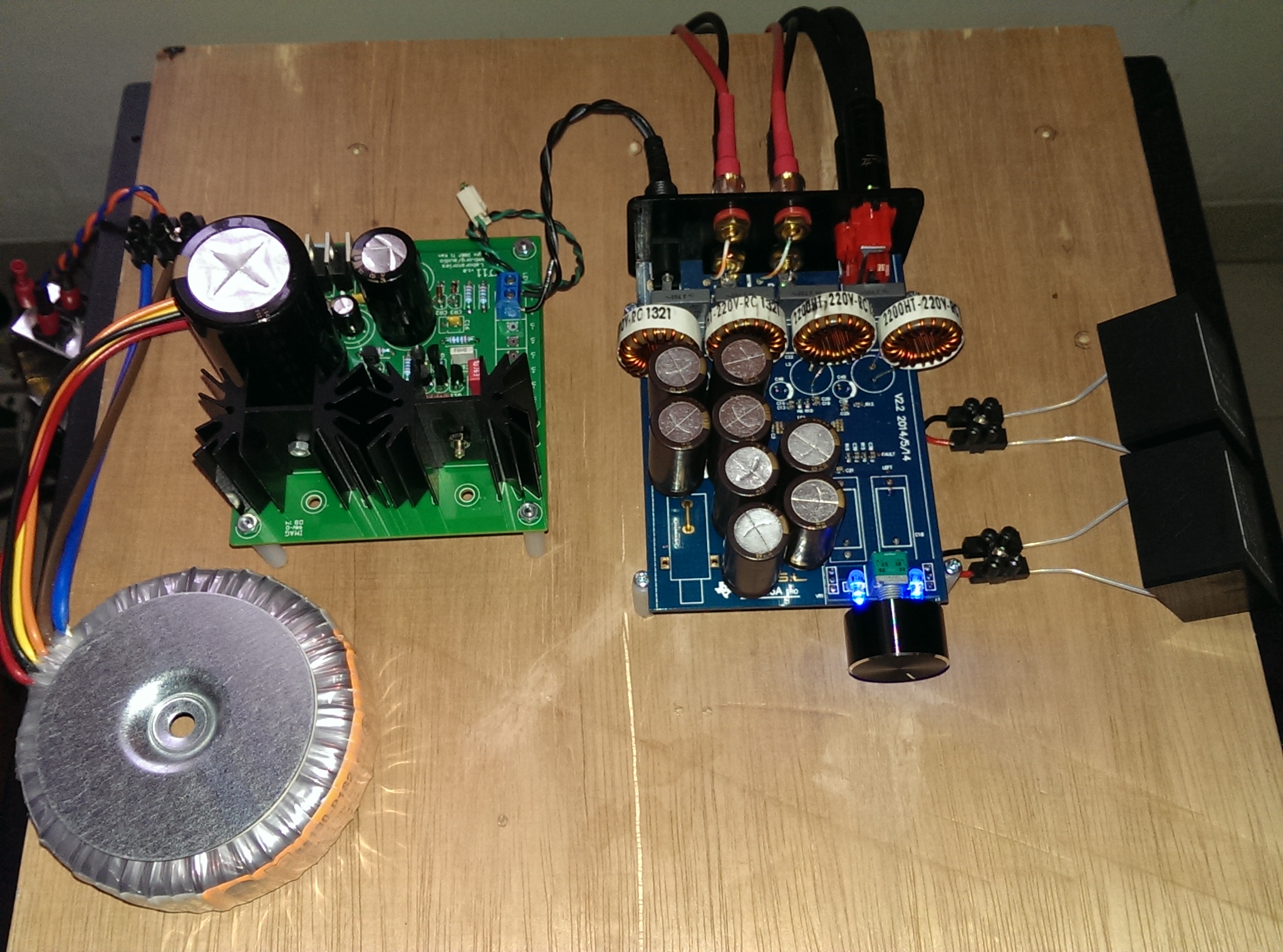

Update:
8 Elna Silmic ARS 470uF 35V.
Bourns 22UH inductors
3.3uF Rike Audio S input caps
24v Sigma 11 regulated power supply
Really like your mode.
Any sound improvement?
Can you show the back side of the amp plate?
Where you got your parts from?
Thank you,
Sergey
Hi Sergey,
A lot of improvements, it sounds really good now. Everything sounds to be right. Nothing is over highlighted, the music play has depth that you can listen into the recording more, much improvement in dynamics, natural sound and micro details that never been heard before.
For SMSL 36a Pro, basic modding caps like Oscon SEPF in chip PS and Panasonic FM in PS filter sounds harsh in my system, less details and smoothness in the music. But once changing and combining the caps in the proper places, it plays music in another higher level than MyRef.C amp.
I'll take the picture later when I am home.
okay Guise,
I finally tried to do a build worthy of the experts on here. This is an amplifier I made as a gift for a friend's wedding. It features YJ blue/black with input cap, power supply cap, bootstrap cap, and snubber mods...
Basically every good mod except the inductors. And, the volume pot is just a cheapy 50k from YJ.
I also added a board that runs the power-on LED indicator as well as some spare capacitance using 2x1500uF Panasonic FM caps.
Mounted in a cedar souvenir box I found in a thrift store.
A very good friend with a drill press helped me mount all the connectors without making it a total hack job.
Interesting thing here is that when I finally completed it and hooked it up it sounded terrible. I have a set of the Pioneer BS22 speakers with the Dennis Murphy mods and all I heard was serious distortion and crap.
So, I started to troubleshoot only to realize that I was actually hearing the amp burn in or something. All the distortion quickly faded away and in the midst of A/B testing with my desktop version of this amp--same mods plus coilcraft inductors and ALPS blue velvet volume pot--I quickly coudl no longer discern the difference.
So, I guess I literally heard those FM caps and the other stuff burn in ...
Within 20 minutes it sounded great.
I want to thank Rhing and all of the other experts on here. Without your pictures and work I would have never been able to put this together.
Now, I need to build one for myself. It pains me to have to give this away.
