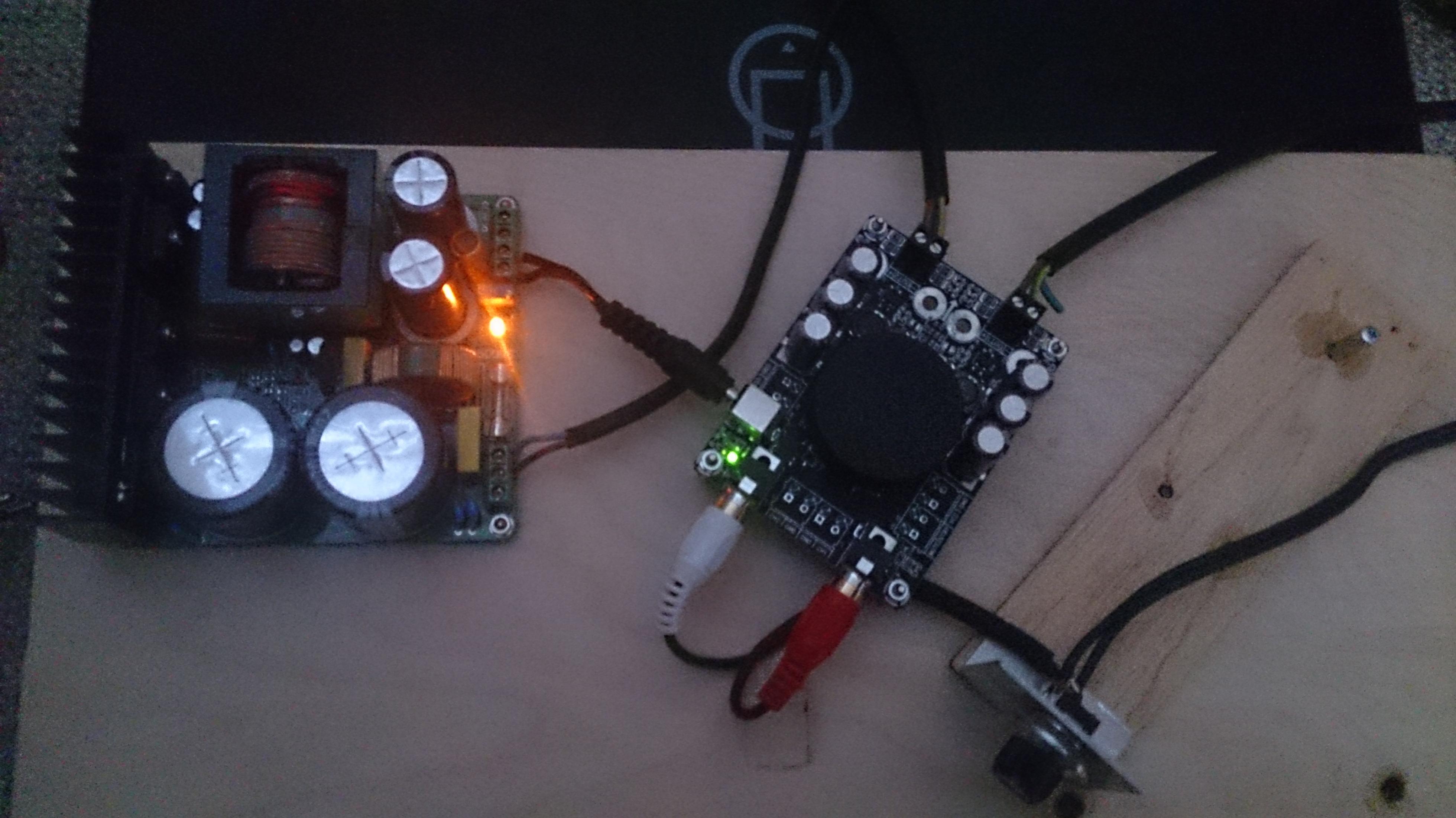

For what it's worth: I used a Connex SMPS800R with great result with a Class D Audio SDS-470 build I did a couple years ago. It was better than the stock Class D Audio linear power supply. That was two or three years ago, and literally my first foray into DIY amp building. I'm not sure how good the stock linear PSU is, it looks quite simple.
My goal was actually to reduce power consumption, not improve performance. Power consumption actually went up ever-so-slightly, but the sound quality improved, and the amp became much lighter (not that I moved it often, but the massive torroid in the linear PSU was a bear).

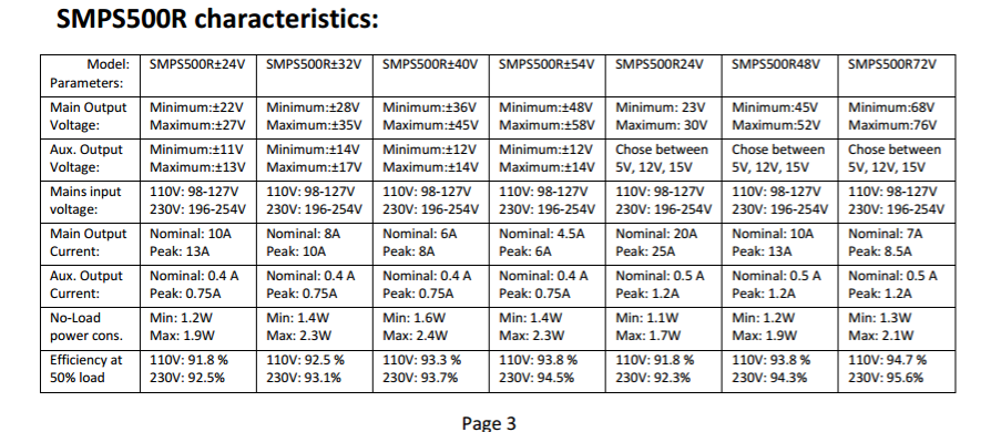

I am considering a high watt SMPS for a 5.1 channel project, where 5 channels will be run from one PSU, while the sub(s) will have a separate amp altogether. For the amp, I have a 6 channel YJ red board.
Attached is a copy specs from the SMPS500R pdf - this one should have enough capacity for 5 channels of TPA3116D2? 24V looks borderline... a 20v version would have been great.

The SMPS500R-Single with 600watts peak power is plenty for 5 channels of TPA3116. Realistically each channel is not going to be sitting any where near 50watts. As I mentioned before thise supplies can be adjusted by +/- 5-10% (as per spec can go down to 22V) and you can get a custom voltage if you so desire.
By the way the specs you attached are for the +/- voltage model so for the single rail one double the amps stated.
Ah, just noticed both +/- and single rail supplies are in those specs.

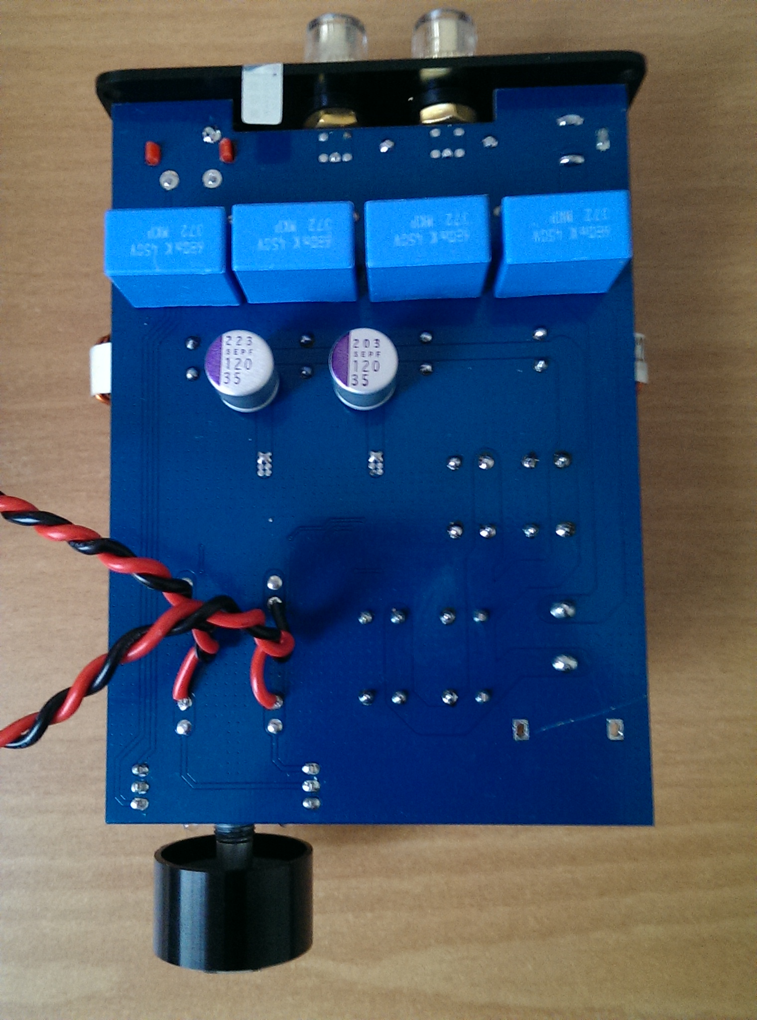

Here is the photo of the back side you requested, sorry been busy with my work lately.
