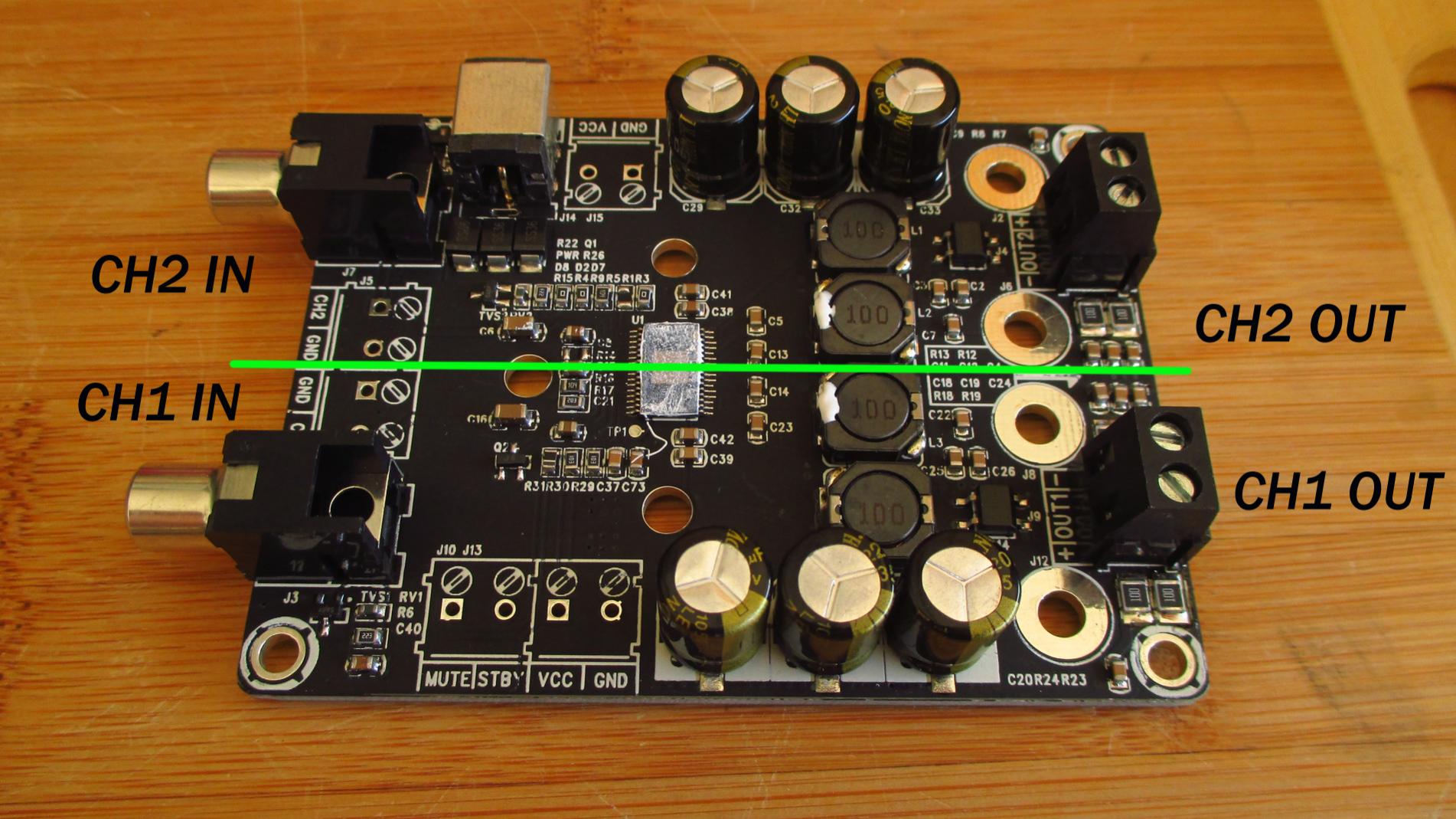

Where does Sure swap (output) + and - for right side channel of chip (TI left ch, Chinese right ch) ?? (SureTPÂ3116)
If I understand your question, the Sure board does not suffer from the channel swapping nomenclature issues of the the red YJ board because they keep the input/output of each side of the board labeled CH1 and CH2.
TI TPA3116= Rch+, Rch-, Lch+, Lch-
Sure3116= +,-,-,+
Where do they swap + and - ???
Sorry, Now I know what you are meaning…. Yes! Thanks! This should have been the very first thing I mentioned about this board.
When I first hooked the 3116 up according to the diagram, it was out of phase…. I switched the phase at one of the speakers and have been hooking the amp up at the board according to the diagram and hadn't thought about it since.
Speakers should be hooked up +,-,+,-
(unless you have a component that reverses absolute polarity, in which case you would hook it up -,+,-,+)
I noticed that too and assumed Sure did some trace crossover with 2 layers and vias. But you are saying labeling on Sure board is incorrect and should be standard +, -, +, - ? I remember someone else getting a Ybdz board a few pages back and complaining SQ sucked and I noticed he had the phase incorrect because assumed it was mirror +,-, -, +. A pretty big silkscreen blunder if you ask me. Not as bad as the left right mess up on the Lepai 2020 when using 3.5mm input.
You think left right mixup is less serious then phase mixup 😀 What do you think sounds worse ? LOL
Yes left right is less serious because it is hard to detect. The bass and all sounds pretty good it is just the imaging is like you are standing on your head. With phase mixup it sounds like cr@p worse than a $2 am radio. The left right mixup was not discovered until like 400,000 views (by me) in the Lepai thread. Nobody noticed it.

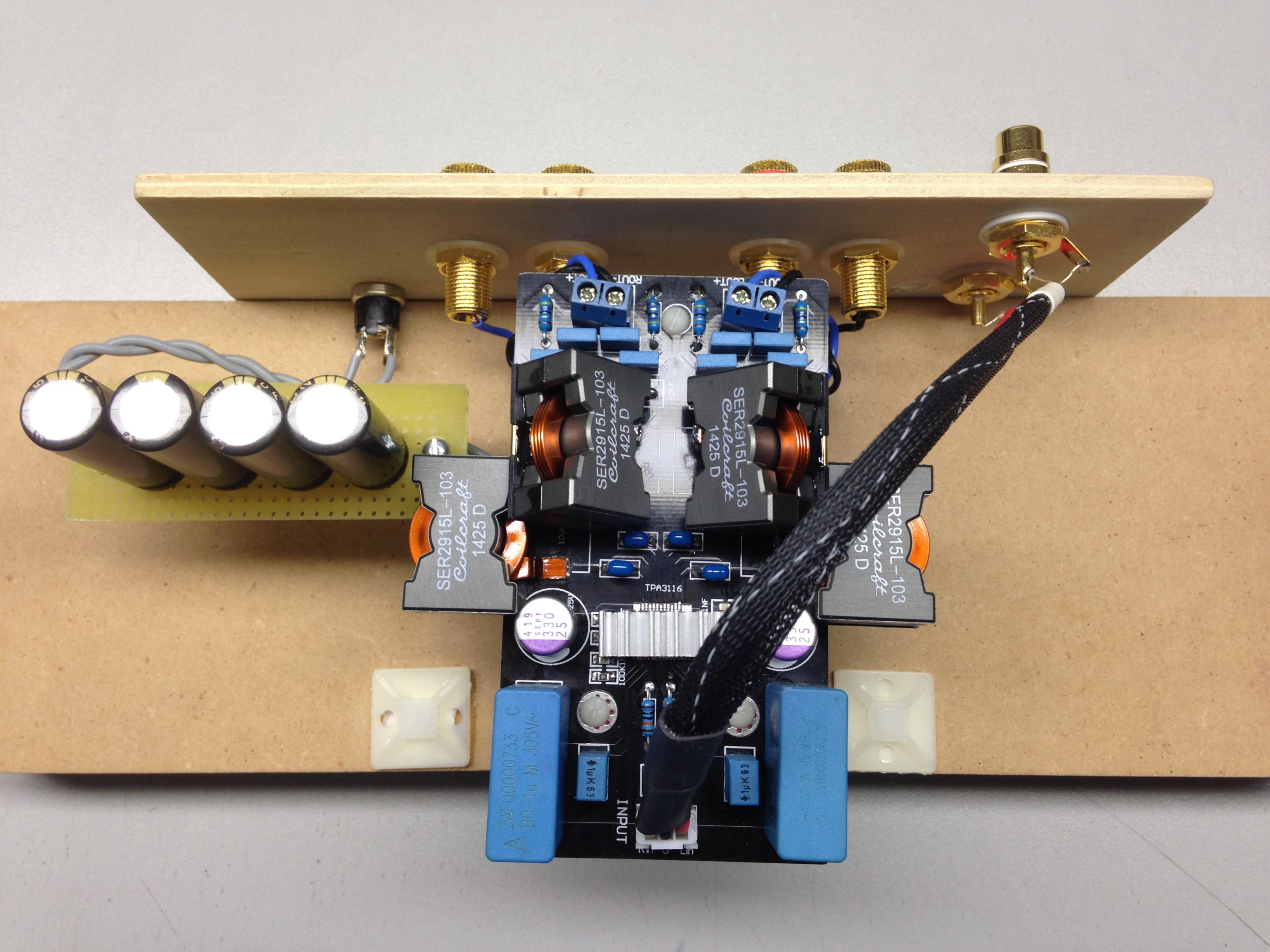

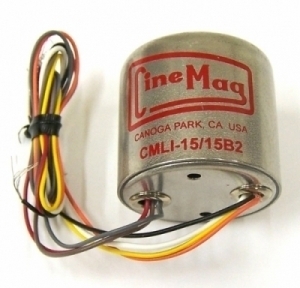

Sweet indeed!. I'm really fighting the temptation to buy any more TPA31xx amps. I previously mentioned that a buddy and I compared his 300B mono block SET amps to my modified YJ TPA3116 blue amp (http://www.diyaudio.com/forums/class-d/237086-tpa3116d2-amp-395.html#post3995147). He liked the YJ amp so much, he purchased it from me, but I told him he would have to get his own power supply, since I wanted to keep my upgraded Astron RS-12A.
Since then, I modded my second YJ blue amp with the TDK X7R ceramic caps for the bootstrap caps, Panasonic SEPF OSCON caps, CoilCraft SER2915L-103KL inductors, and I added four Panasonic FM caps offboard between the power supply and the amp. I have a pair of CineMag CMLI-15/15B line-level input transformers on order with CineMag right now. Once I get those, I will remove the four film input caps and take advantage of the differential inputs. Can't wait.

I came across these Cinemags too, but 150 euro (set) here, bit much for imperfect amp board...

You guys are really confusing me😕
When looking at my 3110 board from the input side is it correct that CH1 is left input, and CH2 is right input? Now, looking at speaker outs, Channel 1 looking from the input side of the board it is labeled - +, and channel 2 is labeled + -. Is this wrong?
