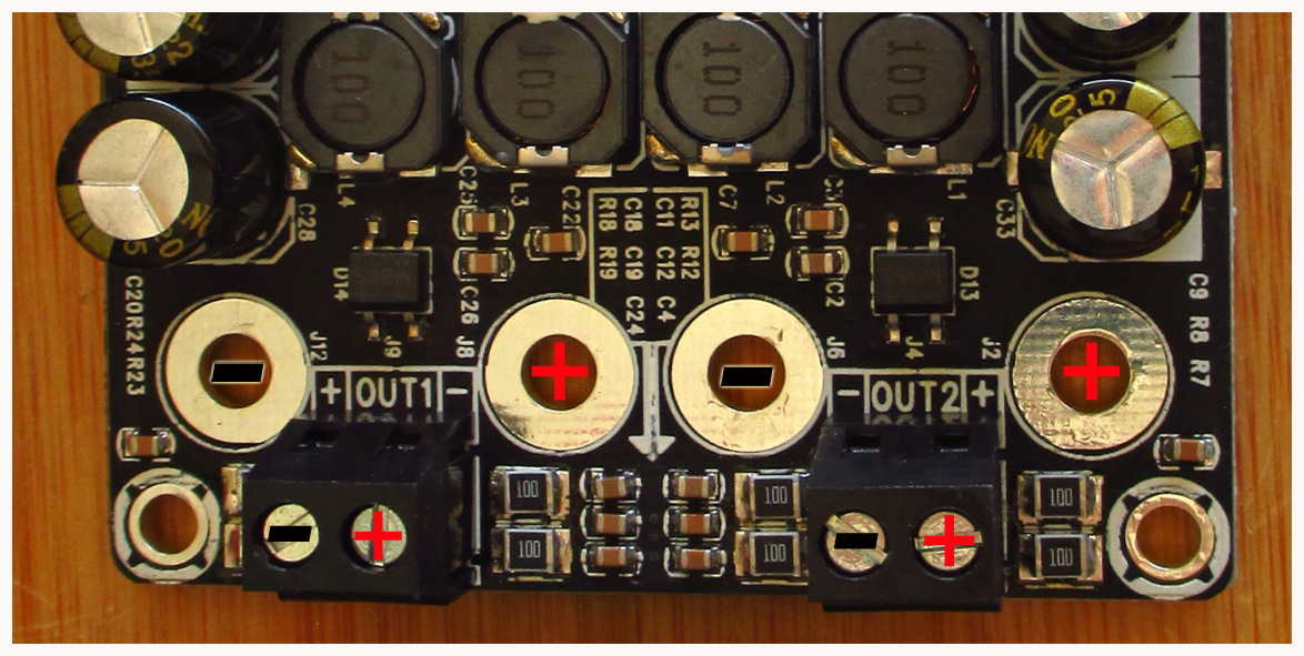

Wouldn't a bridge rectifier cause a frequency doubling? You can't use it for audio signals for this reason. A 100 Hz signal from amp would sound like 200 Hz etc. Are we sure that diode component is doing that in the signal output?
Hopefully this post is not off-topic. I can't find a better place to put it, but just let me know if it needs to be moved. I'm just wondering, for those that have heard any of the First Watt or ncore DIY amps, do you think that any of the 3116 boards have the potential to sound as good with the right components, and if so, how much would you expect to need to spend, not including a case or power supply? I am considering building one in a few months, but this will be my first electronics project in 30+ years, so the Nelson Pass/First Watt F6, for instance, is most likely beyond my capabilities, and possibly my budget, as well.
Looks like you have absolute phase wrong here, see positive outputs from bridge rectifiers. But there also seems to be a via next to positive output bridge rectifier OUT2, does bottom side show anything? Or from outputpins from these bridge rectifiers signal goes straight to output terminals?
How about that new 3110, +/- output from rectifiers differs from standard tpa3110 +--+ too, so could be wrong after all? I believe I read new 3110 had grounded negatives?
My new 3110 does not have grounded negatives, and it's labeled the same as the 3116 +--+
Output from TI TPA3110= L+L-R-R+. So if the MB6S bridge rectifiers are not in signalpath or signal crosses after the MB6S befor reaching 1 of the speakeroutput then speakeroutput on SureTPA3110 is correct. Looks as if they are in output signalpath, but matte black soldermask pcb doesn't make photo's very clear, maybe they are not 🙂 No idea what their function on these pcb's would be, maybe to limit reverse current??? In powersupplies they also limit ripple and signal sinewave gets altered I think I read 🙂 Not something desirable in speakeroutput poweramplifier???

MB6S is part used, but maybe they are not in output? That could be...
As I don't have a Sure 3116 or 3110 in front of me we will have to await KJA2013 to tell us how the full wave bridge MB6S rectifier is hooked up. As I said, a full wave bridge has the neat trick of frequency doubling an AC input. Maybe it is used for the power bus to prevent reverse polarity? Odd location for that though.
A bridge could be used for diode clamping of the outputs...convenient single package for four diodes.
Placing one part vs four parts is a cost savings for auto assembly...even if the part is more expensive.
That makes perfect sense. So the AC part would be connected to ground and the positive to ch1 +out and negative to ch1 -out?

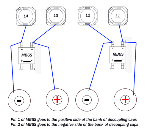

These boards are murder to see the signal paths on.
The pair of inductors for each channel are connected to the AC side of one of the two MB6S Bridge Rectifiers
The DC side goes to the bank of decoupling capacitors.
Here's a simple diagram showing it.
??? so your 12A DC supply (mine) is connected to output to your speakers? separated by a device that has 0.5A peak ability? maybe I read datasheet wrong?
Yes, but where does the +/- of the rectifier bridge go?
It's stated on the diagram.
Pin 1 is +
Pin 2 is -
There's probably much more to it, but this much is what I measured.
Pin 1 is +
Pin 2 is -
Sorry, did not see the little 1 and 2 from my phone's screen. As they go to the power rail and ground, they are clamp diodes just like Dug suggested. But why is this needed or helpful? Seems like it may add some sort of diode switching noise to the system at the crossing level of 0.6VDC?
