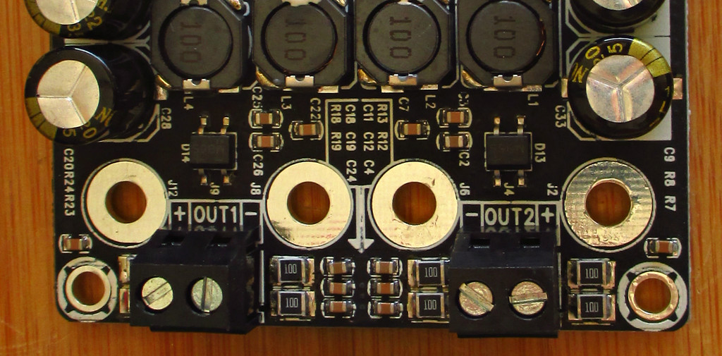

Well reading around, Sure's are puzzling. They use bridge rectifiers in output to.....???
Both positive and negative output AC from tpachip become input AC for bridge rectifier to become ......??? And the negative speakerterminals are grounded I saw mentioned over on another forum ??? Like single ended amplifiers ??? What would be the benefit ?
Is that what the 4 lead diode package is? Hmm... SE output may let you use this like a conventional class AB amp and allow a common ground for 3 wire speaker connections to stereo. Also lets you tie channels together for matrixed stereo. If it works it may actually be very cool. This would explain the reason why + and - are mirror imaged.
Well reading around, Sure's are puzzling. ........And the negative speakerterminals are grounded I saw mentioned over on another forum ??? Like single ended amplifiers ??? What would be the benefit ?

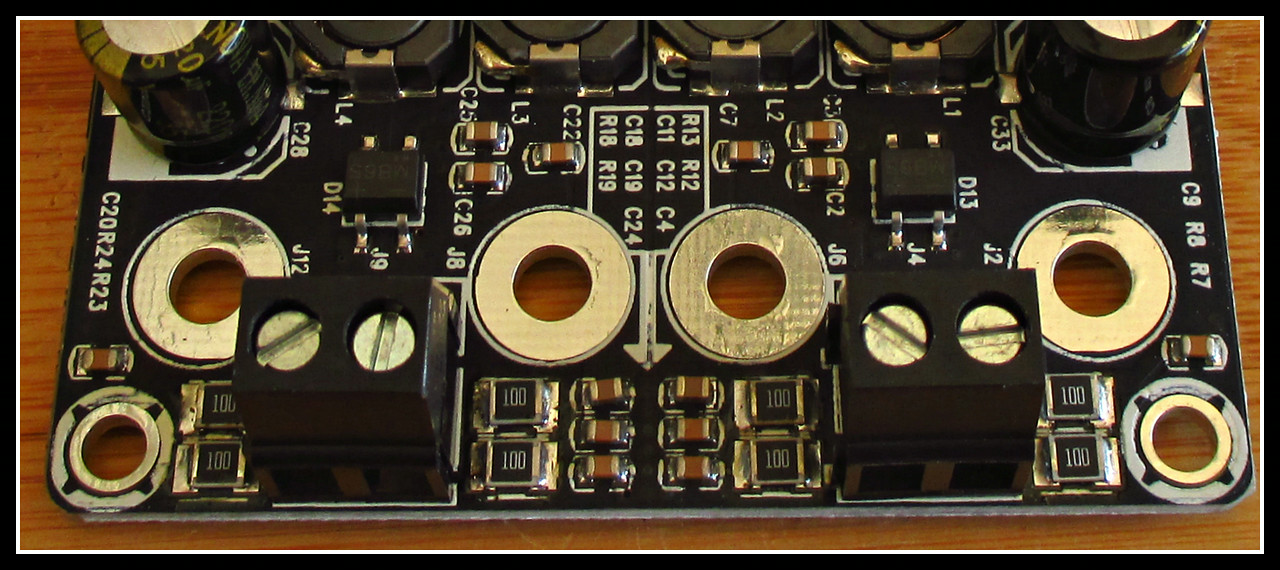

Looking at the Sure 3116 output would lead one to think that the negative terminals are the center pair and that they are grounded but they are neither. The outputs are still BTL and each terminal ties directly to it's associated inductor. There is no ground reference on the stereo outputs of the SURE TPA3116.

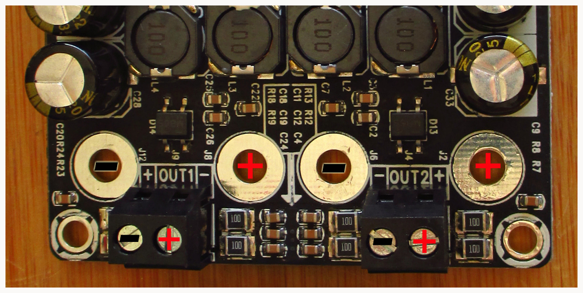

..... I forgot to add this image to my last post.
Looks like you have absolute phase wrong here, see positive outputs from bridge rectifiers. But there also seems to be a via next to positive output bridge rectifier OUT2, does bottom side show anything? Or from outputpins from these bridge rectifiers signal goes straight to output terminals?
How about that new 3110, +/- output from rectifiers differs from standard tpa3110 +--+ too, so could be wrong after all? I believe I read new 3110 had grounded negatives?
I just don't get it, Sure is not here from yesterday and kind of reputable firm, why would they make such a terrible mistake and mixed up connections? Is there anyone of you who could write and tell them that? 😕
Sure Electronics usually simplifies circuits and doesn't bother with for example excessive distortion occuring because of that. On these last two, tpa3110 and tpa3116 they seem to have added a lot of parts, partscount is much higher then competitors, so not typical Sure Electronics I would say.
Do they now also care more about outputsignal, not to make mixup mistake? They still sell several unstable other amps which they simplified🙂
I may have absolute phase inverted in that image, but I don't think so. I mainly wanted to show how to prevent being "out of phase".
The new version of the Sure tpa3110 does not have grounded negatives at the output, it is BTL as usual and is "in phase" with +,-,-,+ .
Yes, to me - that 3110, on sale! :h_ache:
When AC signal is applied to bridge rectifier, no matter positive or negative, a positive signal will come out positive output side, a negative at negative output side of the bridge rectifier. Only outputs from bridge rectifiers determine + and - here (with signal applied). So were do these outputs go? For new Suretpa3110 it also looks like straight from rectifier to output, then labels on output must be wrong too. But that could easily be measured, where do the bridge rectifier outputs connect to, everything befor inputs for bridge rectifiers have become irrelevant I think, isn't that why they are used in powersupplies?
