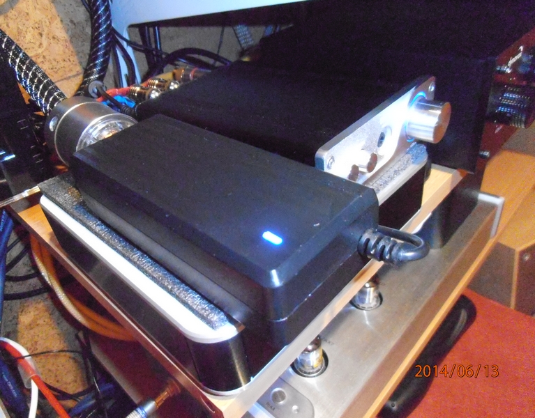

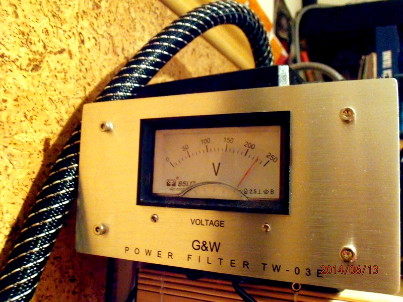

I always run all of my gear via Power-Filter, even that little SMTP 2024, and with all those pre. and amplifiers I have always using good quality power cords with additional alu-shields on connectors. The improvement is tremendous. Or is it just a placebo effect? hmm who knowsJust an interesting observation. I have the Breeze 2.1 and recently moved the whole set up to another room where I have a substantial power conditioner that I plug all my equipment into. The bit of treble glare that I had before has completely disappeared. This unmodified Breeze unit has gone from very good to outstanding. Admittedly I am only using the 2 channels and not the sub output as I found it to have too much lower mids getting into my bass driver. The point is for those interested try using a power conditioner and see i you like the results. I know I do.
I'm afraid the particular Power Conditioner I use won't be of use to anyone since it was a design product that never made it into production past about 6 units of which I kept 3. However I would think any substantial power line conditioner would have similar results. Of course it can quickly become absurd plugging a $20 - $80 amp module into a $1000 power conditioner. Out of pure convenience I'm using a lap top brick for power supply. Nothing special really just 12v 3amp supply. This all leads me to think that the best bang for the buck use of these little gem amps is with battery power so that all of the trash on the mains lines becomes a non-issue.
