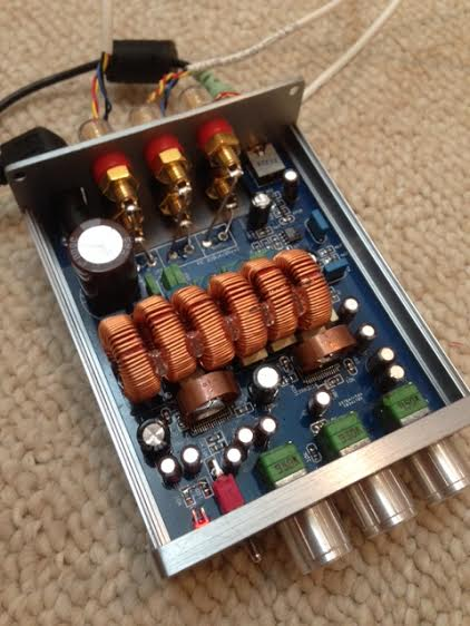

Breeze Audio 2.1 listening impressions
I am a happy camper with the Breeze Audio 2.1 amp (2.1 HIFI digital amplifier TPA3116 D2 50W+50W+100W 2.1 HIFI digital power amplifier /TPA3123/ TDA2030/ LM1875-in Amplifier from Electronics on Aliexpress.com) - I was given one by a generous diyAudio member as it was delivered to him DOA. The shipping caused the heavy toroidal chokes to sway back and forth and snap off a couple of the bootstrap caps. Anyhow, there is plenty of room on the underside where I added some 100 volt 0.1uF x qnty 2 as a fix for the 0.22 uF 63V caps that came stock. Once I did that, it works like a charm. Also, the puny aluminum heat sinks were double sided taped on had come off. I soldered a couple of 0.5 in dia copper rings that I hack sawed from water piping as heat sinks to the top thermal pads. I also added some hot melt glue around the inductors to stabilize them to each other and the filter cap bank.
I am listening to it with the stereo channels driving a 3.5 in Vifa TC9FD fullrange in a 0.4x scale Karlsonator cabinet and the subs driving dual 6.5 in woofers in a Nautaloss sub cabinet. Powering it all with a 90 watt Fujitsu laptop 19volt smps brick. It sounds fantastic! 😀
The Breeze Audio 2.1 is one of the few (if not the only one) with a built in variable frequency XO for the sub with independent volume for main and sub. This feature works very well and allowed me to integrate the sub to perfectly balance out the sound.
I am really impressed by how compact this amp is - it is about half as short as I imagined it would be. It is 3.5 in wide x 4.3 in long - smaller than a standard photograph.
The build construction, apart from the beefy looking but floppy inductors, indicates pretty good neat soldering. Not the optimal layout like the Ybdz 2.0 in terms of short distances between all the bypass caps, etc but fairly good quality parts throughout. I am surprised they are using electrolytic 3.3 uF Elna caps on the inputs? Would non-electrolytics sound better here? Also, the main DC power rail caps are 220 uF Elite brand - probably could use an upgrade here to Panasonic OSCON 330uF's.
Thanks again to my benefactor for giving me this nice Father's day present! 🙂
Here is a photo of the amp with the copper ring heatsinks and hot glue stabilized inductors. Great sounding amp!
