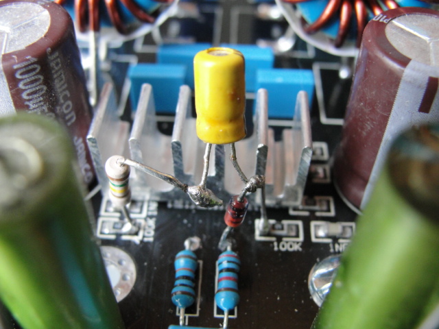

Irribeo, I havent any equippment to measure capacitance on the old ones but the sound were night and day.. The new ones were 3 times larger which should keep them more stable. From this I guide I learned about the weakness of ceramics; Trevor Marshall - Class D Audio Amplifier Design - TDA7498 Output filters
In this tutorial he measured a capacitance of a ceramic bootstrap that were just up to the task voltage vise.. capacitance varied a lot and caused a 3% THD in a similar class D board as ours.
After trying out different caps on the power side I found distance to the chip were crusial to low noise. 7mm cap legs made unberable noise in my setup. That makes me belive that the legs on the film bootstrap caps adds noise because of increased ESR. Well thats my guess anyways. I will put X7R on the blueboard also.. I'll report back if there is the same improvement there! But for me the coarseness is just as bad on the blueboard (even on different speakers@4.1ohm).
I used these for bootstrapping,0,22uF; http://www.ebay.com/itm/271177868349?ssPageName=STRK:MEWNX:IT&_trksid=p3984.m1439.l2649

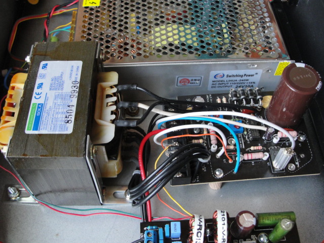

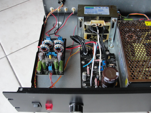

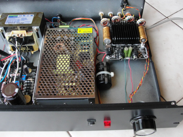

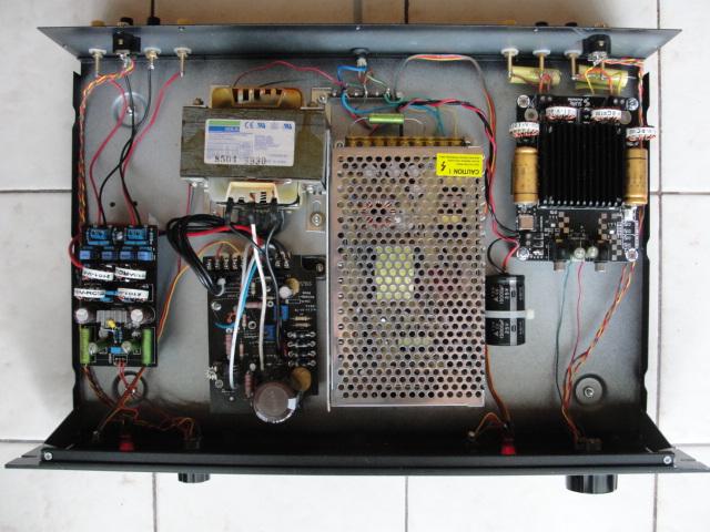

Linear PS installed...

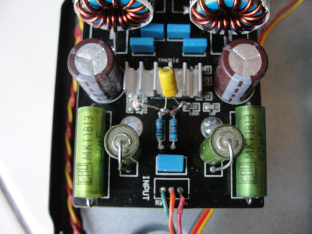

I finally put the linear PS inside the chassis. The PS is based on classic uA723 chip driving two pass transistors. The linear PS had to be disassembled and the two TO-3 2n3055 was replaced by other NPN transistors (TO-220 type) which mounted onto the bottom chassis under the PS board for heat dissipation purpose. The PS was originally at 24V but I do agreed that the amp sounds better at a lower supply voltage so I lowered it to give 19V. This will also reduce the heating-up of the output coils a little bit as well.
Input caps are ERO MKT 1813 2.2uF type. I like these caps, they do sound better than stock caps. I have concluded that the power-off pop is due to the difference in cap values at the + and - inputs. At first, I only changed the two caps on the + L/R inputs to 2.2uF, leaving the two on the - inputs to be 1uF. Then I had power-off pops. I believe it is due to the different discharging rate when powering off since the input is at 3V dc per datasheet. After changing the two 1uF caps to 2.2uF EROs at the - inputs, no more power off pop.
I also implement the power on pop circuit suggested by member Giancarlo69. (the yellow cap, 150kR and a diode).
You can see the right side of the dual amp is the original Sure TK-2050 with a SMPS modded with the same output coils and input caps.
Next will be the bootstrap caps and power tank caps. Why don't we just get the bare boards ? We are changing mostly everything on the blue board anyway.......

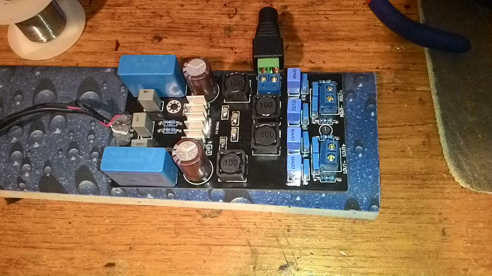

I tried the 3.3uF/160V Wima MKP10 in my Yuan Jing blue amp, but found a faint high pitched noise. I suspect that the wires connecting the cap leads to the PCB were picking up some switching noise.
I've since switched back to the stock 1uF/250V Epcos MKP caps and found the bass to be adequate for my listening. The 3.3uF Wima's did go lower, but not as significantly as one would expect, and the noise was annoying enough to go back.
If I try rolling other input caps, I might try the 2.2uF NOS ERO MKT1822 metallized Polyester film caps that I have in my parts bin. They have the 22.5mm lead spacing for a perfect fit on the "+" input thru-holes. They take a while to smooth out as they are obnoxiously bright when first installed.

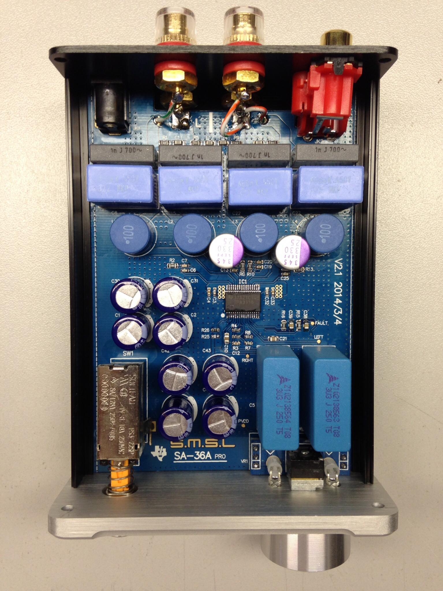

Funny thing is there are 3.3uF/250V Epcos MKT film caps in my SMSL SA-36A Pro TPA3118 amp's inputs, and they sound great. As good as the SMSL amp is, it still has that turn-off thump that is probably more annoying since my Klipsch Forte II speakers are 98db sensitive.
