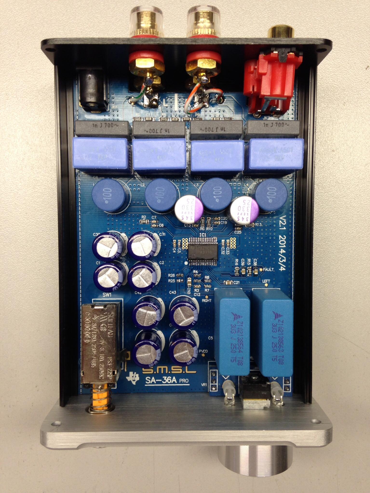

With using smaller value, lower ESR caps, you will find a significant improvement. Initially, I had good results with improved bass and dynamic response using larger caps, but found the midrange to be grainy and strained. I switched from 1,500uF/25V Panasonic FM to 470uF/35V Panasonic FM and the results were very positive. Then I read wushuliu's post about using Panasonic hybrid Aluminum electrolytic-organic polymer caps. I read some Panasonic white papers and data sheets and decided to try the 330uF/25V Panasonic SEPF OSCON caps. In all three of my TPA31xx amps, switching to these OSCON caps has been very positive. The bass is better defined, the dynamic response is quick. Better yet, the midrange and highs are more fluid and relaxed. I mentioned before that using these low ESR (~ 14-16mohm) caps and X7R ceramic caps on the bootstrap positions per the Texas Instruments TPA data sheets (and Saturnus) are probably the best modifications you can make to these amps.
I recently switch to the OSCON caps for my new SMSL SA-36A Pro TPA3118D2 amp, and again, the amp sounds much better.
hybrfid aluminium electronic organic changed nothing to me....
I have to understand what is the source of this issue

If the hybrid 330uF sounds the same as 1500uF pan FC, then the problem should be easy to find
Well....
I found the issue....
I feel so stupid...
the quality of the record was bad. I had this bad feeling with a unmodified YJ board, but it was not so important.
Trying with good quality record was much much better.
Having a modded YJ board is not good in all situation....

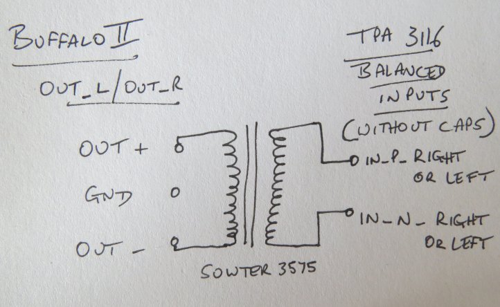

I want to thank sharpi31 for the info posted on using isolation transformers instead of input caps. I posted the following on audiocircle but wanted to put it here too as I have not seen sharpi31 post on audiocircle:
I took the plunge and (following Sharpi31 on diyaudio) removed the input caps on my Audiobah board. I then connected (hardwired) the balanced inputs of the TPA3116 to the isolation transformer that is the output stage of my Buffalo II DAC. The DAC has firmware volume control, so as of now between the output pins of the ES9018 chip and the input pins of the TPA3116 there is only some wire and Sowter 3575 transformers wound with OCC copper (10K:10K isolating transformers).
Interesting mod!
Could you share more information?
Source for transformers, wiring, cost, pics, etc...?
Thanks!
Thanks Nick - There is not a lot to see as the Buffalo is enclosed in its own walnut box with wires coming out the back that I have soldered directly to the pads (nearest the chip) from which I removed C15, C16, C18 & C7. The instructions for this were given by Sharpi31:
For anyone interested in adding input transformers (or bypassing the stock input caps) to the Audiobah AC1308 amplifier pcb, you need to remove C15, C16, C18 & C7. The connection pads nearest the heat sink for each of these components are the balanced audio inputs to the TPA3116D2 chip.
Sowter 3575: 3575
It is awkward to get inside the Buffalo box at the moment for photos but the connections are straightforward - board to transformer to wire hanging out the back to Audiobah board as detailed above. The Buffalo has Paul Hynes regs, which really lift the sound quality.

Thanks for sharing dboy. Eventually, I want to implement the full use of the differential (i.e., balanced) inputs of the TPA31xx amps to achieve the same goal as you. I looked into input balancing transformers from Lundahl and Jensen. I had contacted Kevin at K&K Audio, the U.S. reseller of Lundahl transformers. This is what he had to say:
The key to using a small signal transformer at the input to do what you want to do without the coupling caps in the presence of absolutely equal DC bias voltages at the inputs connected to the input transformer secondaries. Any significant DC current flow (uA levels) due to different input terminal potentials will saturate the core of the transformer and result in very poor bass response.
You mentioned that the bass is lacking, and I wonder if this might be the cause, or if it is simply an impedance matching/cut-off frequency issue.
That said, assuming that the DC voltage at each input terminal is identical for a channel (+ and -), then no input caps are required. I just don't know enough about the workings of the TPA31xx amps on whether the DC voltages at each terminal are indeed equal.
