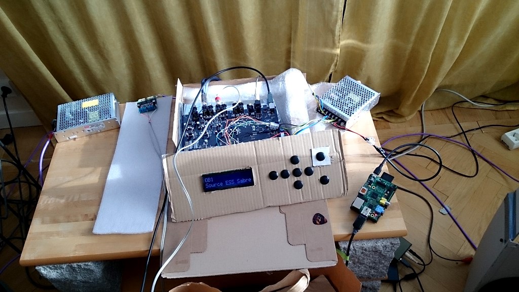

I bought four of the $35 ones (his own design) to follow the Najda DSP (highly recommended btw), driving the full rangers and woofers of my own OB speaker. It's the tiny thing on the left in this picture 🙂
(This is just a test bed, I will obviously take more care with cable routing, lengths and such when actually building stuff together 😉 )

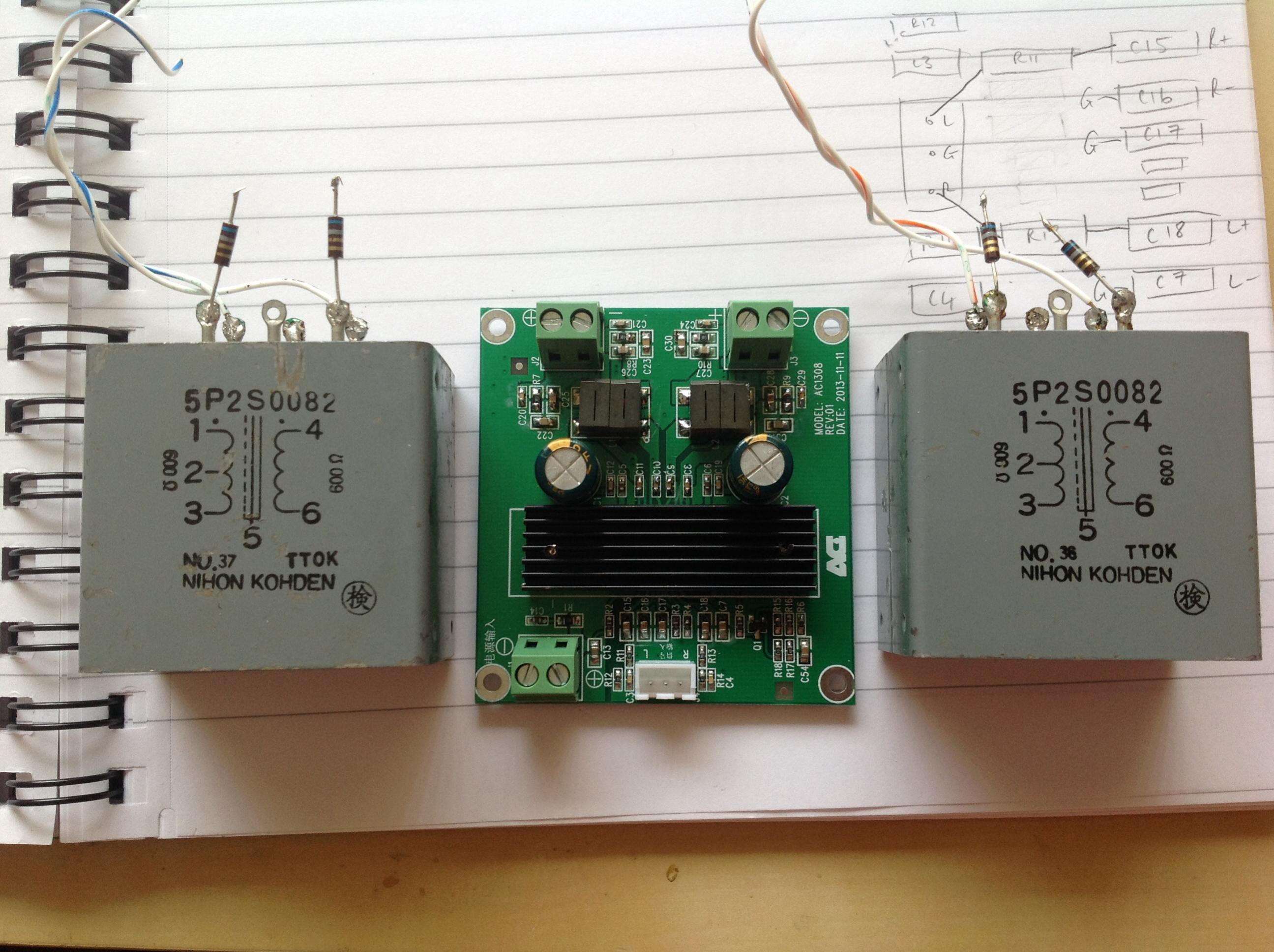

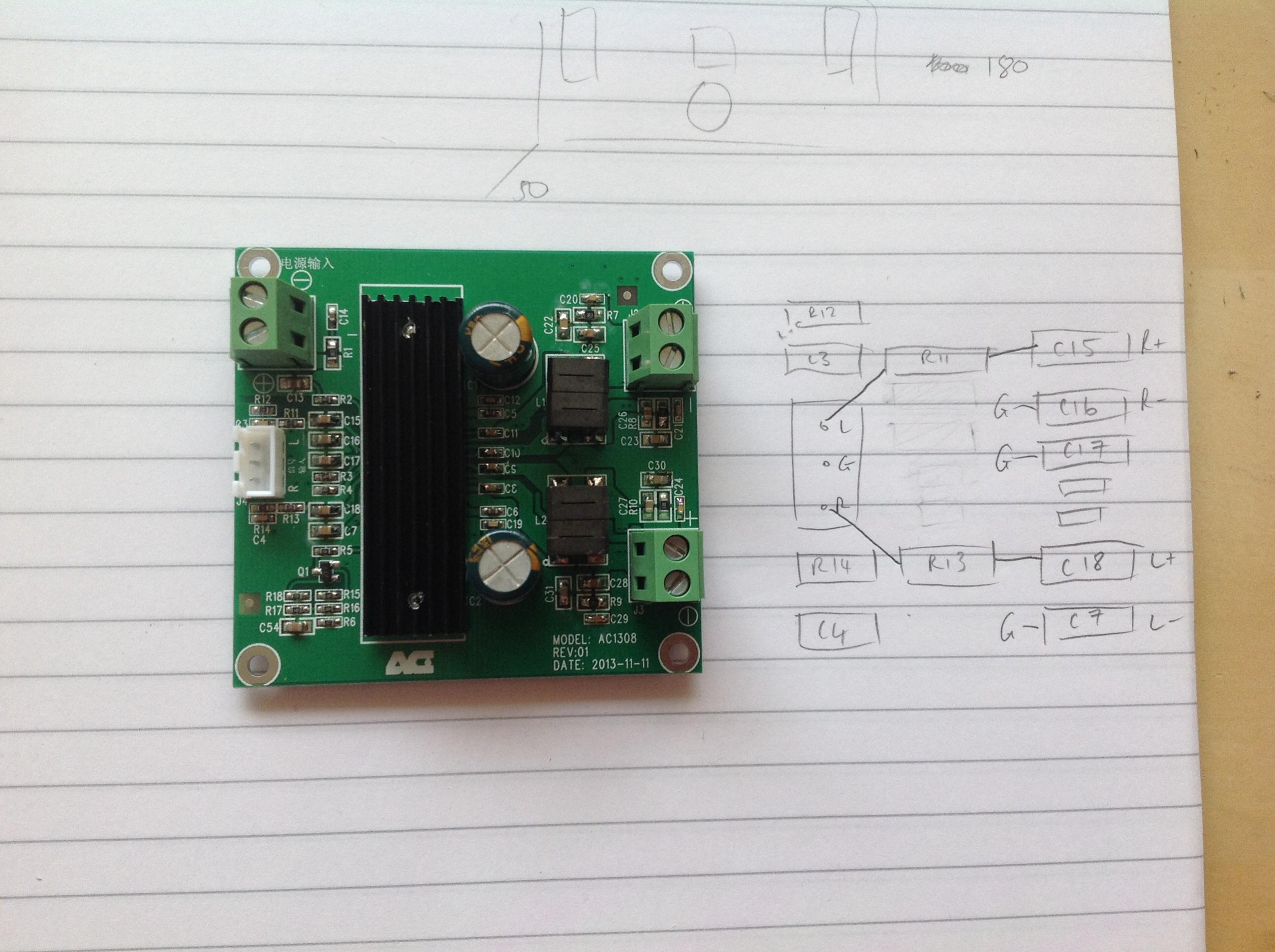

Audiobah TPA3116D2 input transformer connection points
For anyone interested in adding input transformers (or bypassing the stock input caps) to the Audiobah AC1308 amplifier pcb, you need to remove C15, C16, C18 & C7. The connection pads nearest the heat sink for each of these components are the balanced audio inputs to the TPA3116D2 chip.
C15 = R+
C16 = R-
C18 = L+
C7 = L-

I'm going to try these Nihon Kohden (Tamura) TTOK transformers on the inputs. The transformers will do unbalanced to balanced conversion, allow the input coupling caps to be removed, and provide galvanic isolation from my source. They might also sound quite nice and smooth 🙂

I thought that even in balanced input operation, the input caps are still used? I suppose in the case of using a balun on the input you do not need it to block DC, but doesn't the input cap also help to prevent input oscillation in conjunction with the internal impedance?
I'm not aware of any issues with oscillation that the signal input coupling caps address - can you explain more?
