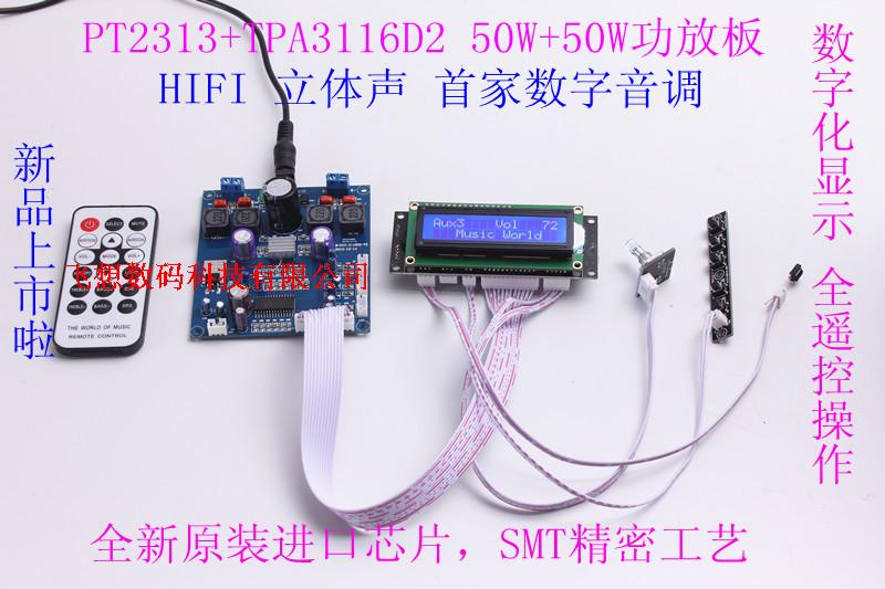

saw this on taobao. very impressive 🙂

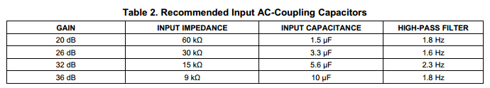

With a 1uF input coupling cap the -3dB points will be as follows for each gain setting:
20dB 2.65Hz
26dB 5.31Hz
32dB 10.61Hz
36dB 17.68Hz
It's commonly accepted that bass will be effected negatively one order of magnitude above the -3dB frequency. On this basis, I'd usually go for the following minimum input coupling capacitor values to keep the -3dB points at 2Hz:
20dB 1.33uF
26dB 2.65uF
32dB 5.31uF
36dB 8.84uF
To anyone experiencing poor bass, this would be the first place I'd look (and remember to adjust for any output capacitance at your source - either bypass that or scale up the amp input capacitor to ensure the two caps in series meet or esceed the target uF for the amp gain level)

I just modded a board last night and it is the first one where I altered the values of the input caps to more closely match the data sheet vis a vis the altered gain.
So, with a YJ blue board I upped gain to 32db and installed 4.7uF input caps.
--I couldn't find any WIMA caps in 22mm/5mm pitch with the required 5.6uF values and 4.7 was the highest I could find.
