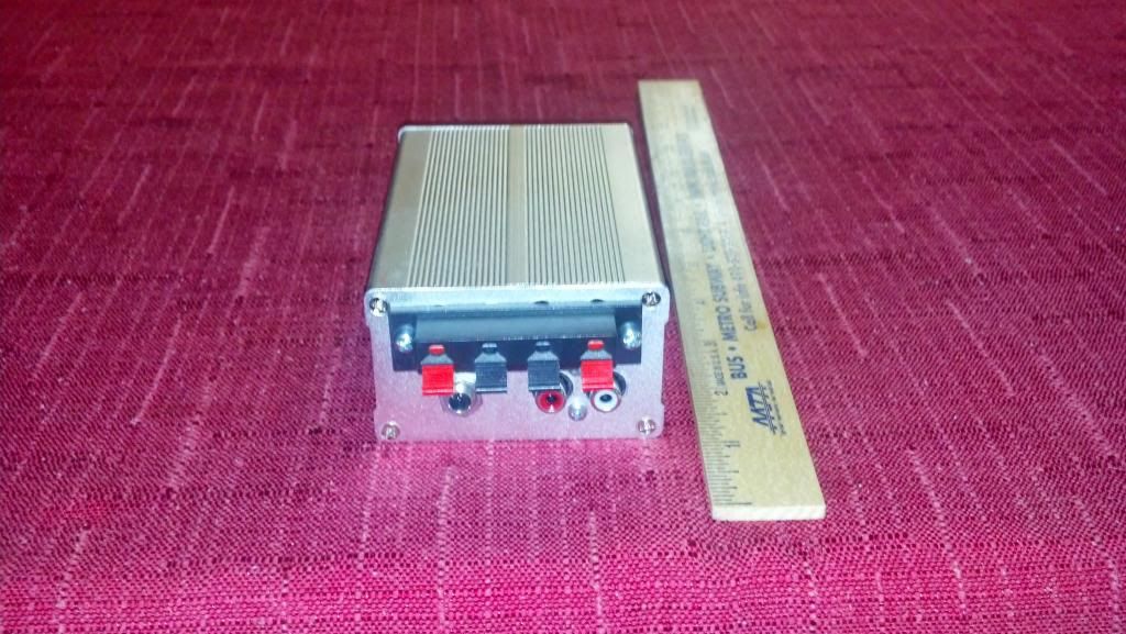

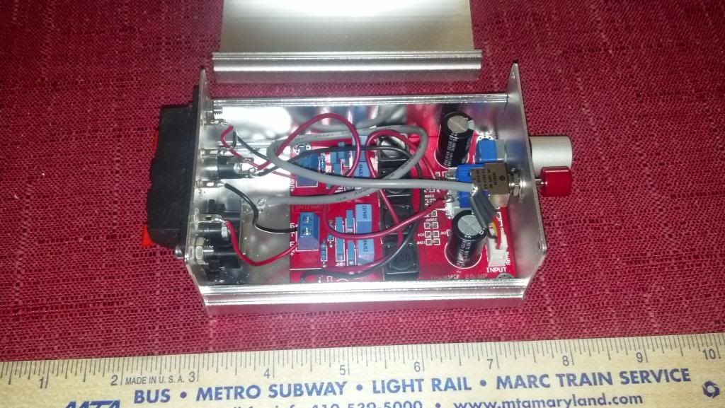

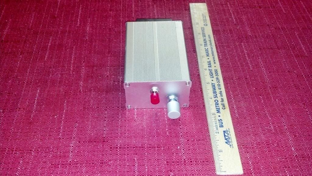

Another small YJ Red Board build
Just showing another case that fits the YJ red board. This case fits the YJ board perfectly, just slides into a slot, held in place by the nut on the volume pot. This case is pretty common on that auction site (I can try to find a specific listing).

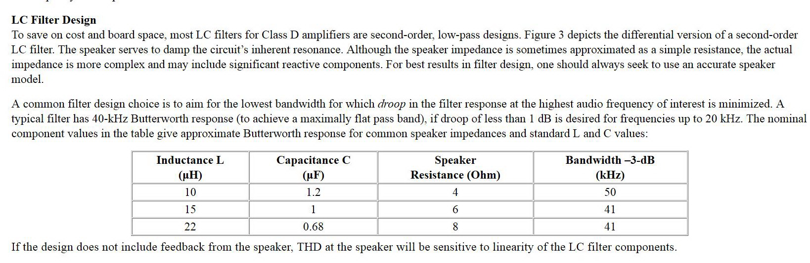

mmm the wiki should not tell 22uH is optimal for 4 ohm and 10uH for 8 ohm, that is confusing and not true
There has been a small amount of confusion with the data from TI.
The data sheet says 10uH for all loads but the demo board lists 10uH, 22uH, or a ferrite bead on the schematic and 10uH in the BOM and has a picture of the board showing 22uH.
I am using 10uH.
This paper on Class D design goes back a few years but is still very useful.
Here's an excerpt pertaining to LC Filter Design.
I wonder if they were running 400kHz+ at the time.
-3dB points of specified filter doesn't differ if chip is 10kHz or 10Mhz
But the whole point (in SMPS as well) is the higher the frequency the smaller the inductors.
If I push the 3dB point from 40kHz to 80kHz it will still get rid of the switching frequency to a level that is acceptable to me.
And if 400kHz is too low the 3116 can go to 1200kHz.
