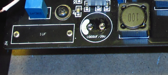

I was looking at my YJ blue board tonight, and noticed this "blemish" on the board. Look at the center of the picture, the area of the board bordered by two inductors and the blue capacitors. Looks like something leaked onto the board. I don't think I was eating while I built this. 🙂
Could one of those caps have leaked? Could this be related to the no-input-hiss problem described above?
