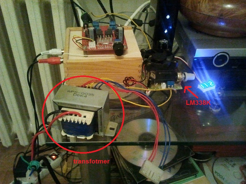

For the LM338 you need a transformer stronger than the target voltage. There potentiometer through which you determine how much will be volt output.
I had an old transformer so I bought the LM338 so I can try it on other amplifiers. I am happy with the result.

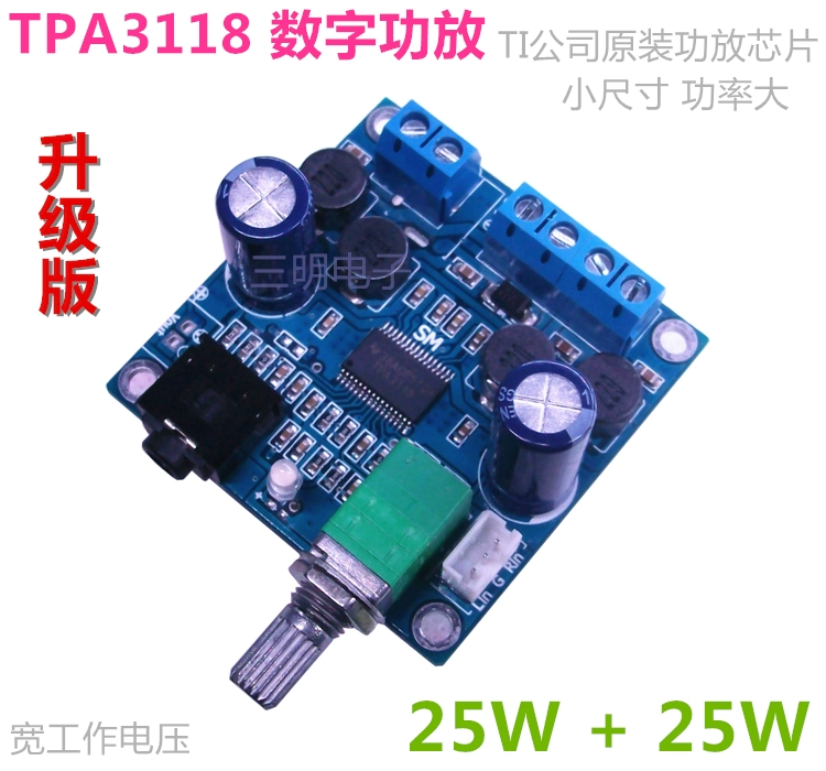

This has got to be the best deal in class D amps right now. This board even has a transistor (presumably for anti-pop turn-on/shutdown ?), and a power on LED! It claims to be stereo/mono capable too -how to set PBTL I wonder?
TPA3118 numeric 12V power amplifier board finished board /with switch potentiometer /Parallel Mono - China shopping? taobao agent ?Buy from China shop online website

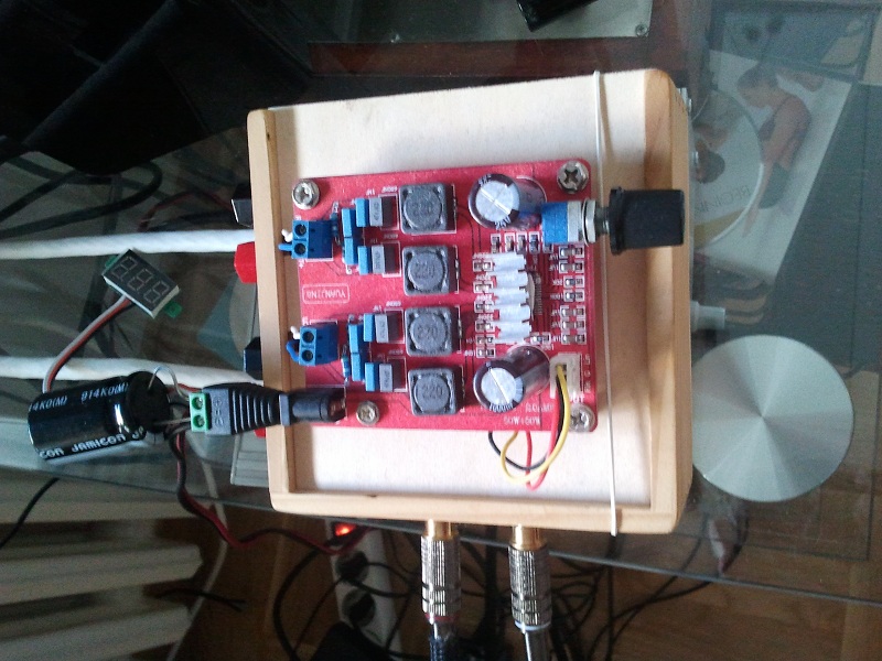

Here's my red Yj board build.
Mounted it in a nice metal case. Quick and dirty.
Used an old laptop smps rated for 19.6v and 5 amps.
Problem, first time i ran it, the signal would cut at any mildly loud passage.
I then added a coule of 4700uf caps in parallel with ones on the board.
Things improved, but it would still cut out.
I things it's the smps's hard current limiter, but as i write this, i'm thinking this can't be right because even after i turn off thenpower to smps, the amp keeps running for 5 to 6 seconds.
Any idea about what might be happening?

Sounds like it is tripping thermal shutdown or a cold solder joint on one of the main speaker out leads. Check solder joints on output pins. What is impedance of speakers? Low 2 ohm loads may do this - probably not your PS.

It's silly but are you sure that there are no short circuit between the downside of the board and the metallic box?
Have you checked the solder joint of the board, especially those on the potentiometer?
Oops, sorry, I haven't saw that XRK971 has done the same suggestions before 🙂

Good deal ... but the high freq power-supply SM caps are too far away from the chip and the output caps aren't as close as the "wiener" from a few pages back.
