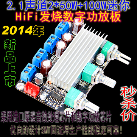

Dang, that is a small 2.1 amp! It would be nice if one of those knobs controlled sub XO low pass frequency. $14.19 Yuan to Dollar conversion. Question is what is the Taobao middleman charge?
Edit: careful reading of silkscreen shows pots labeled as "Tre", "Vol" & "Bas"... no such luck on variable low pass freq. I wonder what the fixed freq is then?

New versions alert! On Taobao
TPA3116/2.1ÉùµÀ´ó¹¦ÂÊHIFIµÍÒôÅÚ/Êý×Ö¹¦·Å°å³¬TDA2030 LM1875-ÌÔ±¦Íø
Can someone translate what it says?
Here it is:
This is a HiFi digital amplifier board. New product for 2014. The board uses authentic import digital audio chip for amplification. Excellent design that employs SMD flow soldering technique for the manufacture, high reliability.
On their website, they claimed that patents have been filed on the appearance and circuit design of this board. This 2.1 board does look a bit different as compare to the others. No SMD inductors (as filter) can be seen. What is that chip at the lower left corner (cannot make out the the numbers and characters)?
xrk,
Actually, I check the Mister Tao (TB agent) link on the charges and it is actually quite good! There is no mark up on the price, only a 8% commission which I think is fair. Here is the break down:
Amp price (14.43 US$) + domestic shipping + commission(8%)+ international shipping ==> total 19.91 US$ with China registered air mail or 20.40 US$ using Singapore Post air mail (which is faster).

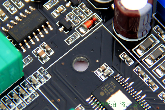

Detail new tpa3116
Gasp, what's this I see 😱
Is that as-close-as-possible hf SM powersupply bypassing ...
Bring, bring, Mr Tao?
