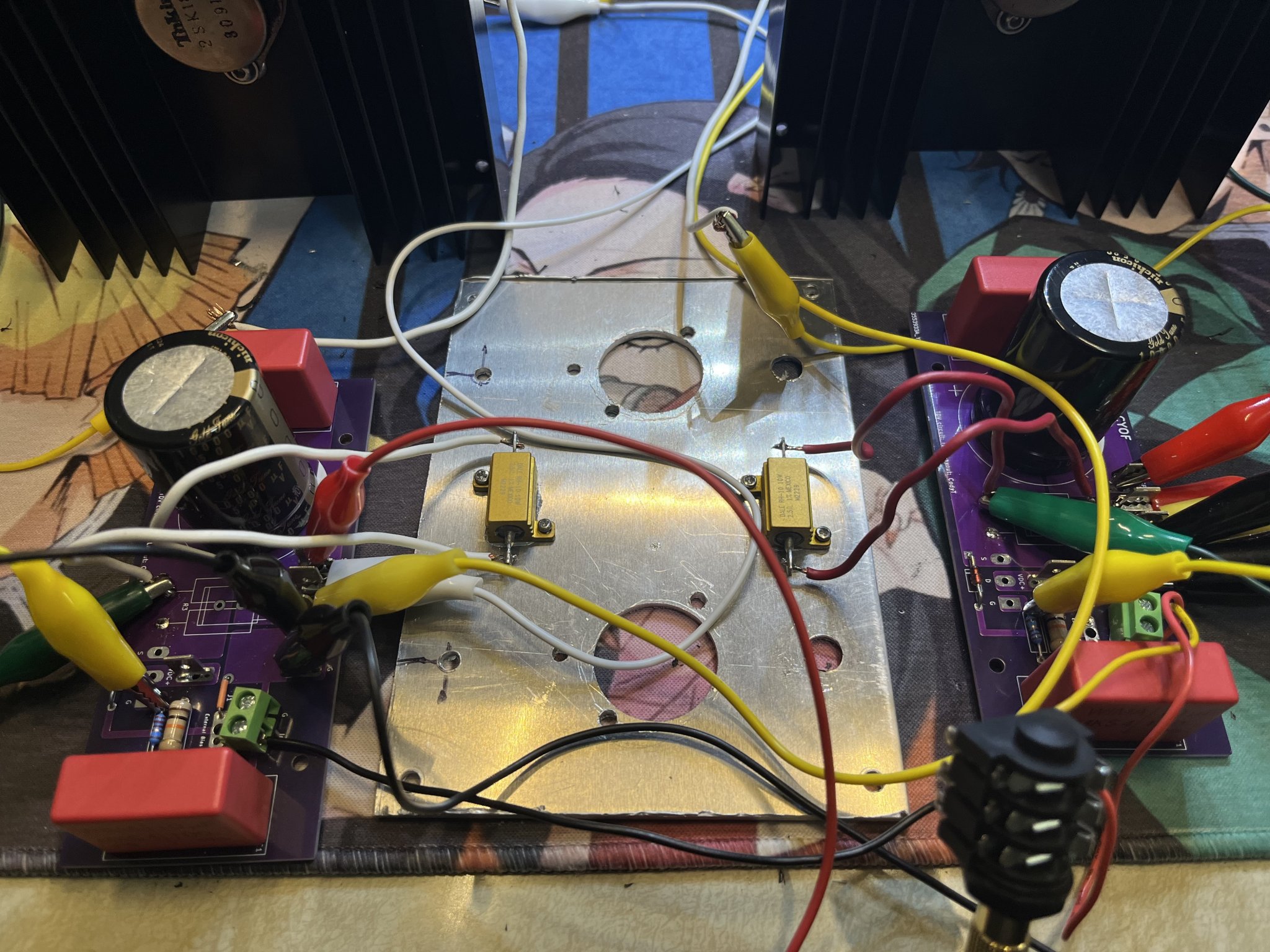

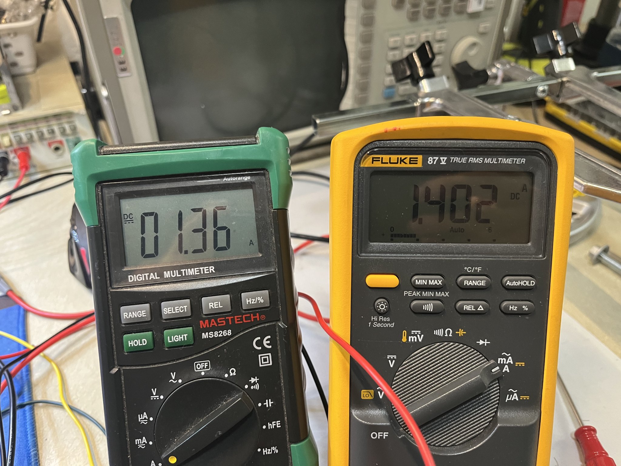

So your r3 dissipation is 1.6A*1.6V=2.56W. I would just keep an eye on R3 for heat and long-term reliability (didn't see the size of sink you used – you may be plenty fine)Okay, so if you measured 1.6V across 1R then the bias is 1.6A. You could go higher if your heatsinks allow. How does it sound?

The R3 sinks are small aluminum ones for TO220. They should suffice. I included a little Keratherm on them.
On that note, it might be feasible to mount such power resistors to the big heatsinks. However, that would require drilling into the sinks again. Not pressing my luck there, either, since my last foray put the Tokins so far south they’re wearing shorts and flip flops.

I opted to go with 2.5R 10 Watt chassis-mount resistors for the bias. I originally had paralleled two 4.7R 5W resistors but the current sharing was unequal and resulted in one resistor getting wildly hotter than the other. With 1.4A bias the resistors dissipate about 5W, which is well within the unmounted limits of the new resistors. This is for the 2SK180.

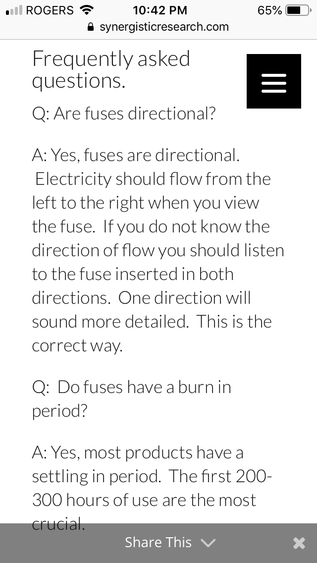

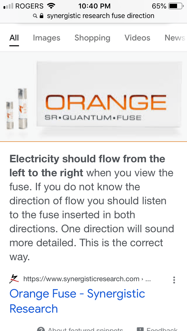

These fancy fuses are usually not CSA/UL therefore your unit is not well protected and can become a hazard. You are better off using regular certified fuses.
My comments was for the fuses some manufacturers sell for $30 per fuse and are so called audiophile type.... this is a gimmick.
Yeah, those are bogus. There are some costing more:
https://www.partsconnexion.com/FUSESRBL-83101.html
OMG, you just made my day !
The people writing stuff about these fuses are too funny (I’m being polite) see below...
So LITTELFUSE is a suspect manufacturer of fuses? How do these fuses have anything to do with ORANGE fuses, and the like, which have the same steel end caps as regular fuses?
