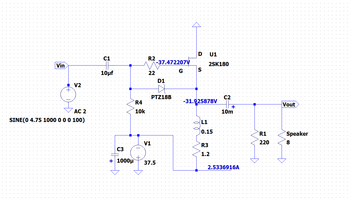

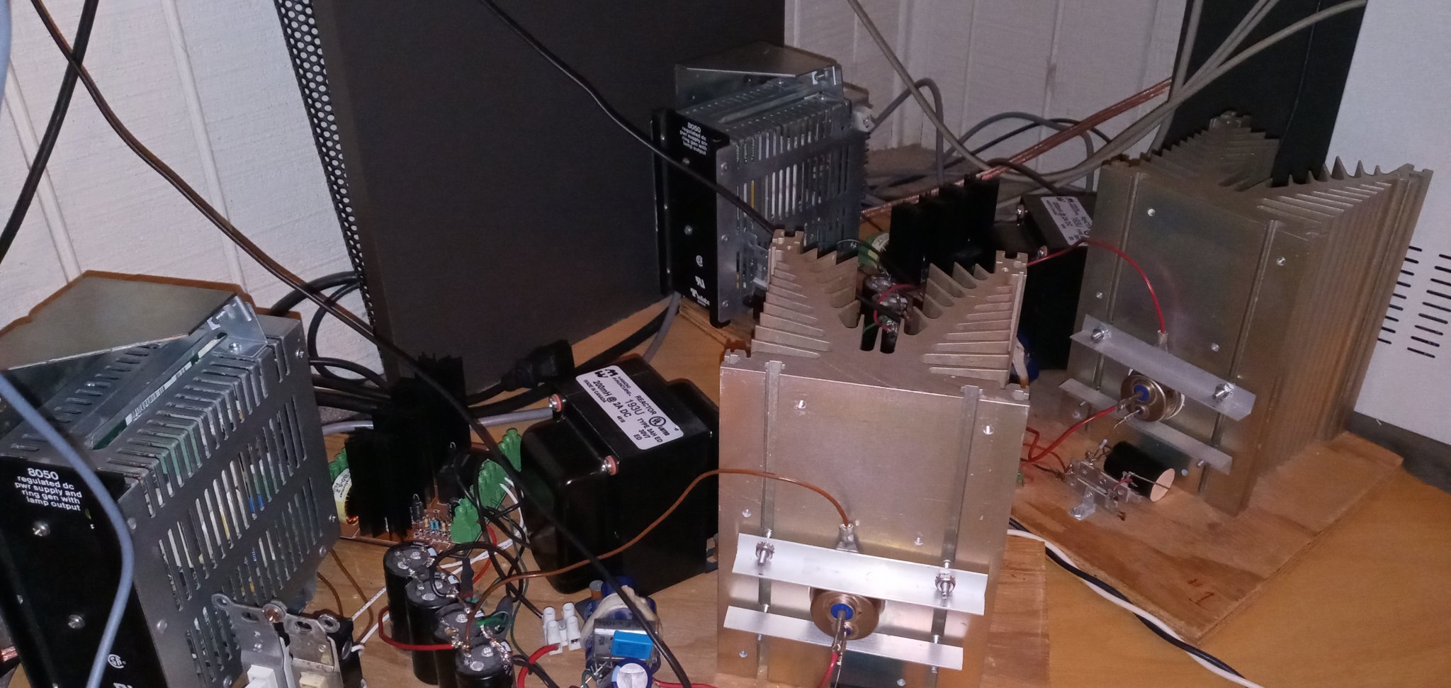

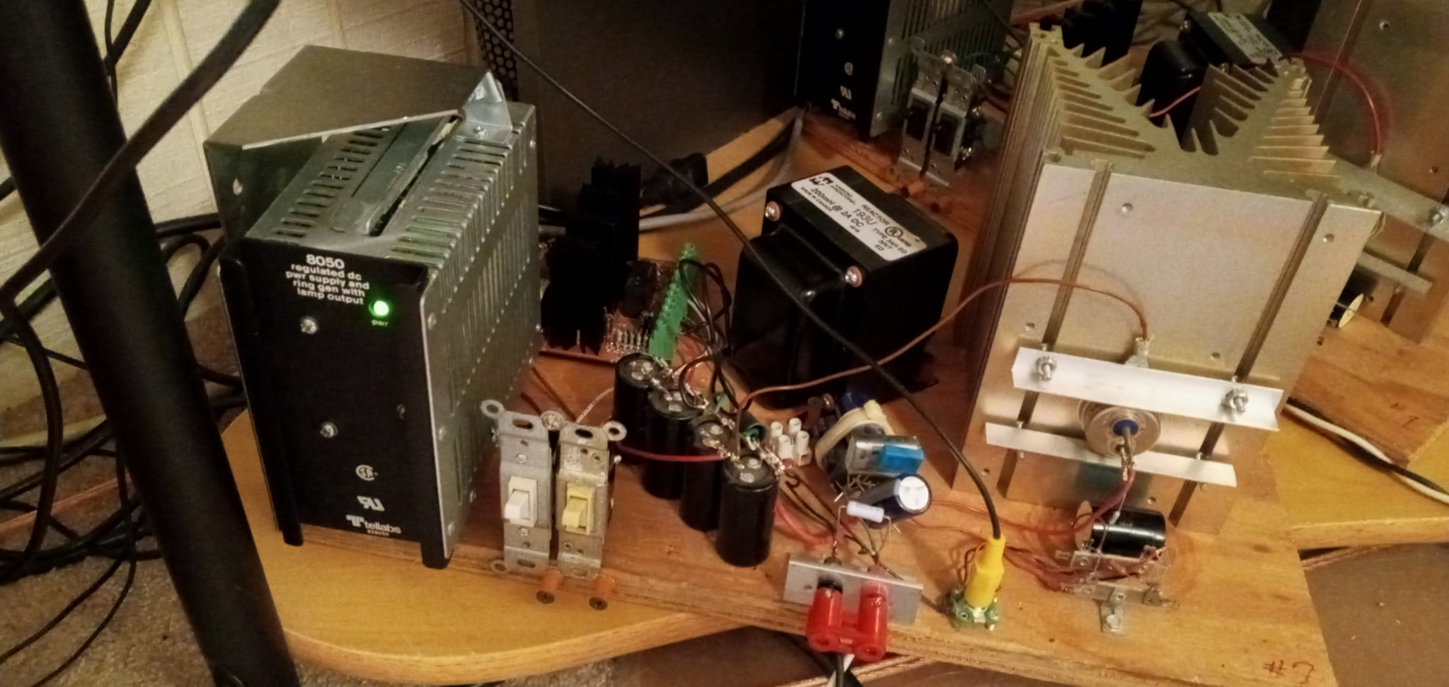

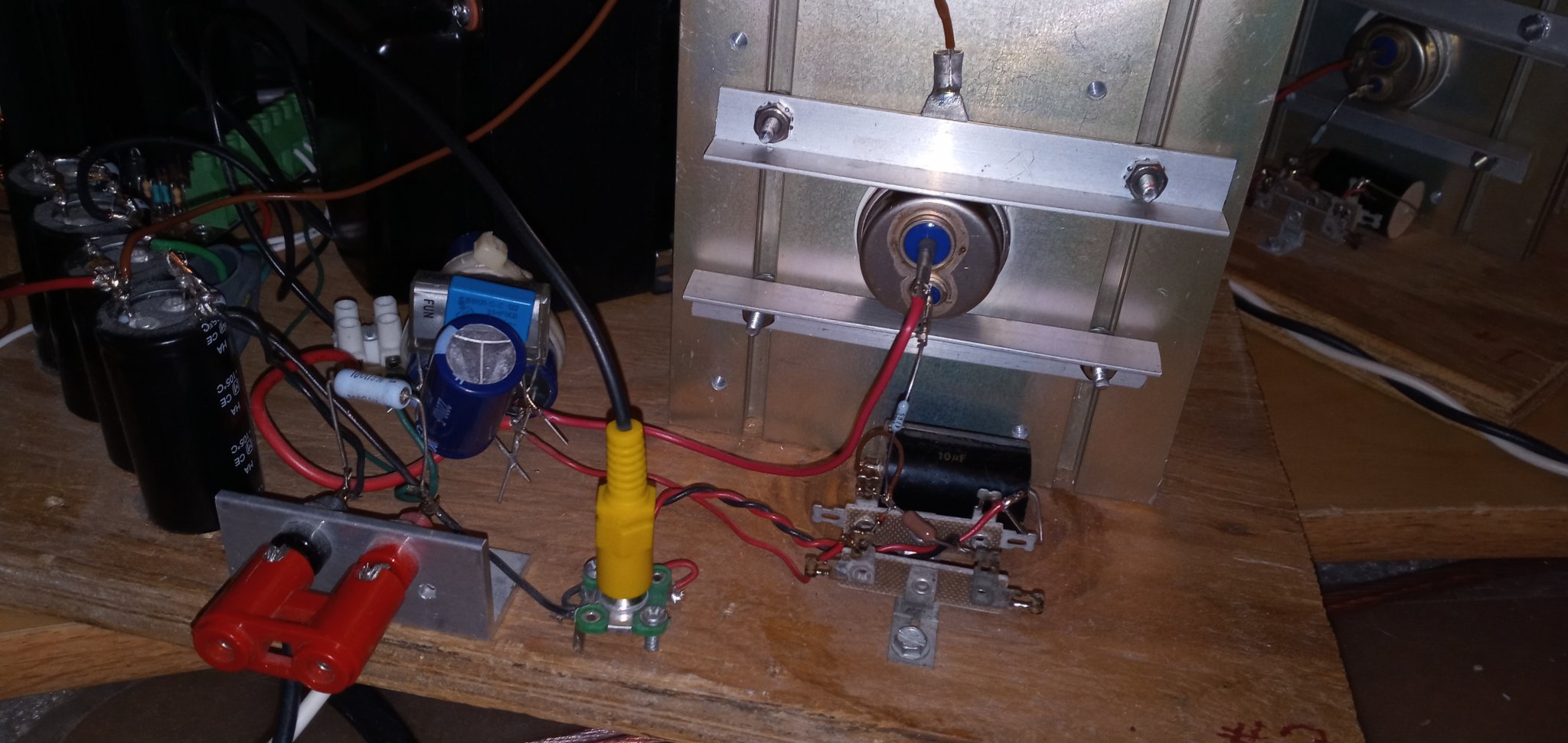

I had these Hammond 193U chokes, series resistance 1R7 and thought why not?

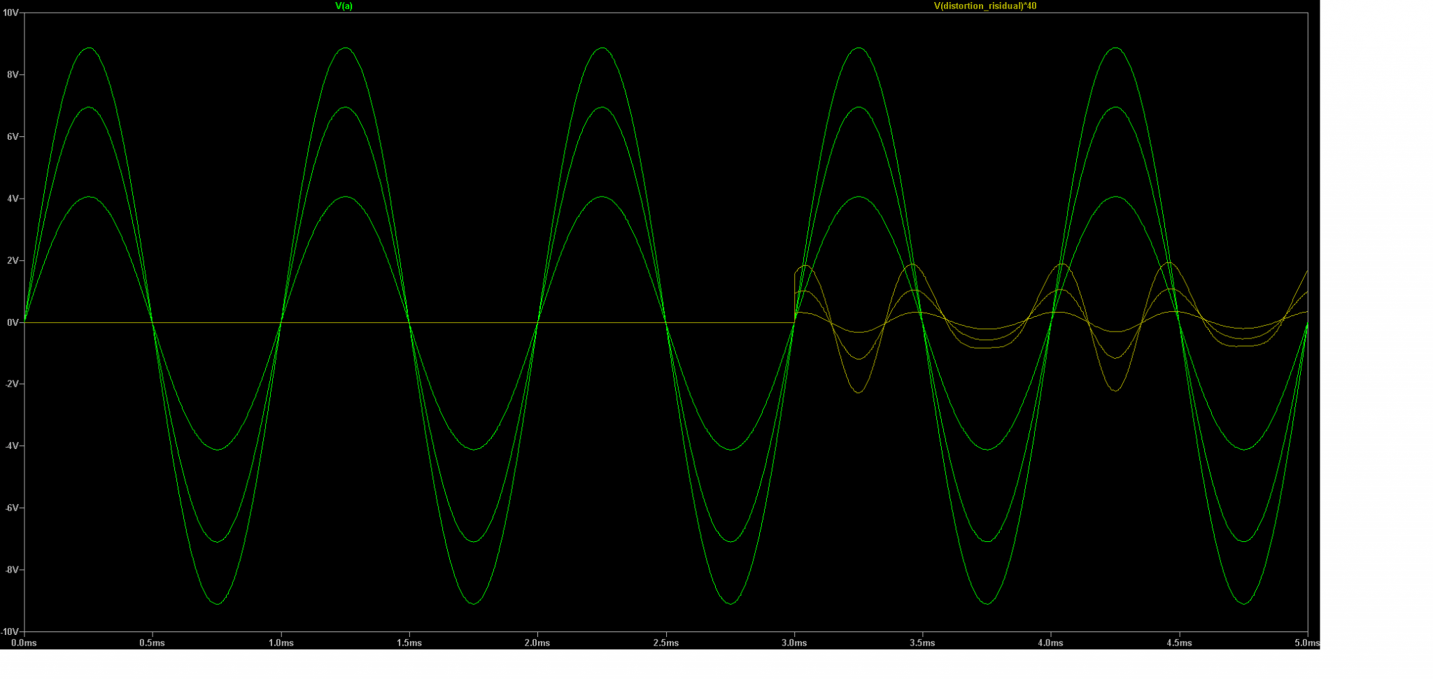

Sim is 1W, 3W, 5W.
Shot for 18 or so volts across the SIT. 3V or so across the choke... 21.3V in does the trick.
The only adjusment is the power supply voltage using Mark's Tuba boards.
Easiest amplifier build yet and it sounds great. Transparent and with what I call organic bass.

Love that. Awesome build. Even simpler with no resistor. Totally agree about organic bass. The thing I have not heard on any other amp so far is the resolving of bass decay sounds and resonances. It tells you the full flavor of the instrument and how skillfully it is being played.
I see that you went with a negative supply and drain grounded, Papa recommended!
I am planning a big TDV with the 193V and may end up with no resistors either.

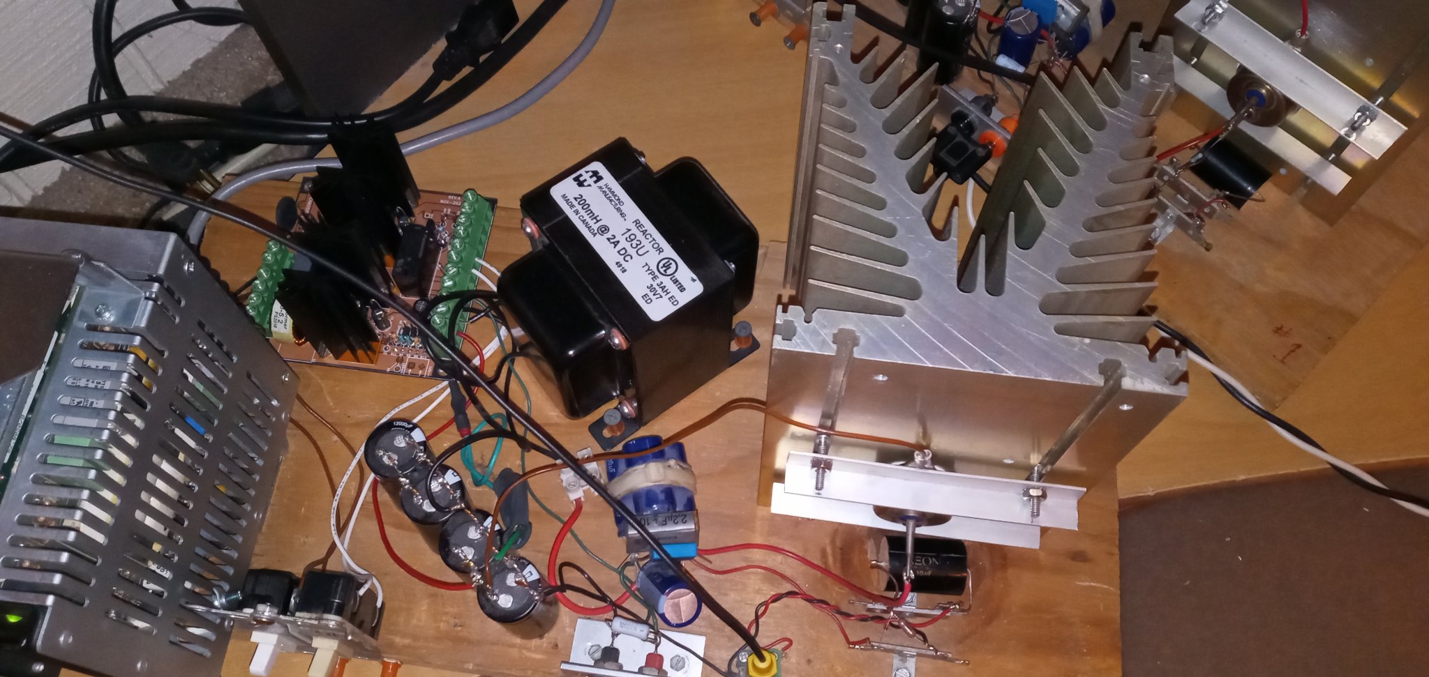

Actually built with a positive supply because that's what the regulator boards are. Noise is very low though.
When I build into chassis, I may look into designing a negative version of Mark's Tuba... abuT? :rofl:
193V only 1 ohm. 🤔
That looks like quite a big heatsink. If your power supply is capable, and the THf-51S is certainly capable, you can run even higher voltage. I run my 193V loaded 2SK180 follower at Vds=35V, Iq=2.5A and it sounds great.
I have V+ also and I don't hear any noise from my 103dB speakers.
I think all SIT followers have great sound. 🙂

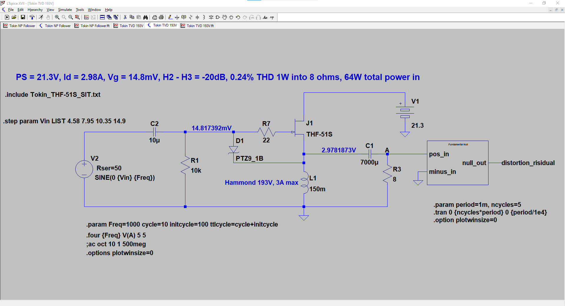

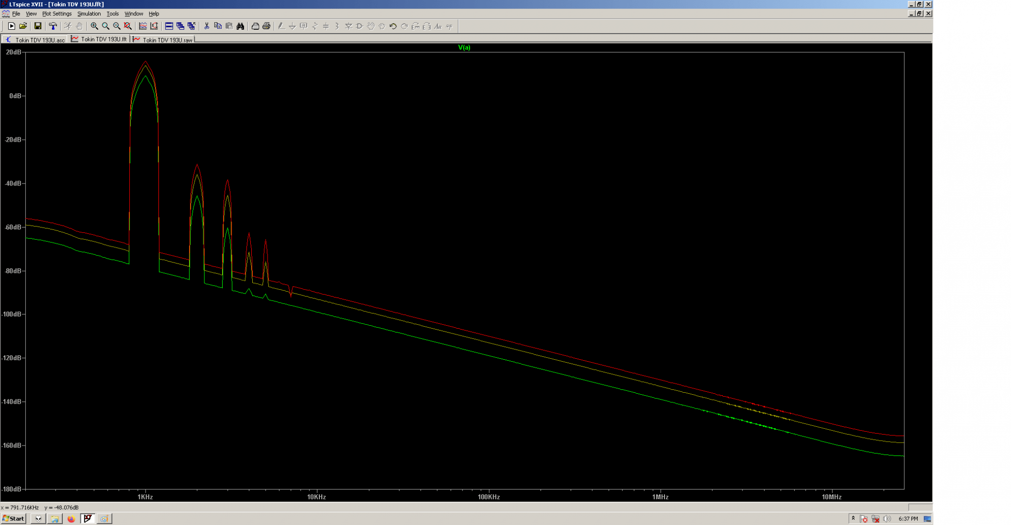

Hmm... only change is choke to the 193V and nothing else and presto-change-o... 3A bias. Sim is 1W, 3W, 5W, 10W 😎
Too bad my power supply can't handle it, plus Mark's Tuba regulator would need bigger heat sink too.

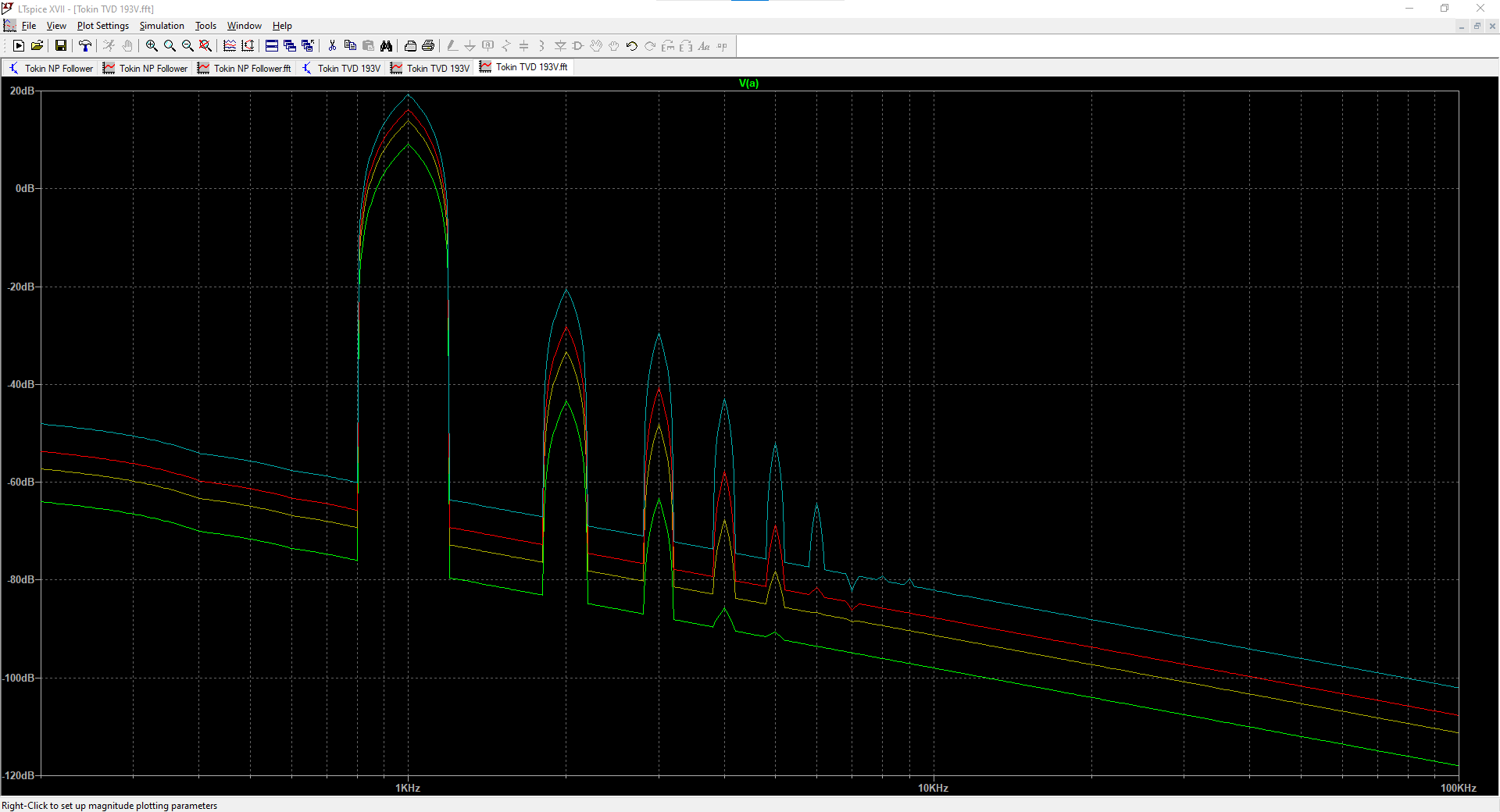

Pros: more power out, better harmonic distortion profile (more H2, less H3), easy THF-51S amp build.
Cons: THD 2x more at 1W, chokes weigh 3 lbs. more each (ouch my back!), about 50% more power consumption, 193V now $103 each (ouch my wallet!).

If you can go higher in voltage, say 28V or higher, you will get much lower distortion. Current will remain below 3A. I think that it would be worth building a bigger power supply.
Edit: Oh, just realized that Ben Mah already mentioned this.
Reactions: ra7
Great sims Cinco! Yeah, higher voltage might yield better results but will also cost you on the heatsink. But the great benefit is more power :devilr:
My little TDV was not enough in the Burning Amp space, which was about three times my home space. If 5W is all you’ll ever need, don’t bother with the higher power. But if your speakers crave more power, then this is an option. The Tokins can certainly take the heat.
Also, the TDV topology is the most efficient and has the lowest heatsinking and PS requirements out of all the other options (resistor, light bulb, CCS, and Muff).

If you have a big choke, like the 193V, and a big sink or active cooling, you could drop R3 altogether. But this should be done very carefully. Cinco ran sims earlier and with an Rdc of 1 ohm for the choke, it came right in the 3.0A zone. But it needs to be tested for stability. And you want to definitely ramp up the supply with a Variac and keep an eye on the current as you bring up the voltage.

I have found that the Tokin SITs that I have used, 2SK180 and THF-51S, have Vgs that vary greatly from sample to sample. So it would be prudent to start with a higher value of R3, monitor Iq, and then adjust accordingly. And as Rahul said, use a Variac.

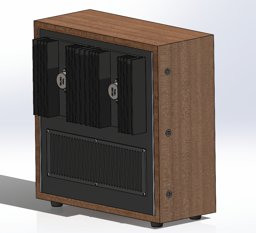

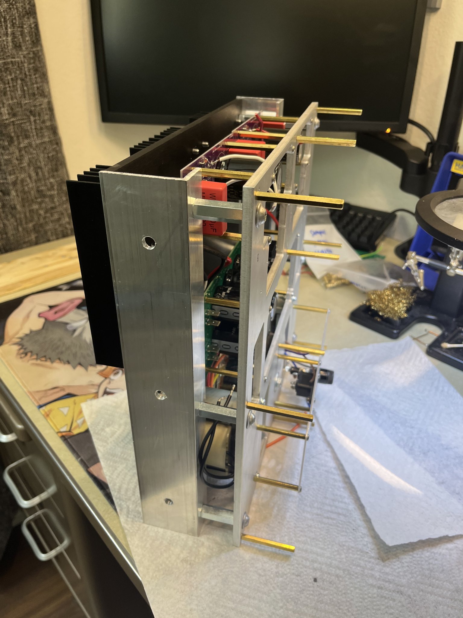

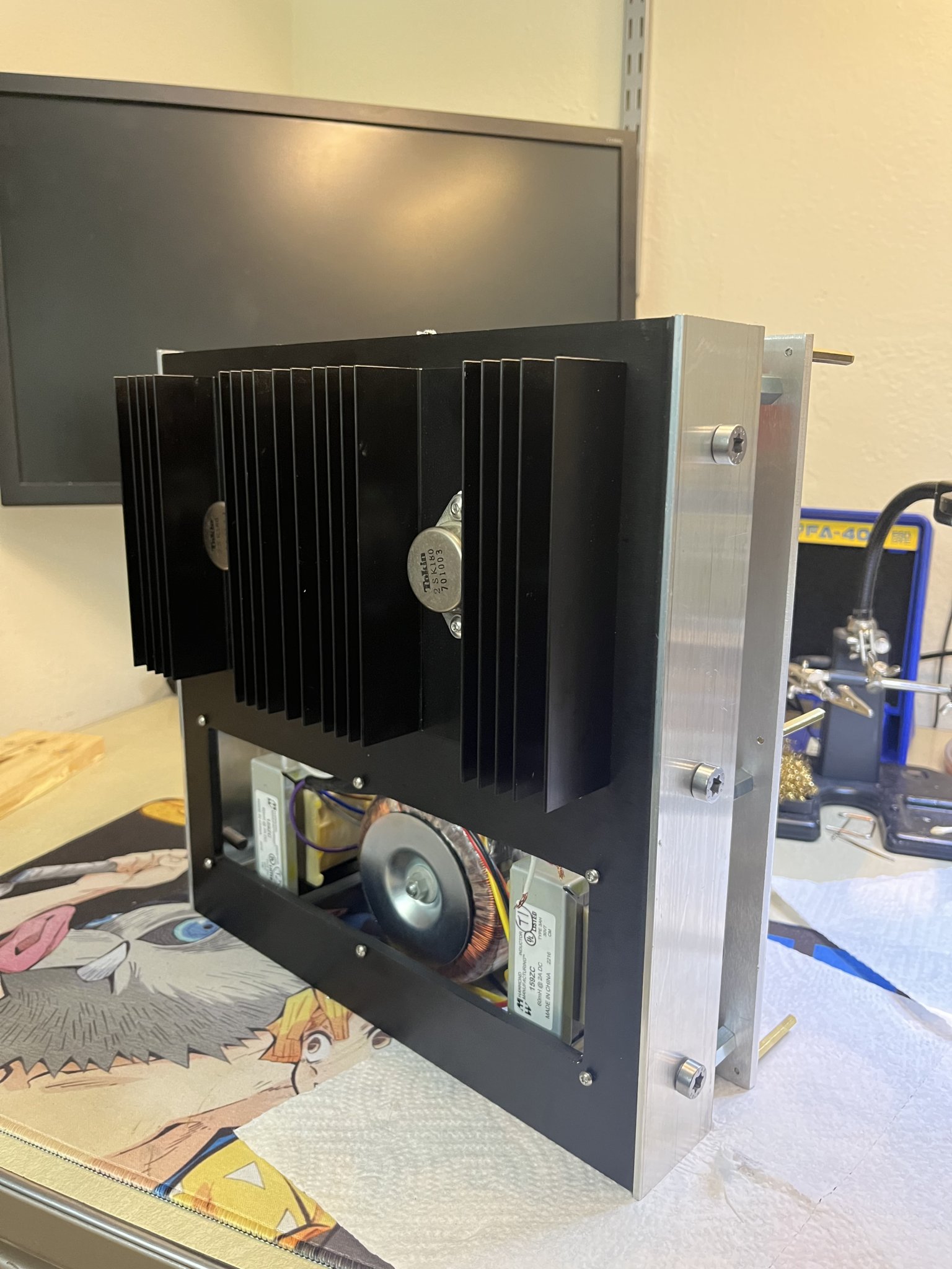

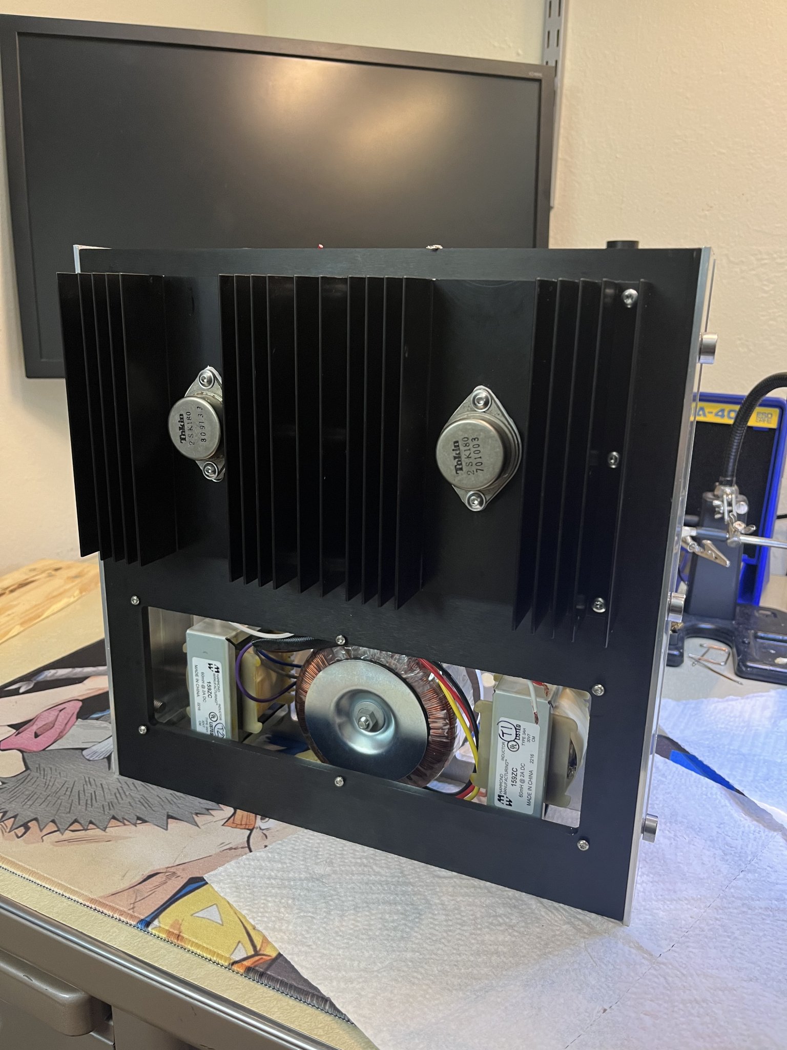

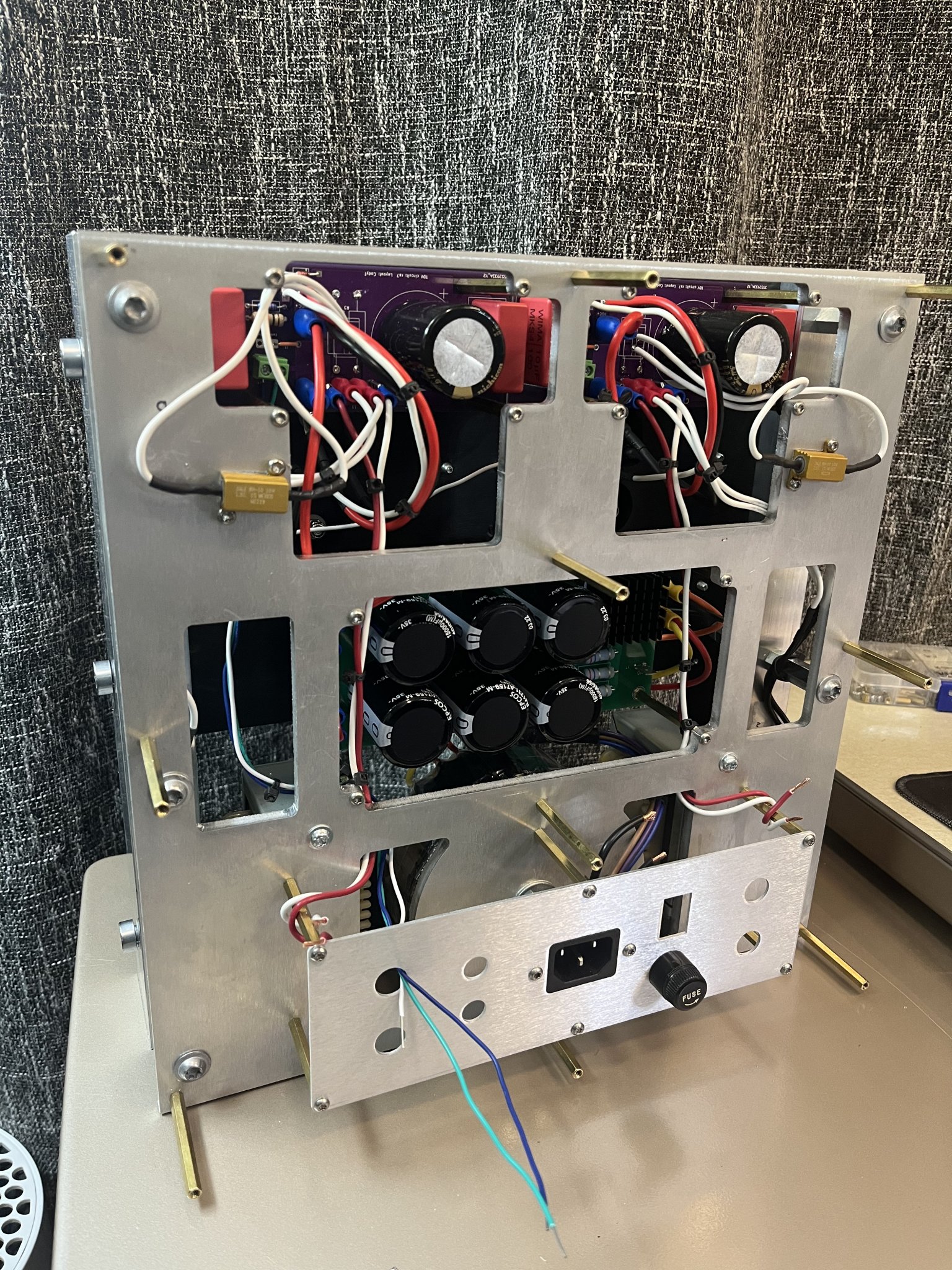

2SK180s mounted on the chassis. Sheet metal was finished by Send Cut Send and I scrounged most of the hardware from my work. I decided to do something a bit different and make a vertical amp for a change.

Given the way that the finned heat sinks are attached to the larger aluminum front plate, which is attached to the side L-brackets, there may be just enough total area to keep the SITs at a reasonable temperature.
Those devices are pretty robust. The proof will be uncovered once the bias current is set.
It is a fairly novel approach to the chassis. I am rooting in favor of it working. :up:

Papa’s do it by the hand approach is very effective. If you touch the sinks and can’t keep your hand on it for more than 5 seconds, it is probably not enough heatsink. The hand has a non-linear relationship with temperature. It goes:
Warm
Hot
Hotter
Whoa, that’s hot
:cuss:
You want to not go to that last step 😆
