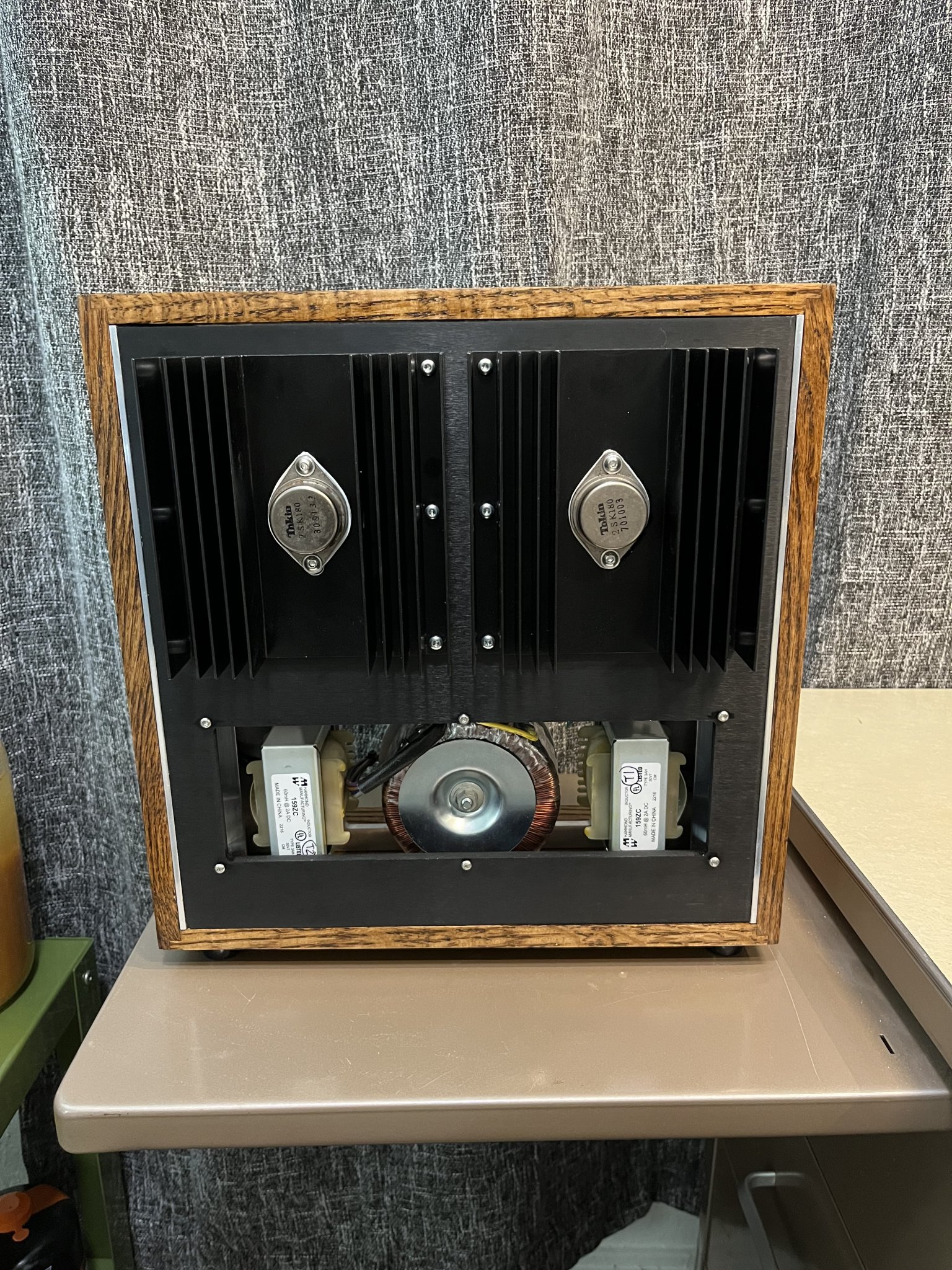

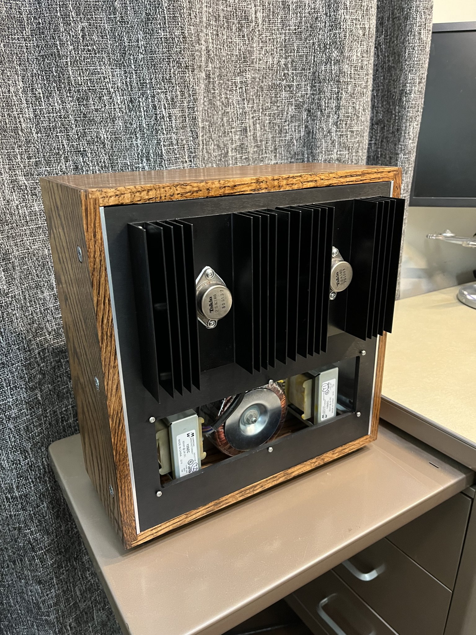

If I am correct and there are slots lower down shown in the rendered image, (if not one could considder adding them in the box's base) I would suggest that a way out for the hot air in the top of the box be found/added. Wood is quite a good insulator after all. This would then in effect act as a heat chimney similar to the early Sony VFET amps.

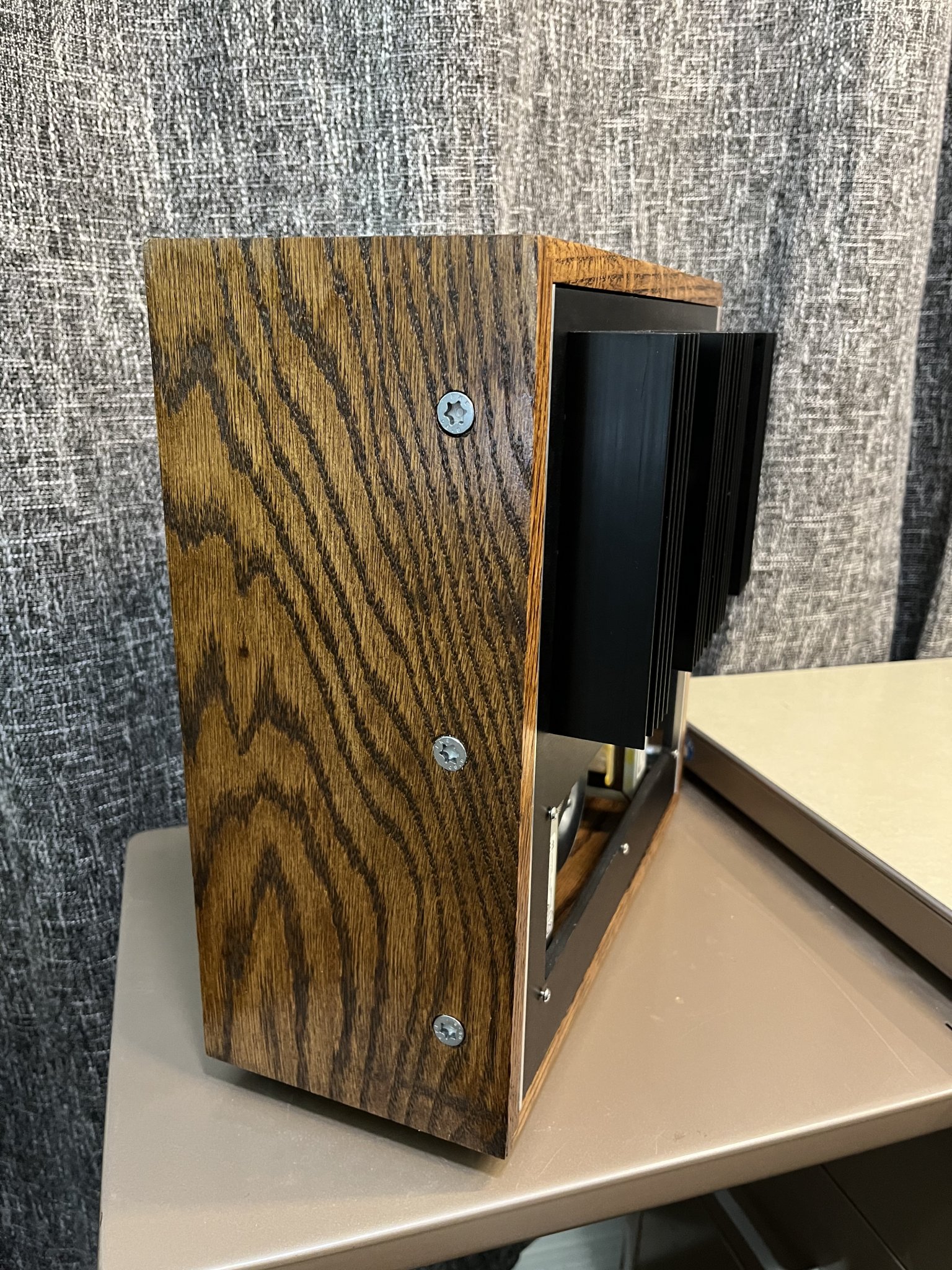

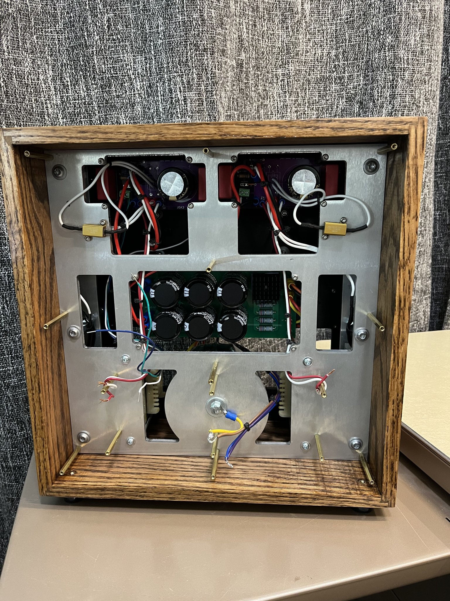

Oak wood case has been finished and the chassis mounted within. The chassis assembly slides into the box and is fixed by the 3 screws on either side. Still need to wire up the I/O shield and get the front grill and backplate fabricated.
Would have finished up the wiring tonight but a sudden nasty bout of food poisoning mid-soldering derailed those plans… Feeling a bit better, but impatient to get this thing done!

Oak wood looks superb! Difficult to bring out the grain like that, IME
Really neat build.

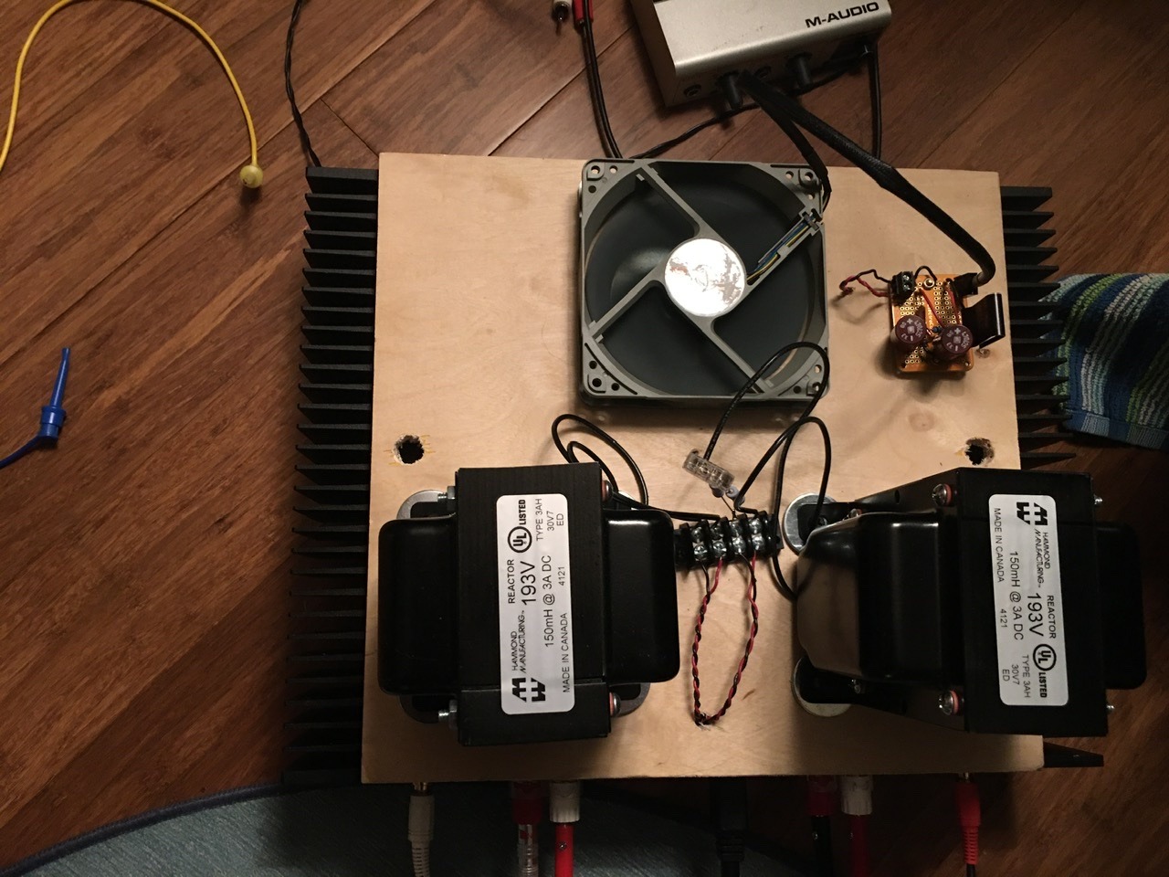

Those heatsinks are not going to be enough I suspect. Did you have a plan in mind? Might want to add some active cooling. I am trying things out with the 193V and more bias and for that I added a fan. Works like a charm. Running it off the amp supply and a 12V zener follower. Now my sinks are cooler than even at lower bias. I’ll post some pics.
I’m interested to see pics of your fan setup. I’m prepared to add some fans and additional sinks if the current setup doesn’t pan out. I think I will be right on the edge of acceptable, but we shall see.Oak wood looks superb! Difficult to bring out the grain like that, IMEReally neat build.
Here's a pic. The heatsinks are 12" x 3". The devices are right down the middle on the sinks. The fan is mounted midway across and to the top, away from the devices. There are two holes on the top just south of the devices, with the idea that air is drawn into the chassis from the holes, moves near the device and is exhausted from the fan. There is no other ventilation holes and earlier, at lower bias of about 1.7A where the heatsinks got hot, I simply operated it with an open top.
Using the big 193V inductor, it biases at 2.4A on one channel and 2.0A on the other. This is because my 2SK2087s are not matched, as I'm sure is the case with nearly everyone and any SIT. I connected 0.23R across the one with more bias to bring it down to 2.0A, whereas the choke alone provides the bias on the other channel. I am doing more listening and figuring it out at this time, but the bottomline is that you are not guaranteed to get to 2.5 or 3.0A with every device using the 193V under this topology. A choke with a lower DCR is needed for higher bias. You might luck out and end up with two devices that both bias up to 2.5A or some other value and then you'll be golden, but it is not guaranteed. Also, be prepared to use resistors along with the chokes at least on one channel to match the other.
So, that's about 2A x 25V on each side, which is about 50W. With the fan (Noctua 120mm from Amazon), the heatsinks are just about warm after one hour. It is quiet but it makes a ringing noise that is audible during complete silence. Maybe it is the side holes ringing due to airflow, but I could do without that noise. If there is another chassis, like the store chassis, with numerous holes, fan venting should work great. I think ZM had designed such a babysitter that goes under the chassis and draws air out.

So, I let the amp run for around 10-15min taking temperature checks with my laser thermometer periodically. My confidence in my measurements isn't high, as the temperature seemed to fluctuate wildly within millimeters on the same surface, and with changes in deflection angle. Generally, the temperature appeared to be 120-150 degrees F on the top of the 2SK180 cans (although I saw some jumps to 180F-200F, perhaps error due to reflection but concerning to me nonetheless). I could only hold my finger on the tops for about a second before I had to pull away. Surrounding heatsink was warm. Devices are passing 38-40W each, and the thermal pads are likely too thick. I think I will take some 120mm computer fans I have on hand and try the active cooling approach.I’m interested to see pics of your fan setup. I’m prepared to add some fans and additional sinks if the current setup doesn’t pan out. I think I will be right on the edge of acceptable, but we shall see.
200F as case temp, which would be about 95C might be on the high side but not too far off. My case temps have reached 85-90C, but the heatsinks were screaming hot by then. So, it might be too little heat transfer through the pad as you suspect.

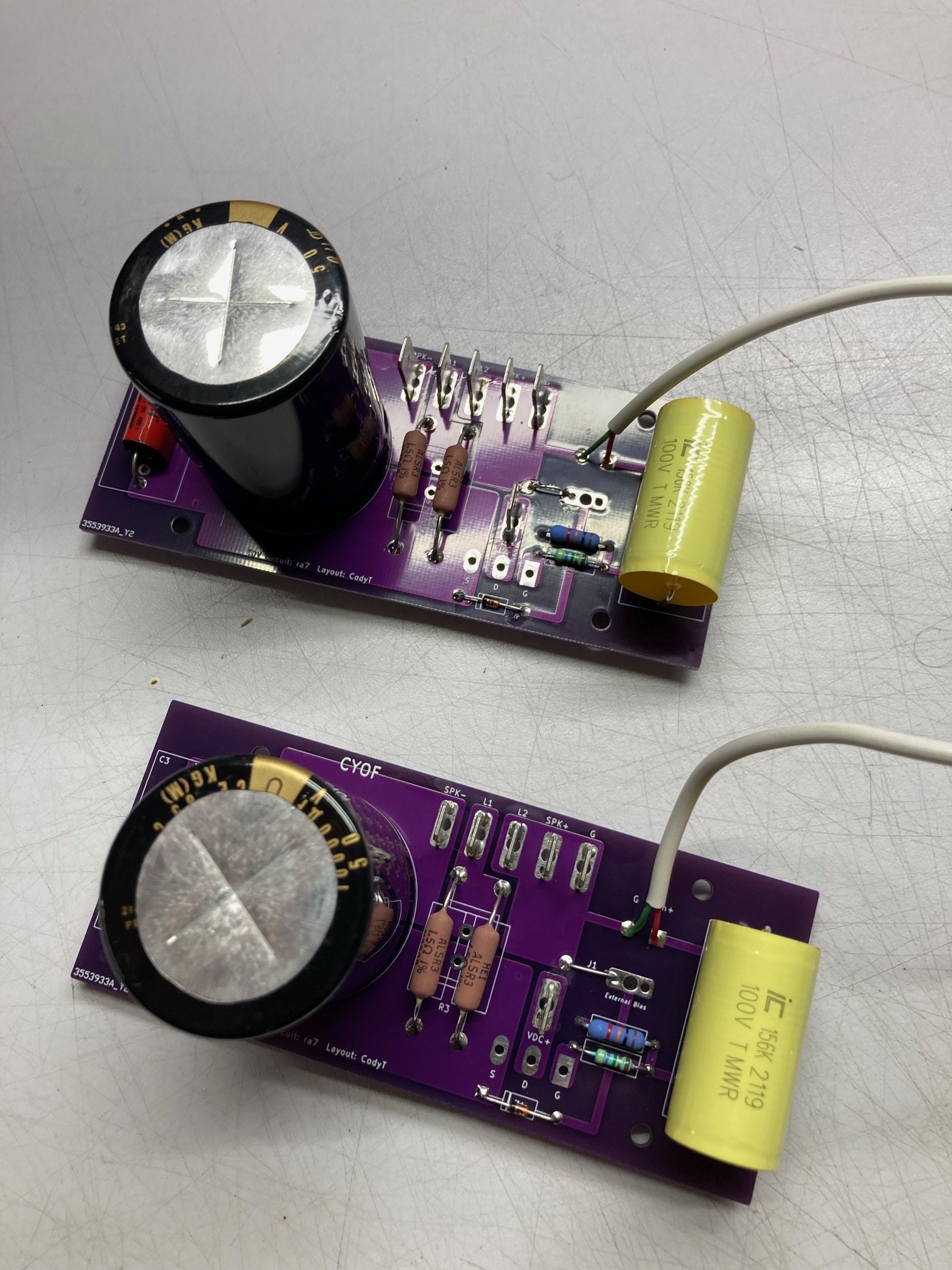

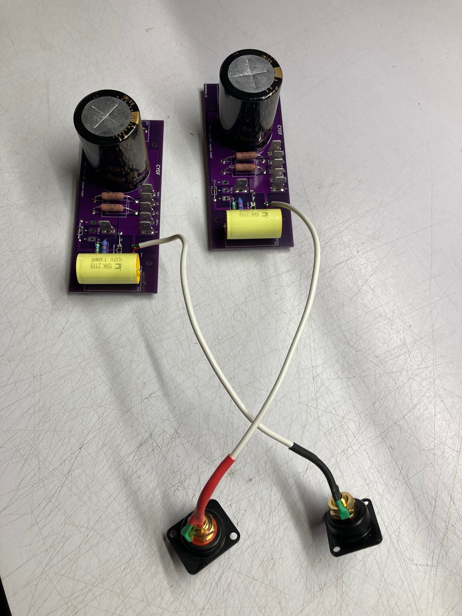

A rainy day soldering project, the beginning of something. My chokes have a DCR of 0R3-0R5 depending on whether I believe the spec or my DVM, so R3 will bear the burden of setting bias. This 3W of 0R75 is just a placeholder until I figure out the power supply & layout. I may do these as monoblocks with the PSU separate, either laptop bricks or a linear supply in a separate box. Early days.
