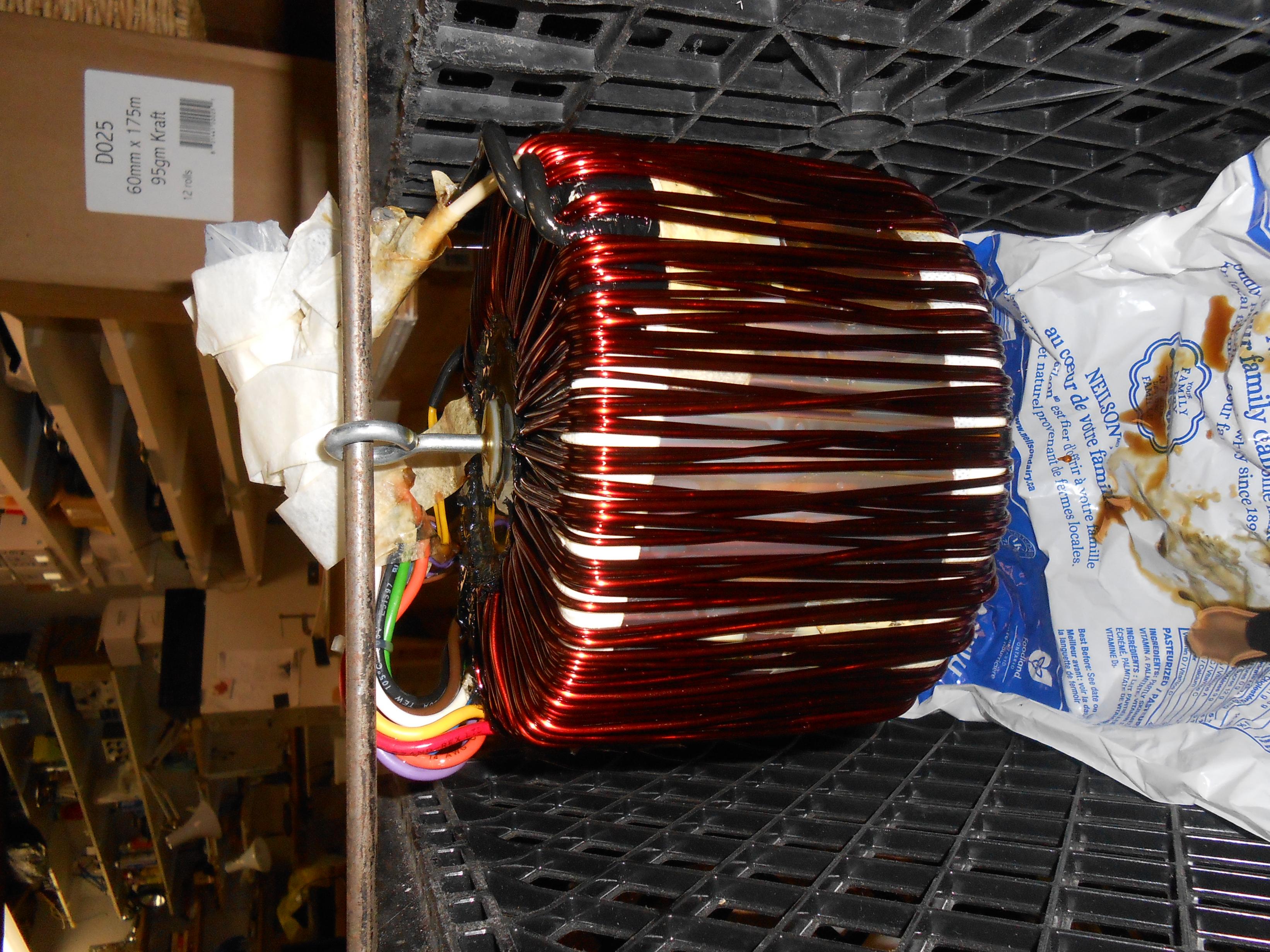

Pictured is the toroid after the first dip. It soaked for 20 hours, After removing, it dripped for about 8 hours. I suspect that internal cavities filled and then drained. I will keep repeating this process until I am convinced that it is a solid block of varnish.

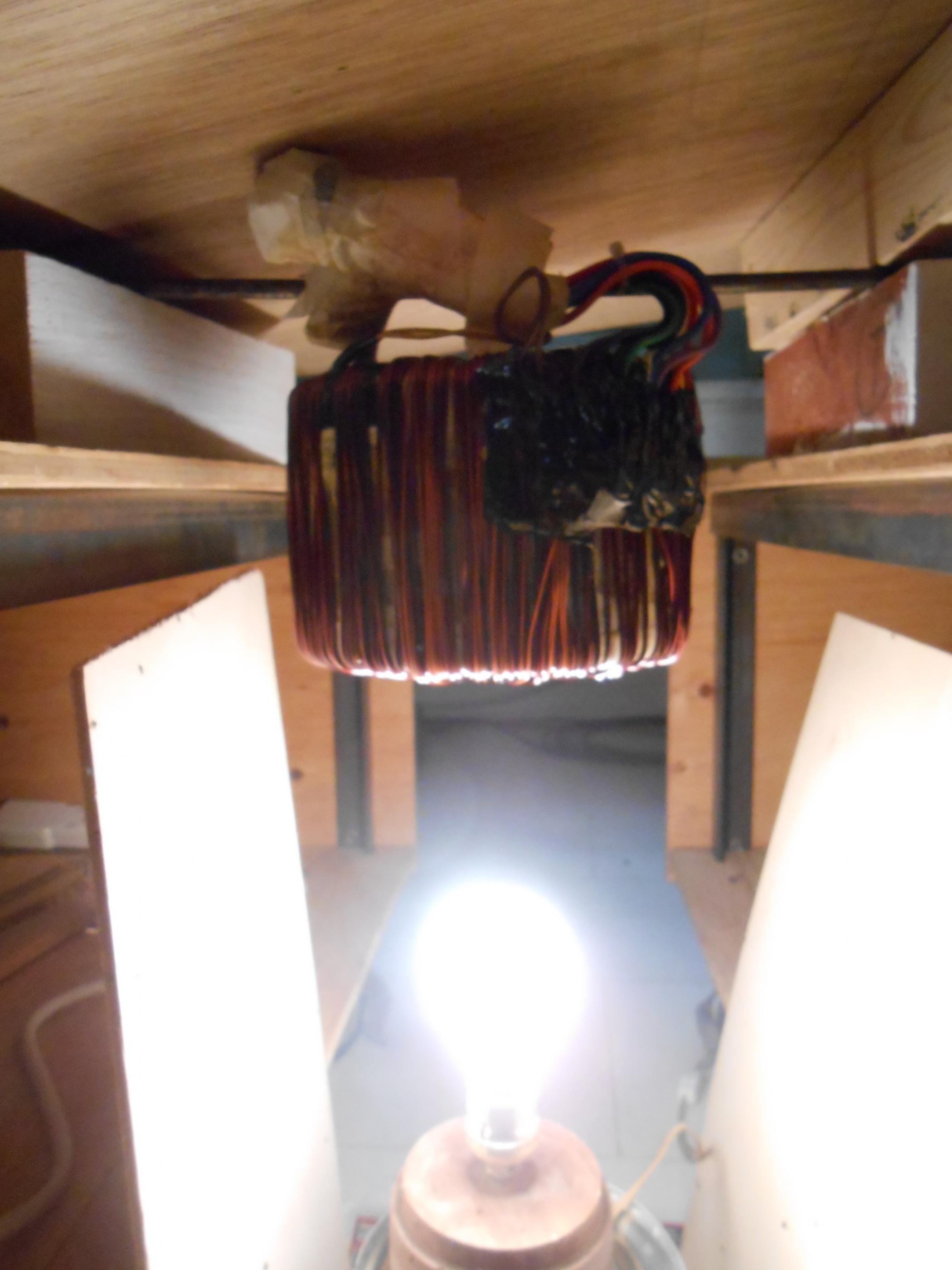

While watching the paint dry, I have googled a lot about transformer varnishing. My toroid actually dripped for 24 hours, although the outside was fairly dry in 4 hours. Elsewhere, someone mentioned that the inside would remain a 'gooey mess' and lead to trouble down the road. If the varnish is 'air dry', it needs air to dry. I believe, because of the dripping, there are obviously air pockets again.
It was mentioned here that the first dip is the most important, so I am going to wait 5 more days before dipping a second time.
BTW djk, what do you use your over for? I have my tranny hanging over a 100 Watt bulb, I figured it can't hurt?
...My toroid actually dripped for 24 hours, although the outside was fairly dry in 4 hours. Elsewhere, someone mentioned that the inside would remain a 'gooey mess' and lead to trouble down the road. If the varnish is 'air dry', it needs air to dry. I believe, because of the dripping, there are obviously air pockets...
Yeah, that's why I wrote previously that varnish was not a practical solution and recommended solvent-less epoxy.
I don't mention this just to rub it in, but because I think it's still the best solution.
Let the transformer drip and wait 'til it's dry.
Buy low viscosity solvent-less epoxy with a cure temperature that's within the temperature tolerance of your transformer, say <100 C.
Warm the transformer to less than 100 C but more than room temperature.
Place in the mixed epoxy.
The warm transformer will help the epoxy to flow into the air spaces and then help to cure it so the inside will be jellied before the outside.
Pull it out once the epoxy starts to thicken.
Alternatively you could make a mould for the epoxy and just let the whole lump set.
