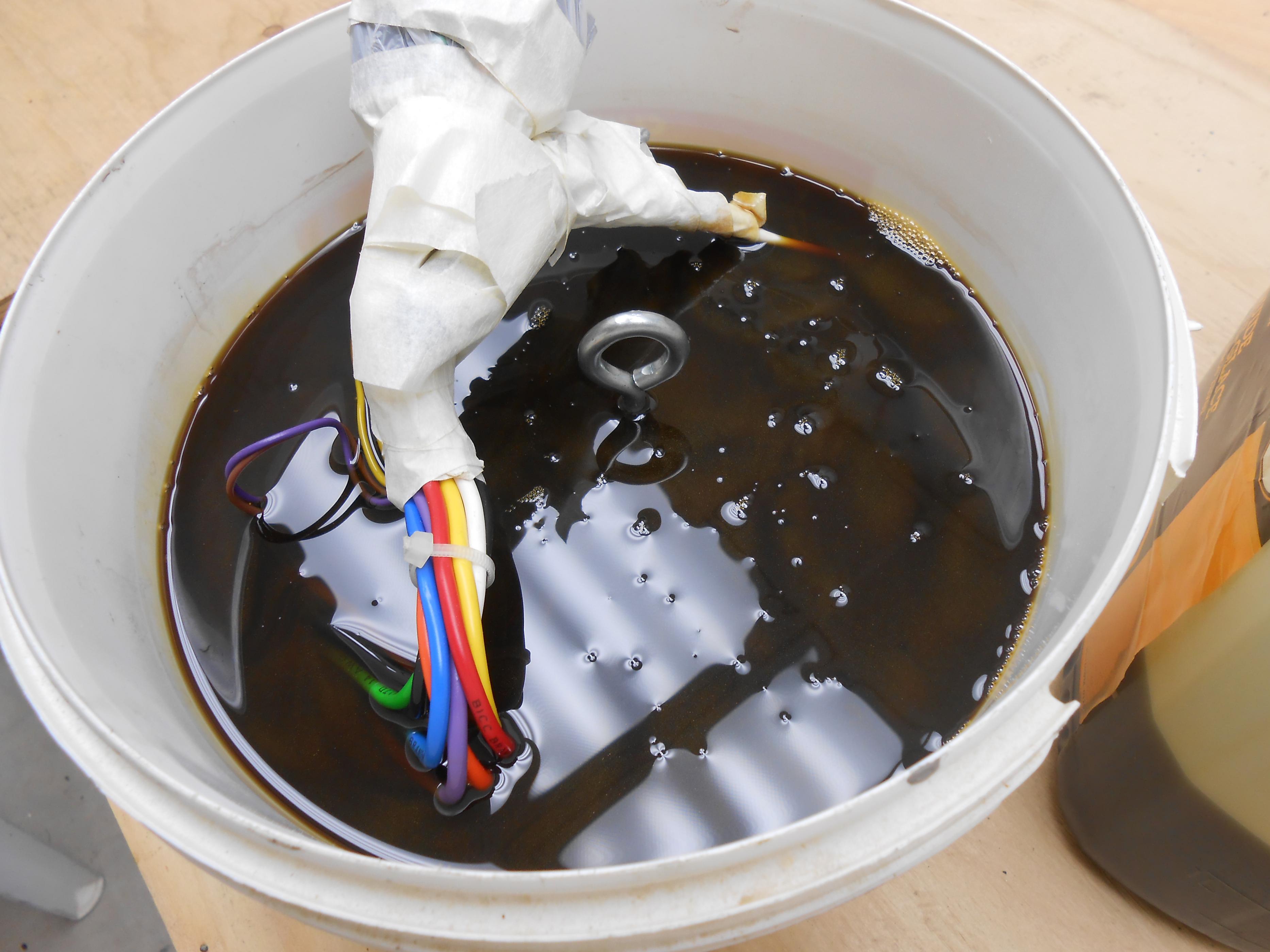

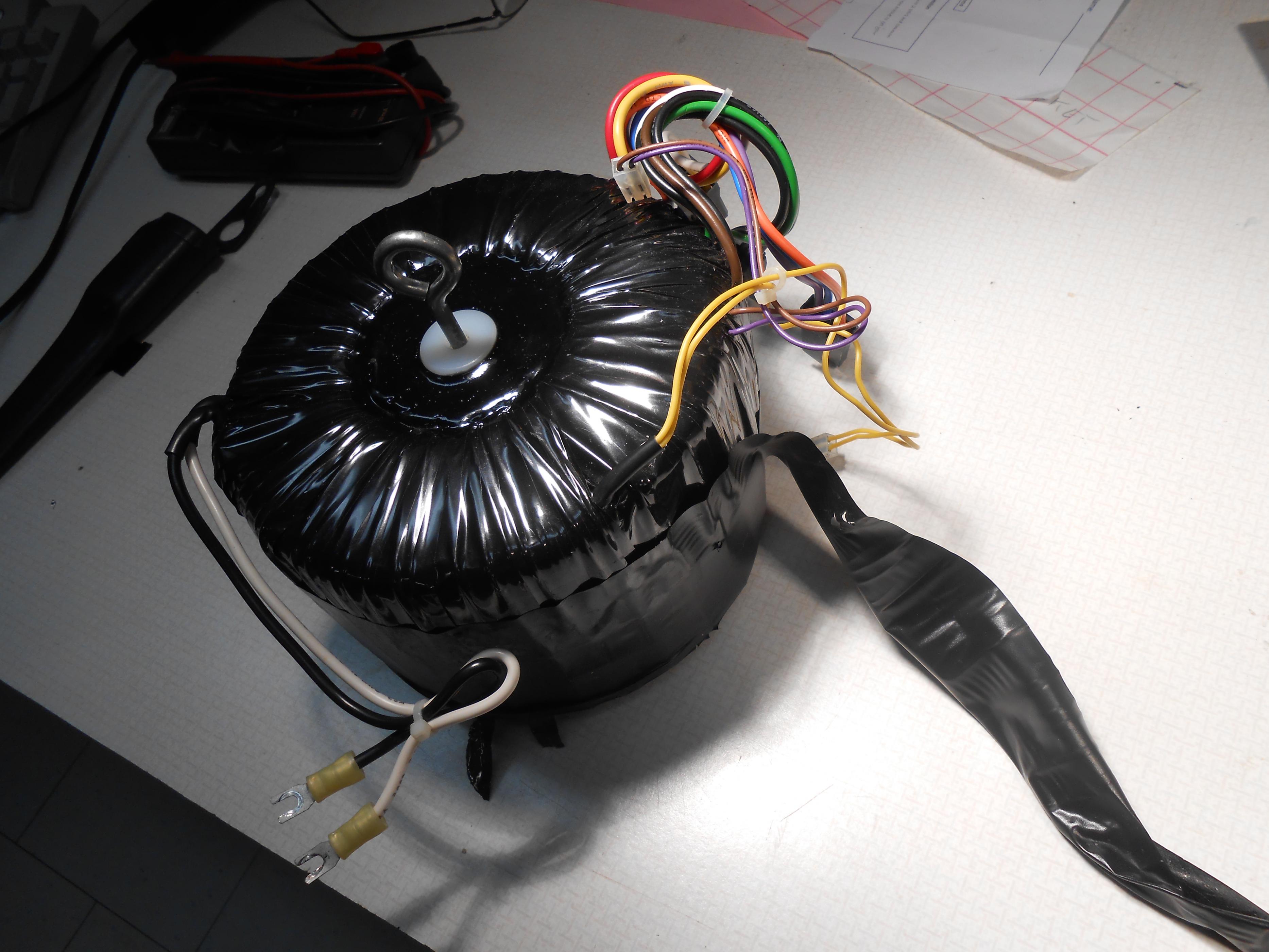

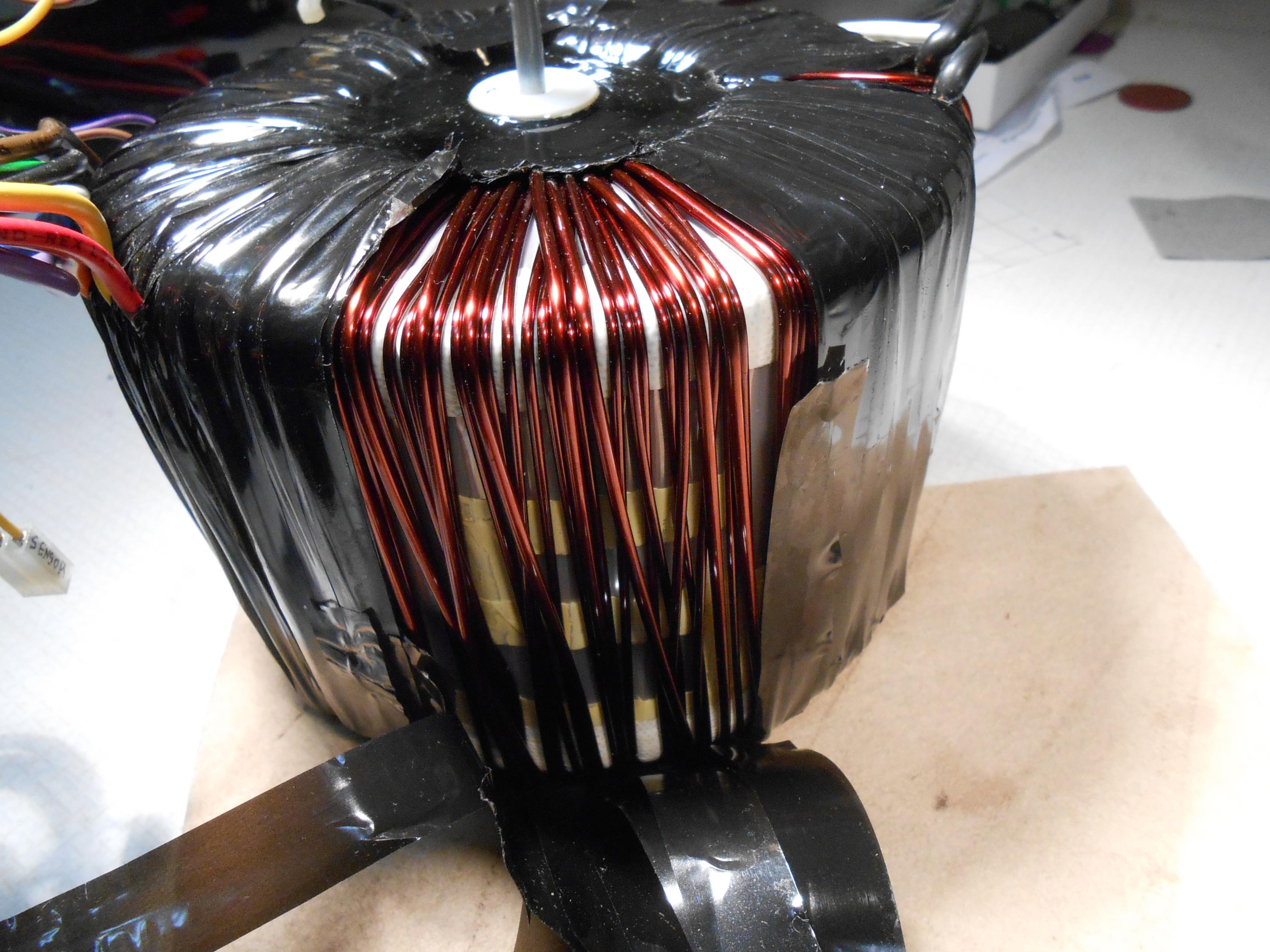

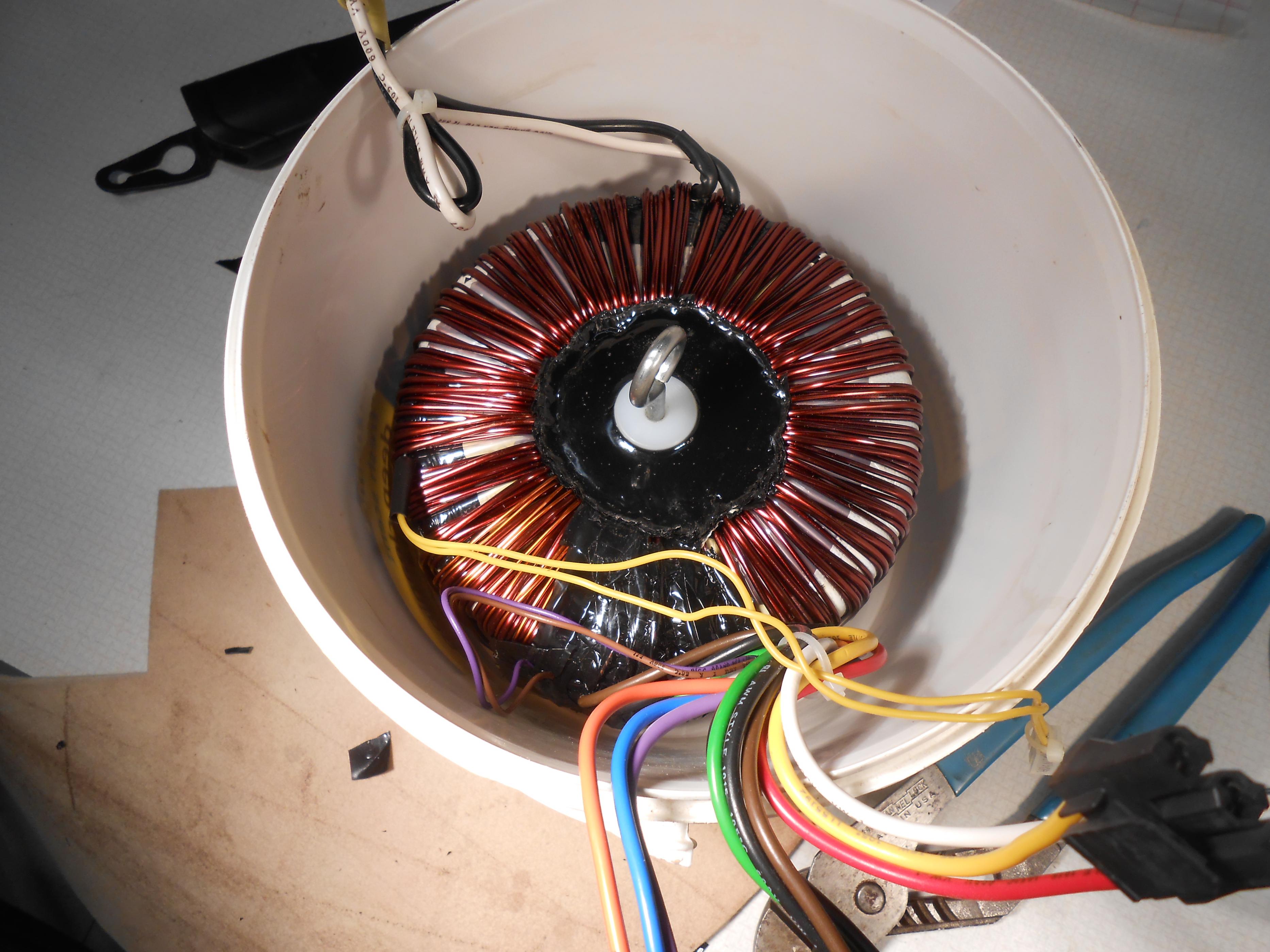

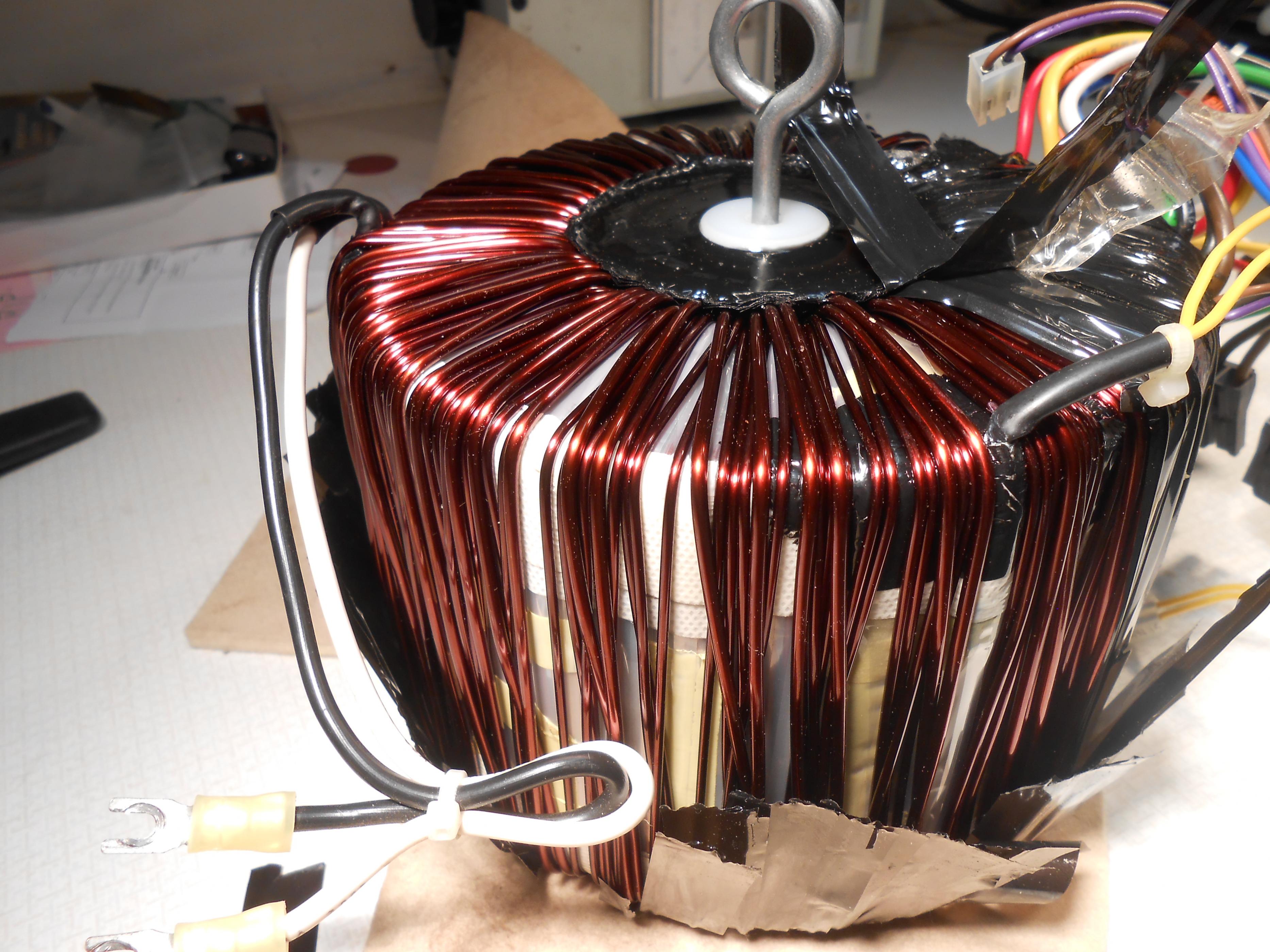

Hi Folks, just an update;
Thanks Duke and everyone. To be honest, I have not tested the diodes in the Crest power supply. Both channels produced a clean sine at well over 1000 Watts each, my uneducated opinion is that power supply is OK.
I removed the transformer from the amp, attached a line cord and..... same noise.
The toroid has an out wrapping of steel sheet, which just slips off, same buzz with or without.
As I started peeling the outer layers of plastic film, I could not help thinking this is the 'beginning of the end', particularly after seeing another layer of plastic below the outer windings. Not having experience with toroids, I was surprised to see the windings are simply wound, not dipped. I am puzzled that a transformer of this power rating would stay together, never mind noise free, without locking the windings together.
I am encouraged again; after submersing in electrical grade varnish, there was considerable bubbling, leading me to believe that the varnish penetrating internally. I am letting the toroid soak in the bucket (covered) overnight, as mentioned, the first dip is the most important. Tomorrow, I will remove it, allow it to air dry in a warm area for 24 hours. The second dip will not be soaked as long, I suspect a tendency to dissolve the first layer. I plan to repeat this seven times. Ridiculous, but I will report honestly about the noise reduction.
