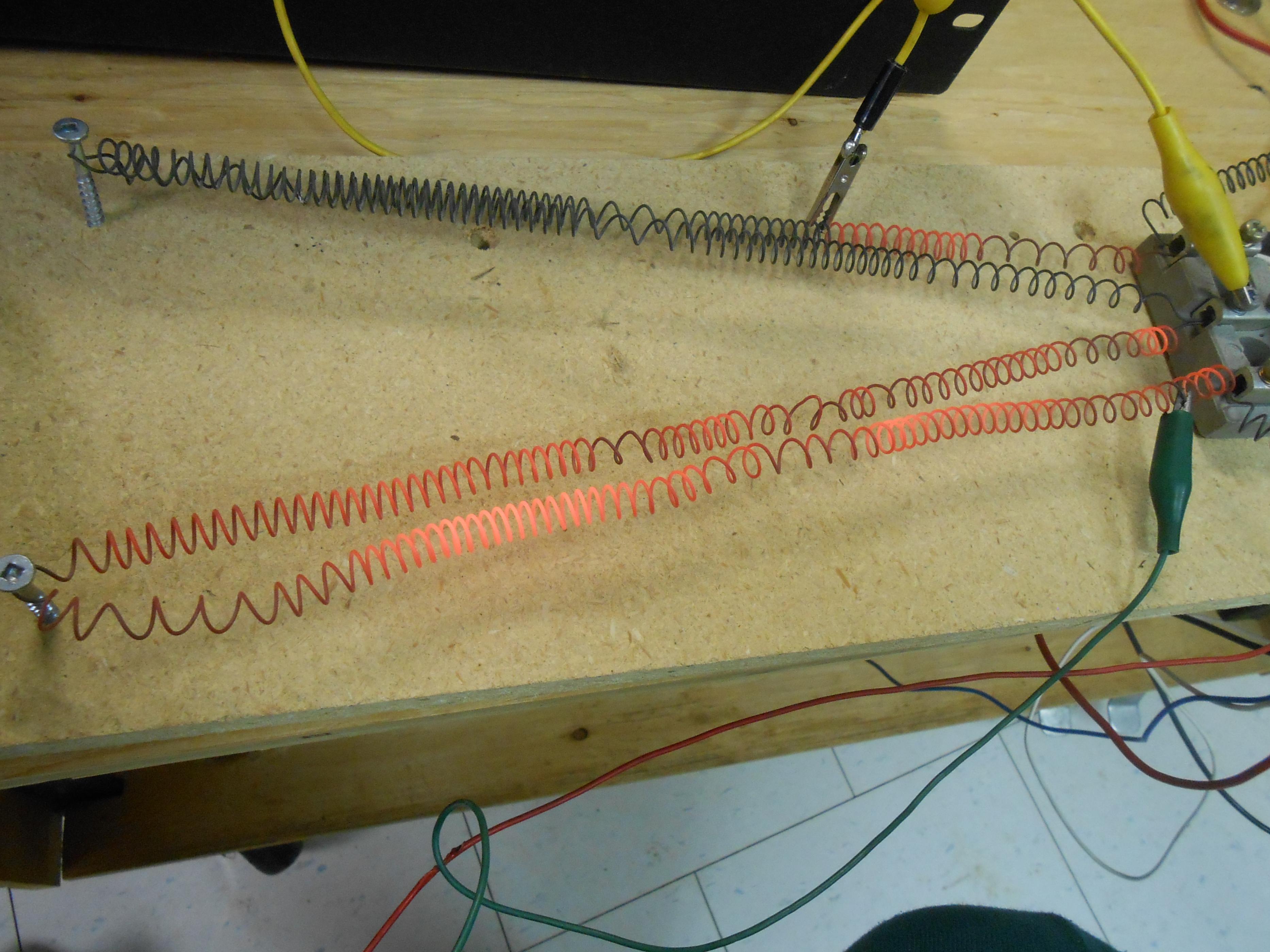

Pictured is my dummy load; Electric Clothes Dryer element. I thought I would test the amp before I went to all the trouble of treating the toroid.
1160 Watts per channel into 8 ohms. Nice!

Hi wg ski;
I was prepared for the resistance to change (increase) as the element got hot. I set the yellow alligator clip to bypass enough of the element to bring it to 7.4 ohms cold. Almost impossible to measure the resistance when it is red hot. I saw about 94 Volts measured by my fluke meter, before I saw clipping on the scope. It could do this immediately, not just when the element started to glow. Would you agree that this is a fair test?
I am starting to like this amp. At the risk of sounding like these audio fanatics that compare speaker cables, I think this amp has incredibly more punch than my Phase Linear 700's. I may get banned from the Phoenix Forum for saying that.
