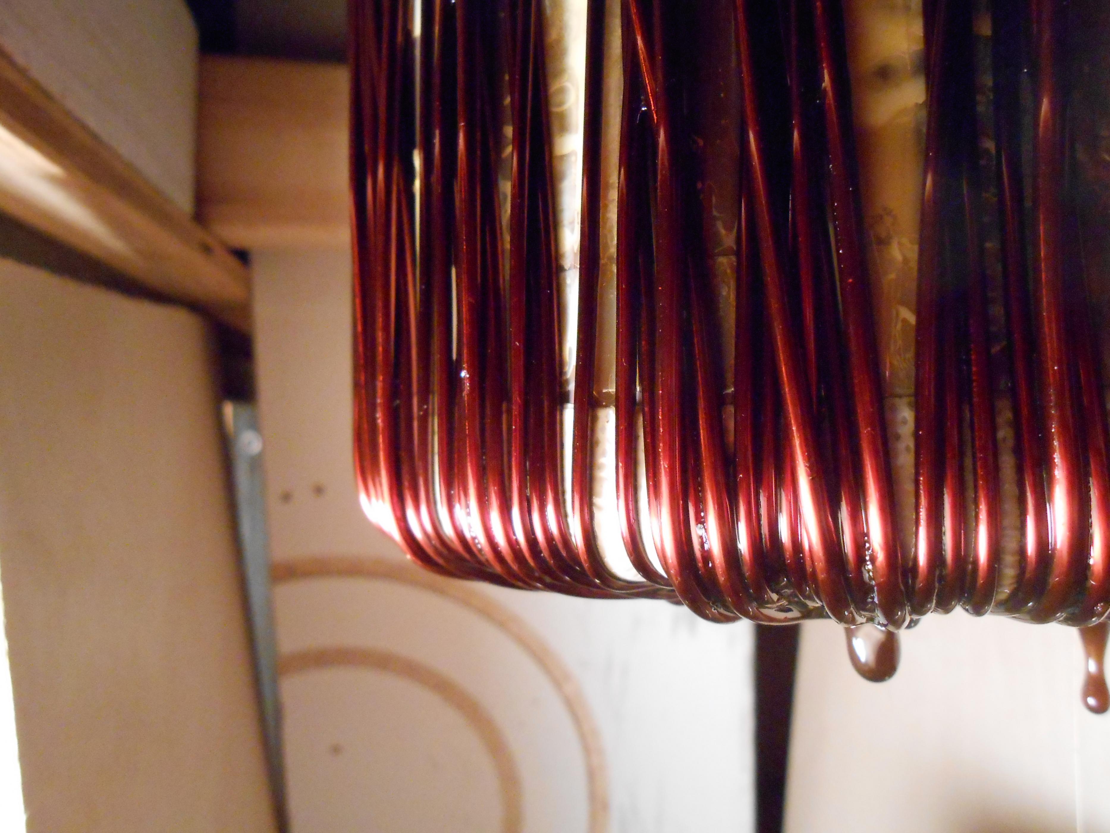

Thanks for your patience with me. I have more or less committed to the electrical grade varnish. Someone mentioned that once it stops smelling, the varnish has dried. One could argue that the varnish in the deeper crevices can't dry. At the same time, it has be doubted that varnish penetrated deeply.
It's been 4 days since the first dip. It dripped for 1 day, smelled for 2 days, but I will wait a full week from the first dip, to dip again. (I believe) this first layer is the only layer that has contact with the enamel wire, so I will be extra patient with the dry time.

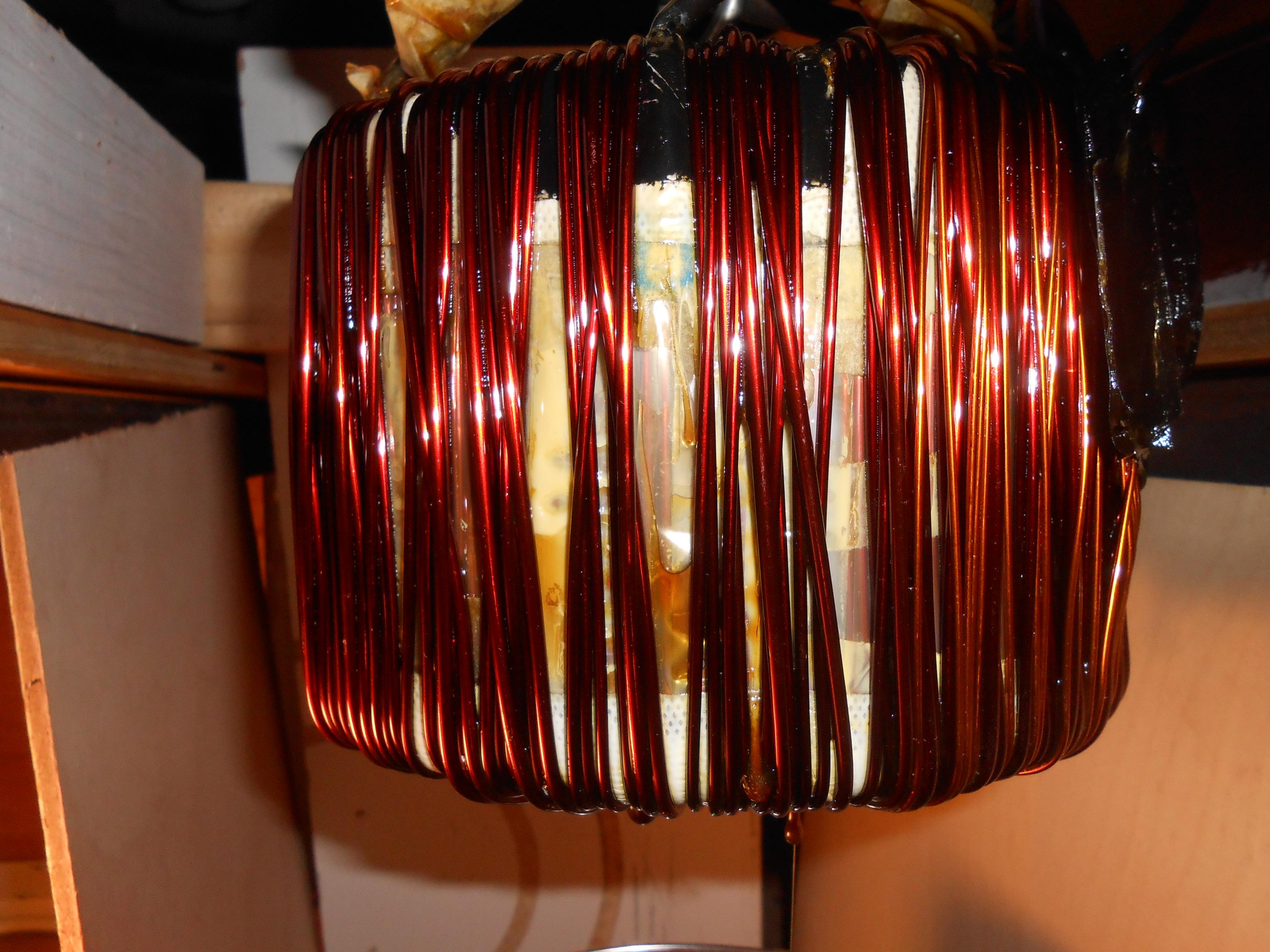

Just a minor update;
The toroid has been dipped 4 times now. I was told by the very experienced teck at the shop, that one Vacuum impregnation is equivalent to 7 dips at atmosphere. I understand that there are benefits to Vac that can not be duplicated regardless of how many dips at atmosphere.
Not wanting to look a gift horse in the mouth (or just forgot), I did not get more info on the Electrical varnish that I received. It is obvious at this point, that it dries (cures) at room temperature, and that it is solvent based. From the visual results, my guess is that I will be dipping this thing at least 10 times. At 4 dips, I'm seeing nice filets between the wires, but it is far from the solid lump of varnish that I was hoping for.
There was a concern expressed that the interior would remain a 'gooey mess'. There are still voids in this toroid; the last bubble was detected an hour after the last submersion. My argument is that, as opposed to a closed paint can, the vanish found its way in, so will the oxygen, eventually. I am using an electric heater to accelerate drying, but am not allowing temperatures to threaten the external wires and connectors.

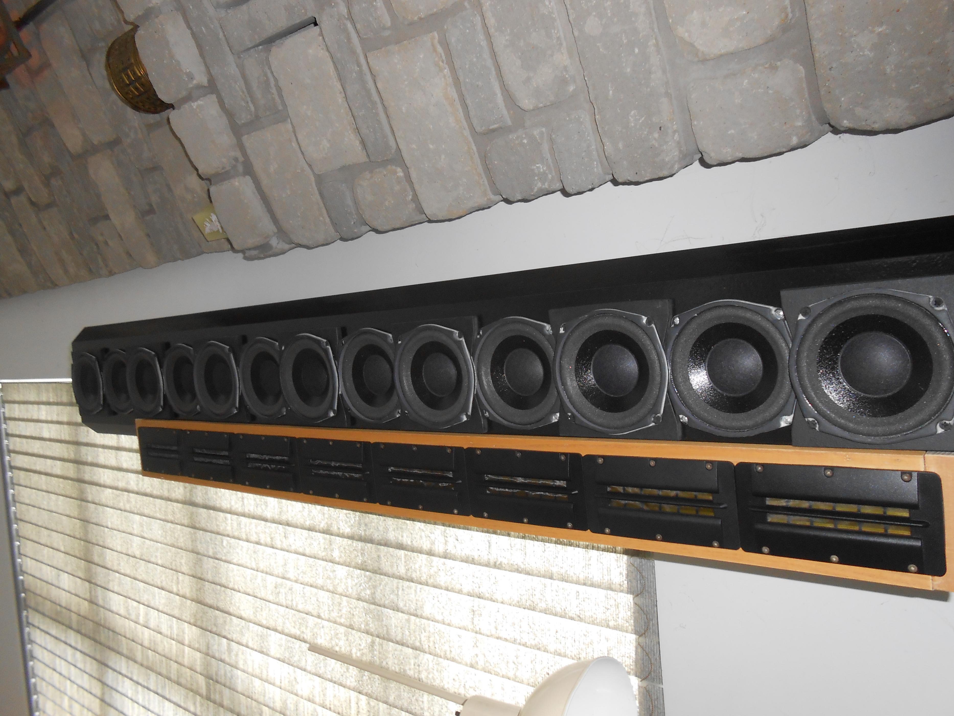

...to drive my bass cabinets, which are copies of JBL 4645c theatre subs with less expensive, less efficient RCF drivers
There's your problem. You need a pair of real JBL 2445😉
Should not be too hard since at least you are in North America.
I was very happy to find a pair, quite rare in Australia.
... more info on the Electrical varnish that I received. It is obvious at this point, that it dries (cures) at room temperature, and that it is solvent based.
There is a distinction here.
Some protective coats simply dry, the solvent just evaporates and if solvent is reapplied then they redissolve or soften.
Some materials just cure, solvent-free epoxy for instance.
Some materials do both, they have a solvent that dries and then they cure, solvent based enamel paint for instance.
Do you know the chemistry of your varnish?

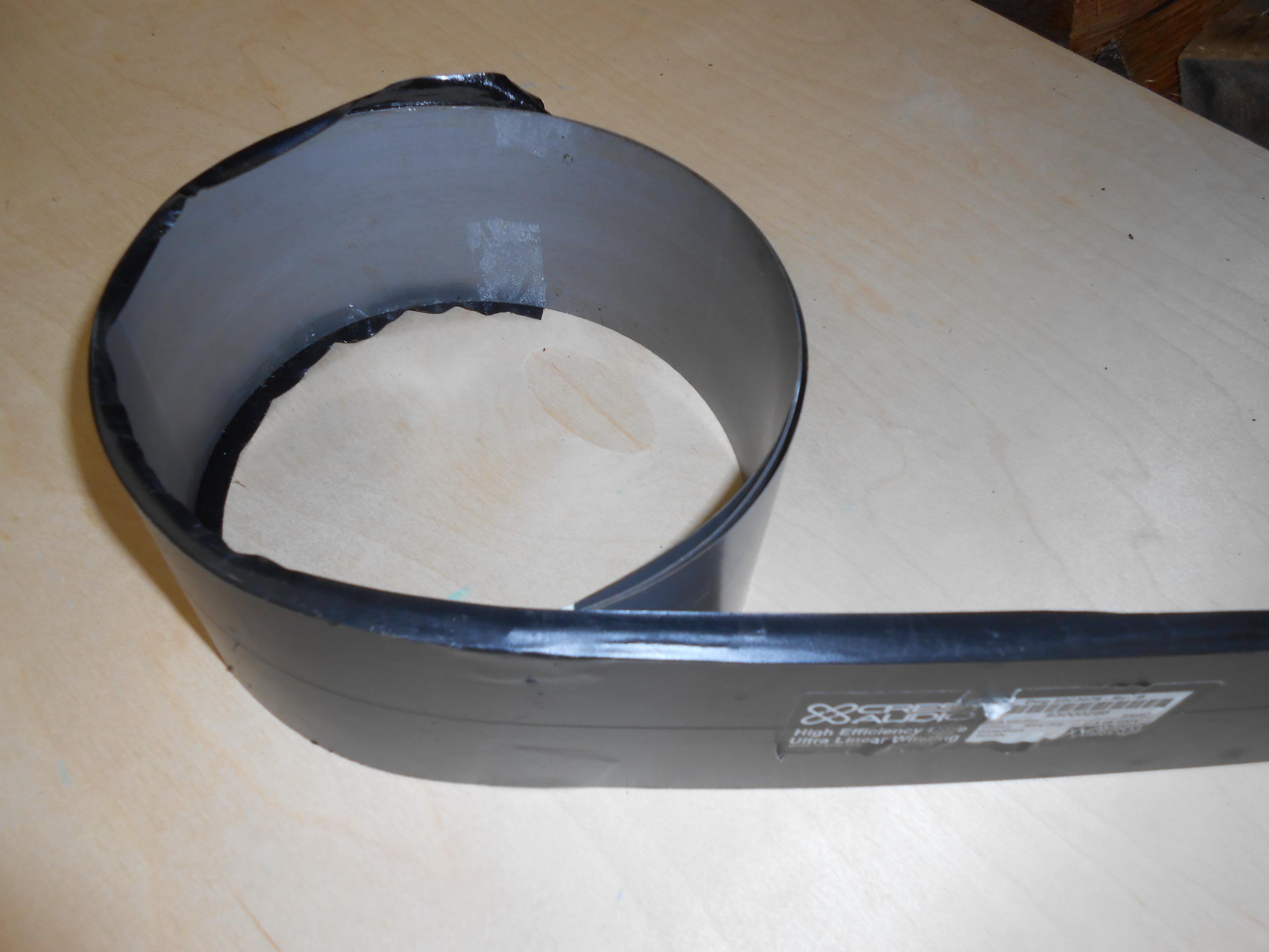

Another concern; The (mu-metal) outer shield was held in place with the same adhesive tape...
Real mu-metal? It's dammed expensive, maybe just steel?

To address your last points first; The outer (steel) strip is only a concern for me as far as re-installing it without risk of making electrical contact anywhere. The original method of self adhesive tape, was not sufficient. Certainly won't work now with trace levels of solvent still present. As far as "mu metal", I can't be sure, but there is (was) absolutely no hum issue in the speaker output. I envision wrapping the toroid in several (cotton) cloth bands and locking the toroid, cloth bands and together with...........well you know, more varnish.
BTW, when I bought the amp, the adhesive tape had loosened, as mentioned and the band had expanded very slightly. I want an installation method that will prevent this, but would prefer not to permanently attach it to the windings...still mulling this over.

The outer guass band does not contact any other conductive surface.
The secondary insulation prevents contact in that direction. You just need to add outer insulation to prevent any outside electrical contact.
The strip should make electrical contact to itself as you wrap it around. The flux runs around the transformer. It's that ability to take escaping flux around that attenuates flux peaks that could affect nearby equipment.
The wet varnish should be a fairly good insulator.

Hi Andrew
Thanks again. I may be using the heat/cool effect, to some extent, because the toroid has usually hung in front of my portable heater for a day before subsequent dips in the cooler varnish.
Observations after dip 5; less bubbling from the interior, secondly; I will have to eventually shorten the submersion times because it appears that one hour in fresh varnish seems to dissolve previous layer(s)
For now, I am encouraged by a reduced bubbling the last dip. Do you have any suggestions regarding (readily available) material suitable for secondary insulation?
Thanks, Peter
Thanks, Peter
