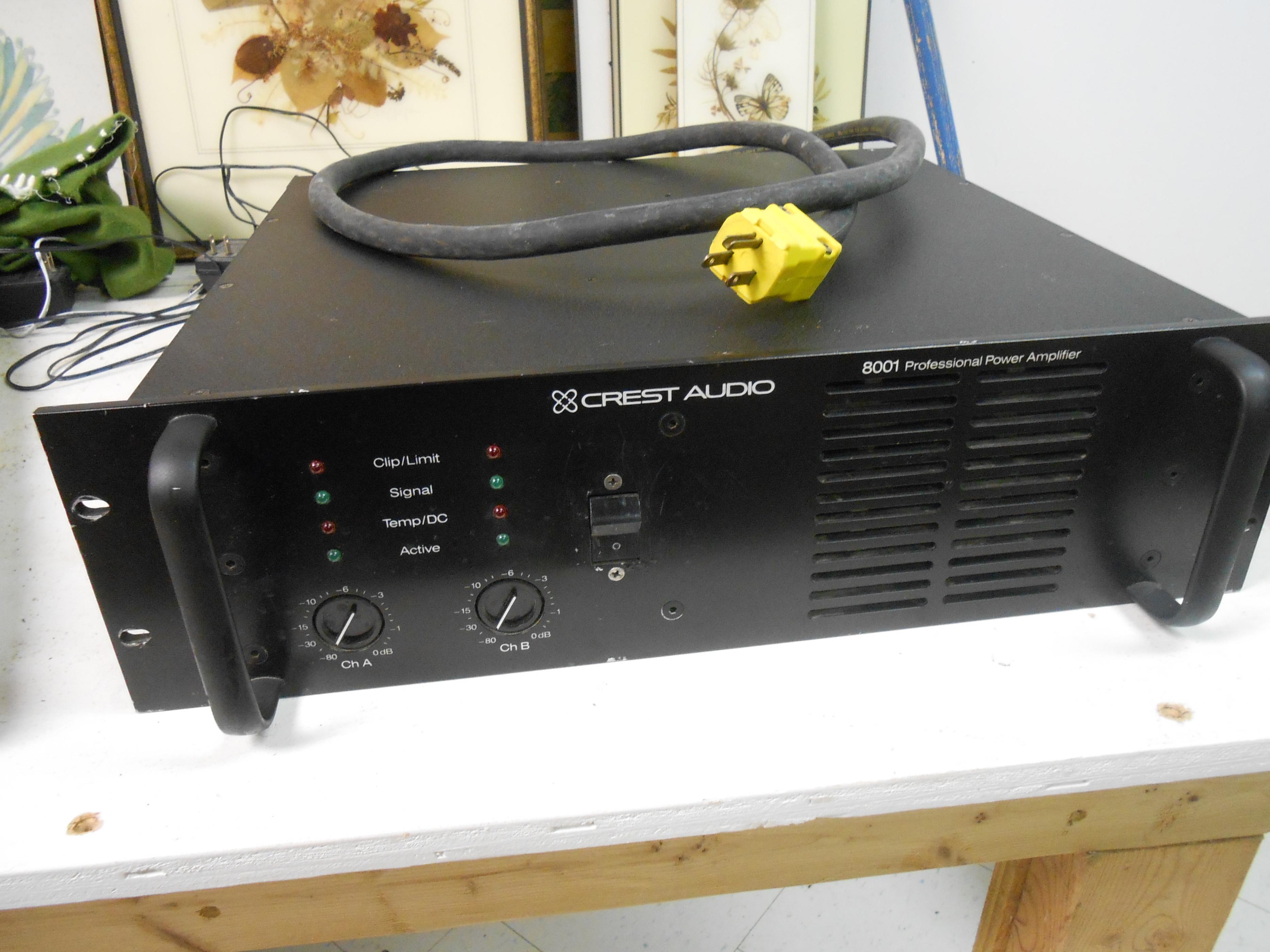

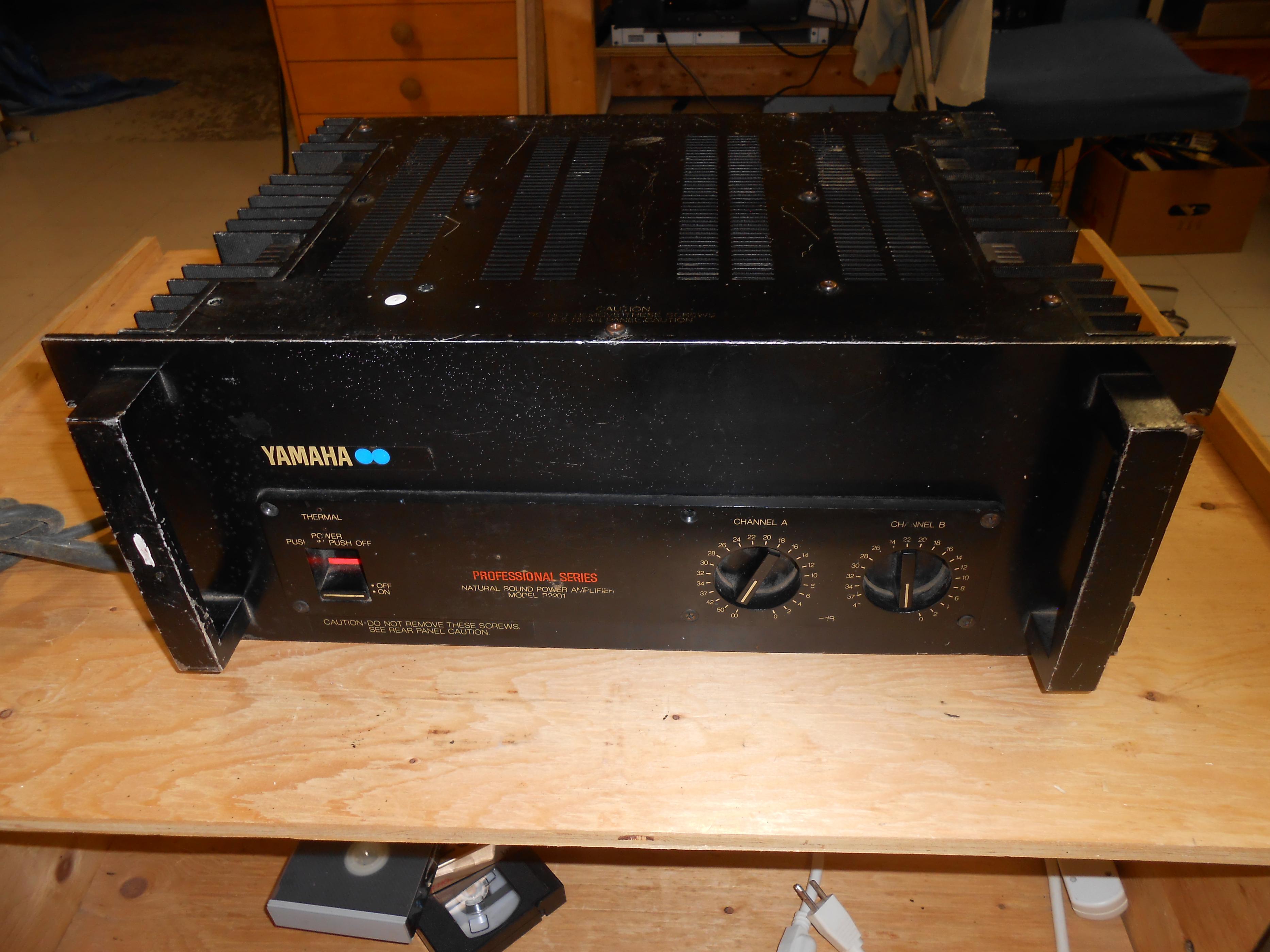

Here's what I picked up on the weekend; Yamaha P2201 and a Crest 8001, both purchased 'not working'.
I may have the classiest doorstops, north of Toronto!
Re; the Yamaha, seller claimed one channel may work.. Power switched removed, not bypassed, one side has no output transistors..smells like burned resistors and cigarettes, but I own a P2200 (with meters) and think that it is worth restoring.
The Crest, well I'm a sucker for punishment and couldn't resist. Maybe I will learn something.

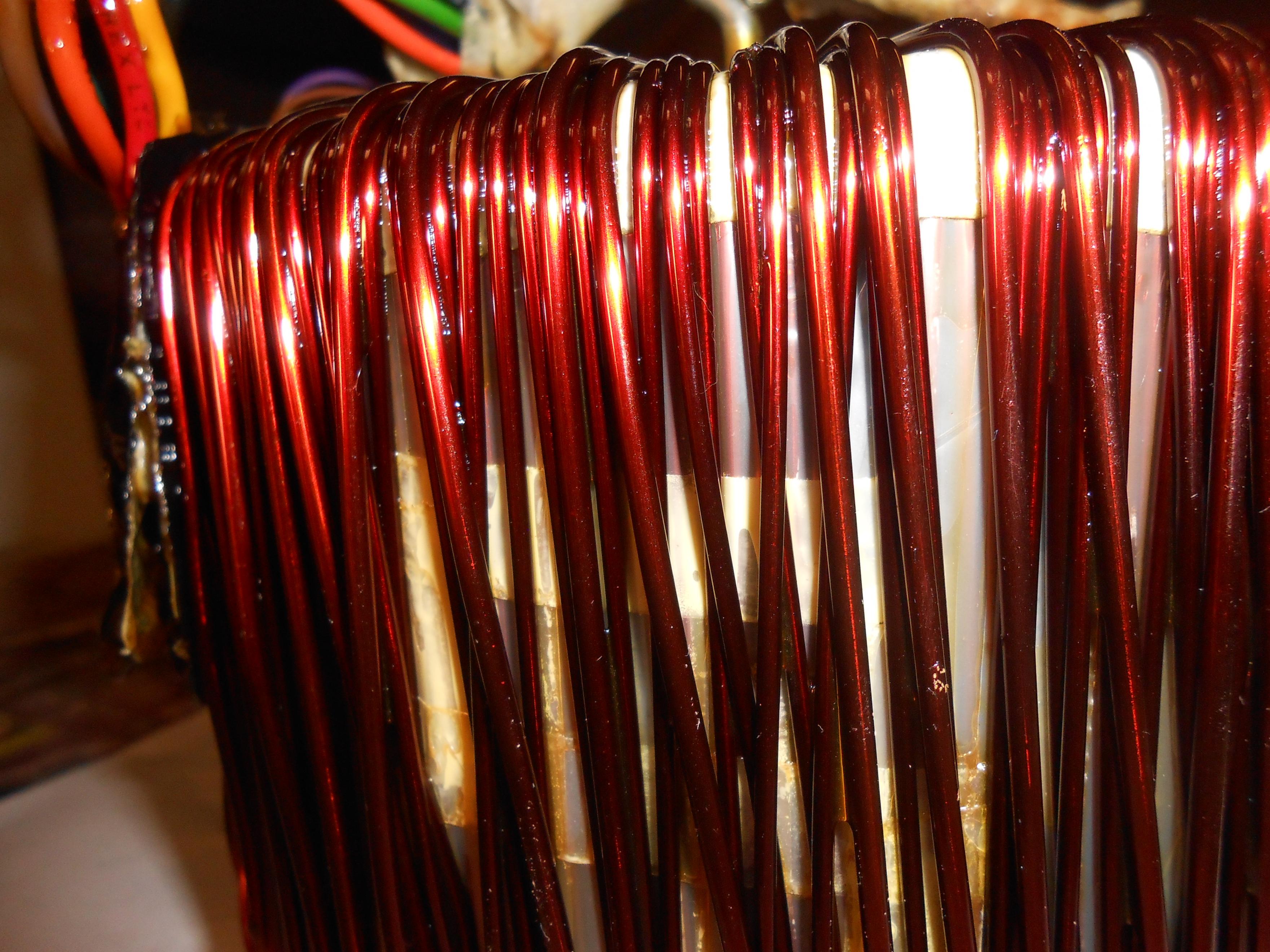

Attached are results after dip 7. I see small filets developing between the wires, but far from what I feel is sufficient. I am now suspecting that even shorter submersion times are required to prevent removal of previous layers. Dip 8 will be timed to 5 minutes.
I am trying to achieve a 'potted' effect with a varnish, rather than an epoxy, yes I know that it was suggested. However, I believe I can eat this elephant, one fork at a time.

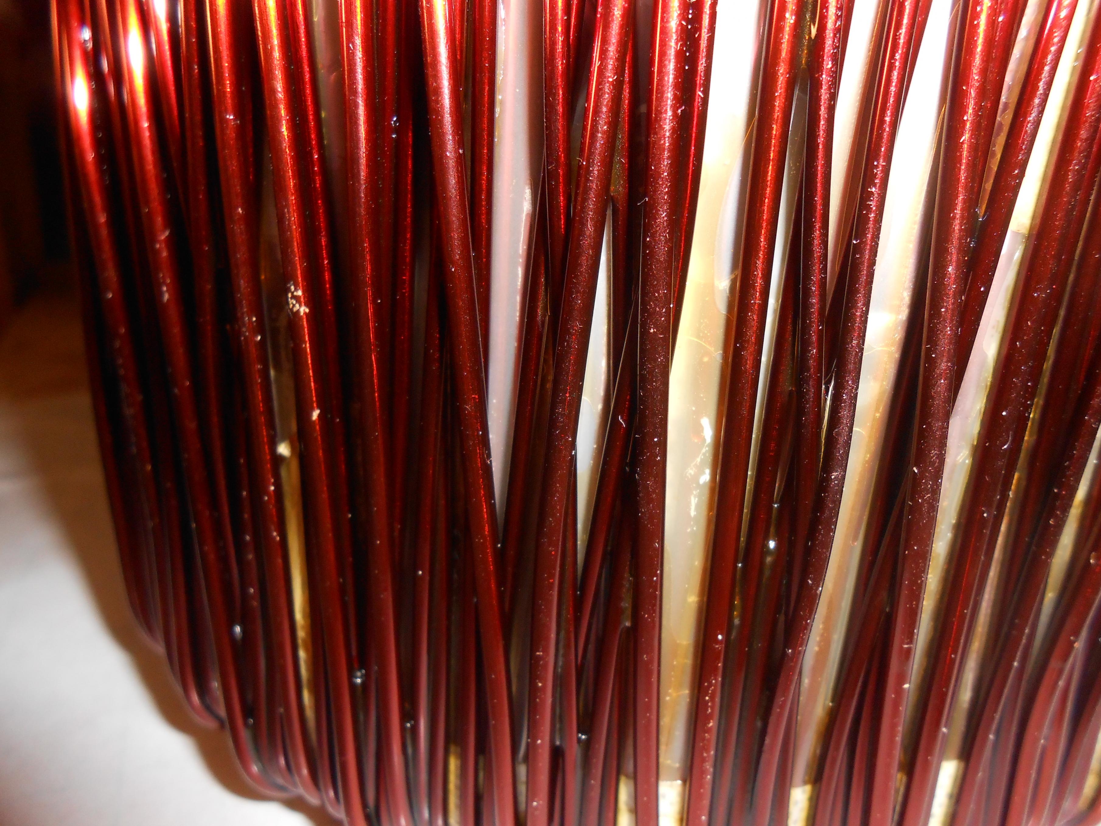

One more reason to drag out the "moment of truth"; Dip 8 was limited to 5 minutes and I see a noticeable increase in varnish thickness on the wires. It seems that my extended dip times were remove much of the previous deposits. In any case, I am glad that the first dip was 24 hours. I'm also glad I have a 'day job'. In an attempt to be scientific, I tried measuring the 'before' noise level but my Radio Shack SPL meter would not yield any meaningful readings. The results of all this effort will be judged subjectively, so I don't want to blur my comparisons with an intermediate test.

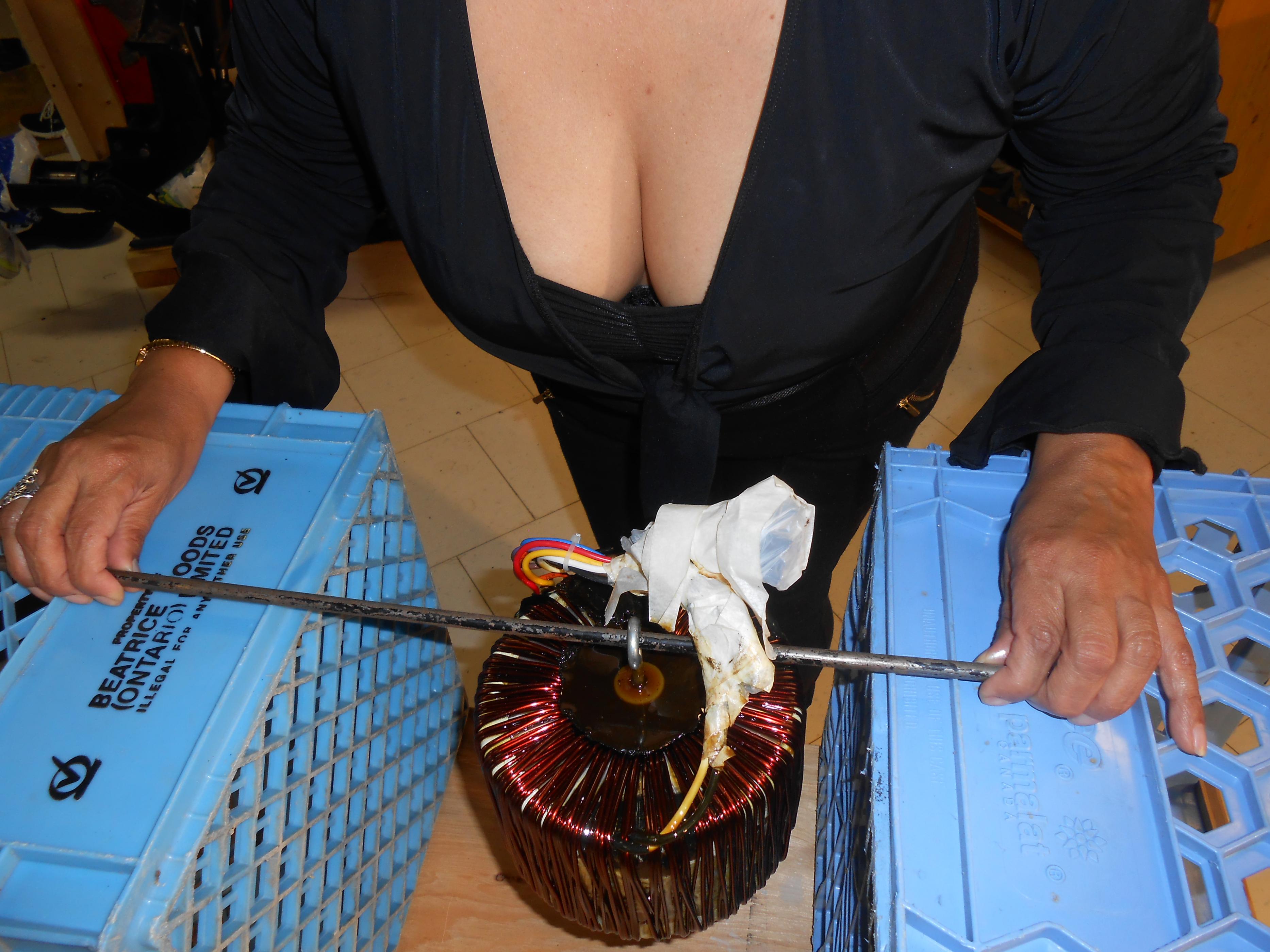

The photo with your wife is not only very cute but also a useful illustration of the size and proportions of the transformer too.
Makes it clear why it would be difficult to remove the core.
Despite the tranny's size it is still small for the 5000 W in the amp's specification sheet.
Increases the suspicion that it's run close to, or at saturation.

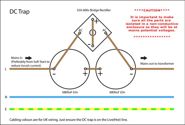

Nearly.
You don't need 63V capacitors.
The Diode bridge limits the maximum overload voltage to 2times Vf and that rarely, if ever, exceeds 3Vpk.
A 6V capacitor would do.
10V 4700uF caps are small and cheap and you can build a bank of 8 or 10 for little space and little money
8 will give ~9400uF and 10 will give ~11750 uF
This is quite a bit more than the 3400uF that your two 6m8F can give. (the impedance, Xc, of 3400uF @ 50Hz is 0.94ohms)
I do like the note on the left referring to the effect of the soft start current limiter.
The starting of the transformer is one of the overload conditions that could take the diodes into conduction.
Normally, we do not want the diodes to conduct.
No.
This is a DC block to help reduce transformer saturation, or near saturation, due to unequal waveform that makes the transformer draw excessive primary current and usually becoming noisy (a growl).
And the DC block does not need to be in the Hot/Live line.
It works just as well in the Neutral Line and even works between the two windings of a series connected dual primary.
The slight advantage of locating the DC block in the Neutral is that it operates at near Neutral voltage. The voltage difference between the Chassis and the DC block is much lower (when the mains socket outlet is wired correctly).
