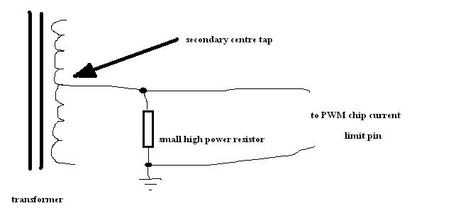

i have desided to use the UC2528AN chip instead of the more common SG3525 because it got 2A peak output current and a current limit option
i'm thinkin of a way to limit the output current in case of short circuit , do u think the next circuit will work good? (sorry for a bad pic , made it with paint 🙂)
soon the full schematic 😀
This only senses the difference in current consumption between rails
Other ideas :
- A current transformer on the primary or secondary side [this is tricky and requires an additional small ferrite core but it's very elegant and precise]
- Measure and amplify the voltage drop on some thick circuit track or wire that carries all the primary current
- Put an LC filter on the primary side [for ripple filtering] or in the secondary side [for output regulation] and integrate the instantaneous voltage difference across the inductor to get the instantaneous current flowing through it [This is very tricky but works. I succesfully use this method to sense the current through the output inductor in a 230V to 14.4V 72A SMPS prototype intended for car audio exhibitions]
- Measure the voltage difference between drains and sources of the set of MOSFETs that are conducting [it's complex to implement since the measuremt should be disabled before turning off each set of MOSFETs and enabled after they are again fully turned on
