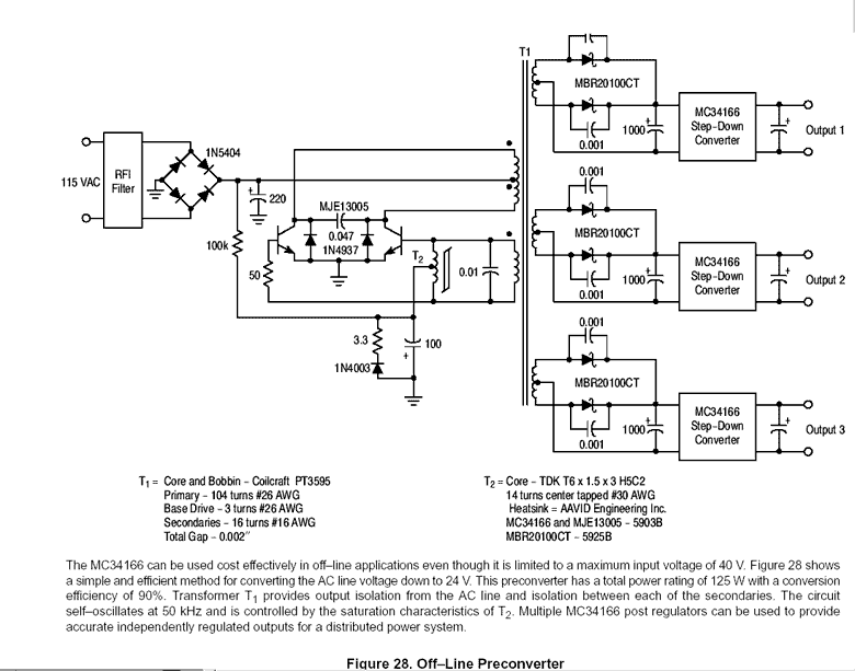

A mains powered SMPS is alot difference to a comparitively simple 12v DC one. I wouldn't reccommend it to anyone that hasn't played with 12v beforehand.

and Matt, I go back to my point of months ago -- anyone who wants to learn will make it very easy by getting the Velleman PWM controller kit -- because it can be repurposed to a MOSFET gate driver using the SG3525 -- and you can twiddle the frequency and compensation scheme, soft-start etc to your heart's content.
with regard to a "mains" or off-line switcher -- the front-end operates at a multiple of the mains voltage -- which gets into the realm of electrical potentials most dangerous for human accidents -- and things really can fly apart --
attached is a GIF of the off-line switcher using the On-Semi MC34166 chip and MJE13005 transistors -- with the transformer information clearly laid out -- the MC34166 is a 3 amp 40V max switcher -- the idea is to use the MJE13005s as a self-starting multivibrator, then use the controller chips on the secondaries in their various configurations. On-Semi has taken the time to provide PCB patterns for the stepdown converters on the product PDF:
http://www.onsemi.com/pub/Collateral/MC34166-D.PDF
