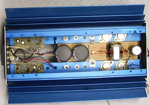

ETD 39.
Robin, I have done a lot with the ETD series of cores. First make sure you have an UNGAPPED core! Hold the two halves together and look at a light source through the joint of the middle legs. You should not see any light. There are also different ferrites available in the same core shape. The H7C ferrite is the one you want for smps.
Eight turns center tapped for the primary and 12 or thirteen turns center tapped for the secondary. For the primary, I would use the equivalent of #10 wire and for the secondary, #12. There should be plenty of window space for the wire on the bobbin. I would recommend using a Litz type wire or at least several smaller wires in parallel for the windings.
Aside to Eva, A woman who speaks smps, ...... I Love you:D Best regards, Steve
