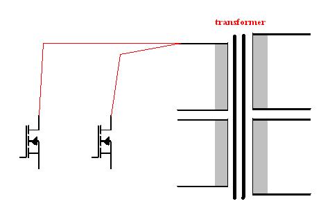

i was thinking of a different way connecting the primary coil of the transformer to the fets :
lets say the primary winding consists of 4 single wires and i'm gonna use 2 pairs of fets per primary .What if i will connect 2 wires of the winding to one fet and the other 2 wires to the other fet without connecting the whole wires of the primary all together is it a bad idea ?
